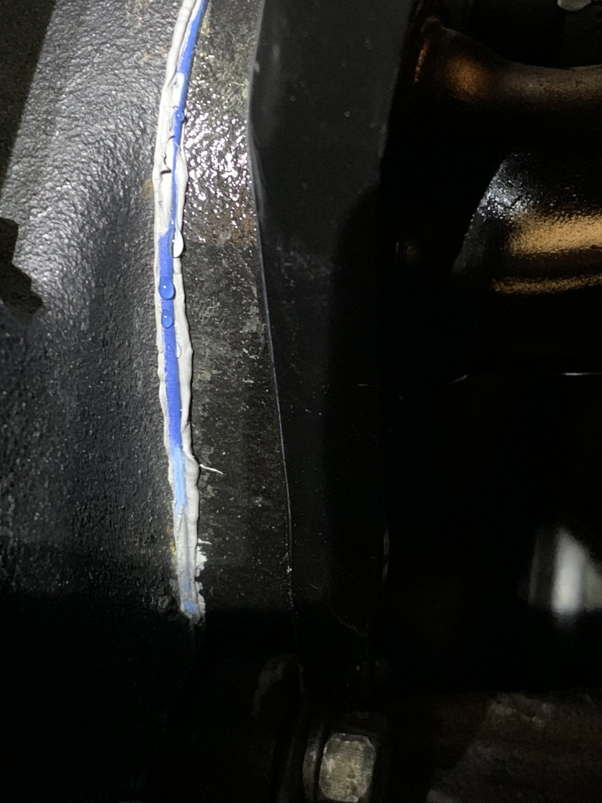

    Is there something special about the thermostats in these FEs that I’m missing?

  3. Pontmerc
    Joined: Jul 13, 2013
    Posts: 446
    Pontmerc
    from Finland
    Its real easy to drop when installing and bend the expansion tank flange when tightening bolts and thermostat wedged between.

  4. Jeff Norwell
    Joined: Aug 20, 2003
    Posts: 15,271
    Jeff Norwell
    MODERATOR
    They tend to "slip" upon installation.... I use the rubber band trick.
    When they slip..... they jump out of place and will never seal.... I also use Indian Gasket material. that very sticky stuff that old school guys use.

  5. Oneball
    Joined: Jul 30, 2023
    Posts: 1,629
    Oneball
    I used a sealant to hold it in place both times and when I took it out the thermostat was still in the right place. I’ve flattened the flange on a glass sheet with some sandpaper and will try again.
    It didn’t leak before when I’d accidentally put the thermostat in back to front!
    What’s the rubber band trick?

  8. Oneball
    Posts: 1,629
    Oneball
    Thanks both.

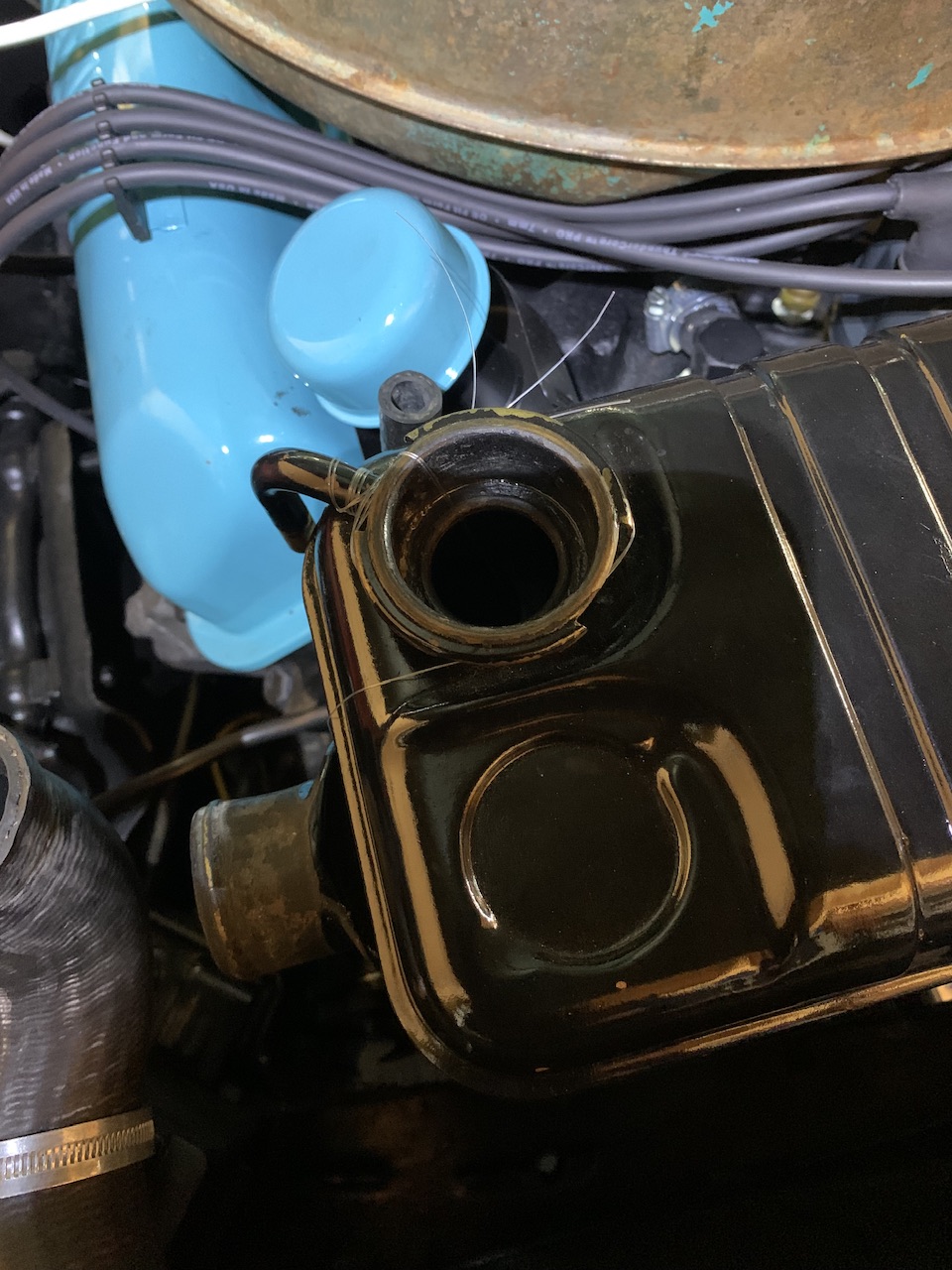

    I’ve flattened the surface on a flat glass. Knocked out some of the ridge on the thermostat as it was slightly proud when installed. I’ve made a gasket out of Flexoid gasket sheet which is still made in England and used Loctite 518, which is basically a modern shellac and sticks like***** to a shovel.
    Bit difficult to use an elastic band due to the baffled tank but did it with some fishing line.
    All back together, will fill it with coolant tomorrow and see

  11. bobss396
    Joined: Aug 27, 2008
    Posts: 18,719
    bobss396
    Oh yeah, the surge tank... puts another whammy on things... :eek:

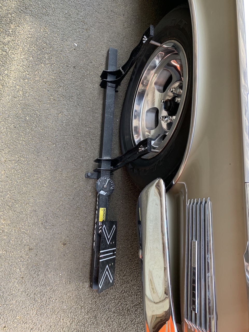

    Got the tracking set up
    Found 4 of the body mounts were loose which may explain what I thought was the harsh ride over ridges, was all ready for an evening test drive and it’s******** it down now :(

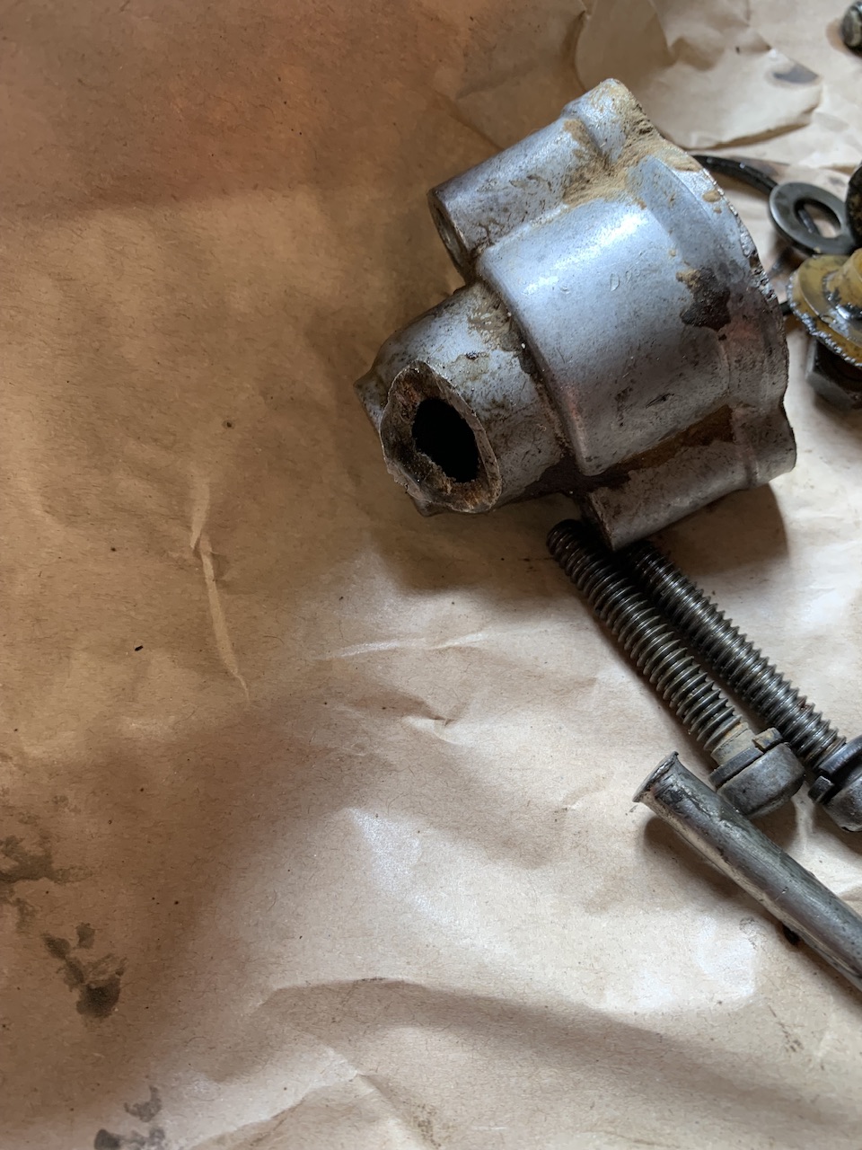

    Posts: 1,629
    Oneball

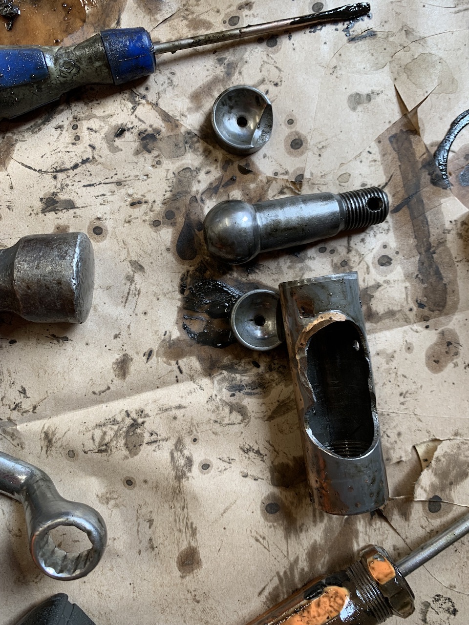

    There’s bound to be something that breaks soon! Power steering control valve seems to be the source of the play in the steering it’s so loose it’s almost like the two springs aren’t inside, I’ve ordered a rebuild kit. If it arrives and I get it fixed I might use it at the weekend. I’m racing a mate’s car so don’t need to tow anything but it’s a 4 hour or so drive to get there, anything might happen!
    bobss396 likes this.

    You do realise that control valve play should be checked engine running?
  19. Oneball
    Posts: 1,629
    Oneball
    Yes, it’s the same sort of setup as Corvettes, thinking about it there’s probably that much moment because the ball/sockets are worn out, I’ll go have another look to confirm
  20. Oneball
    Posts: 1,629
    Oneball
    The ball isnt too bad but the sleeve is completely screwed up, hopefully a rebuild will sort it.
    End cap is chewed up too so had to order one of those from USA.
  21. bobss396

  23. Oneball
    Posts: 1,629
    Oneball

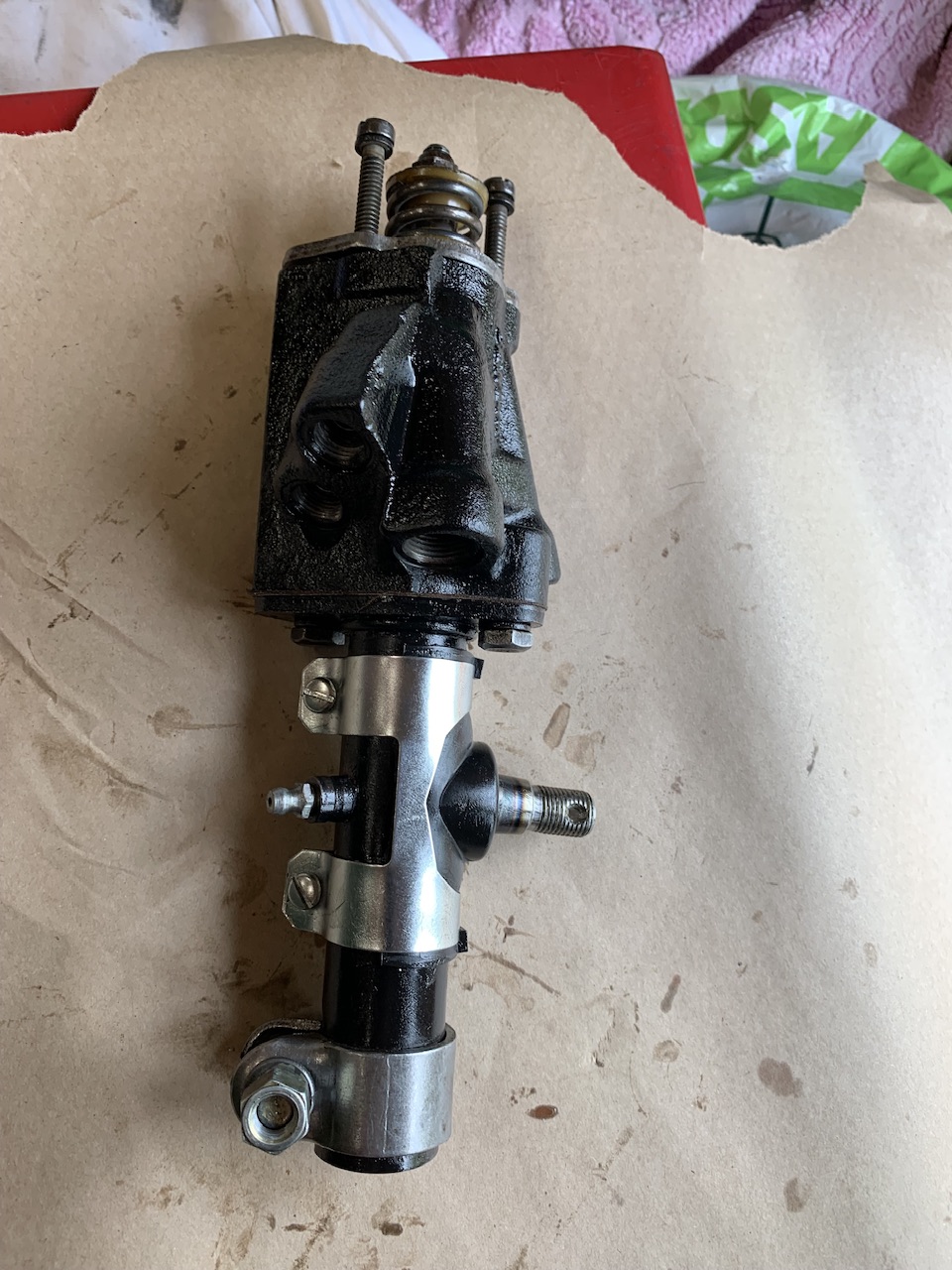

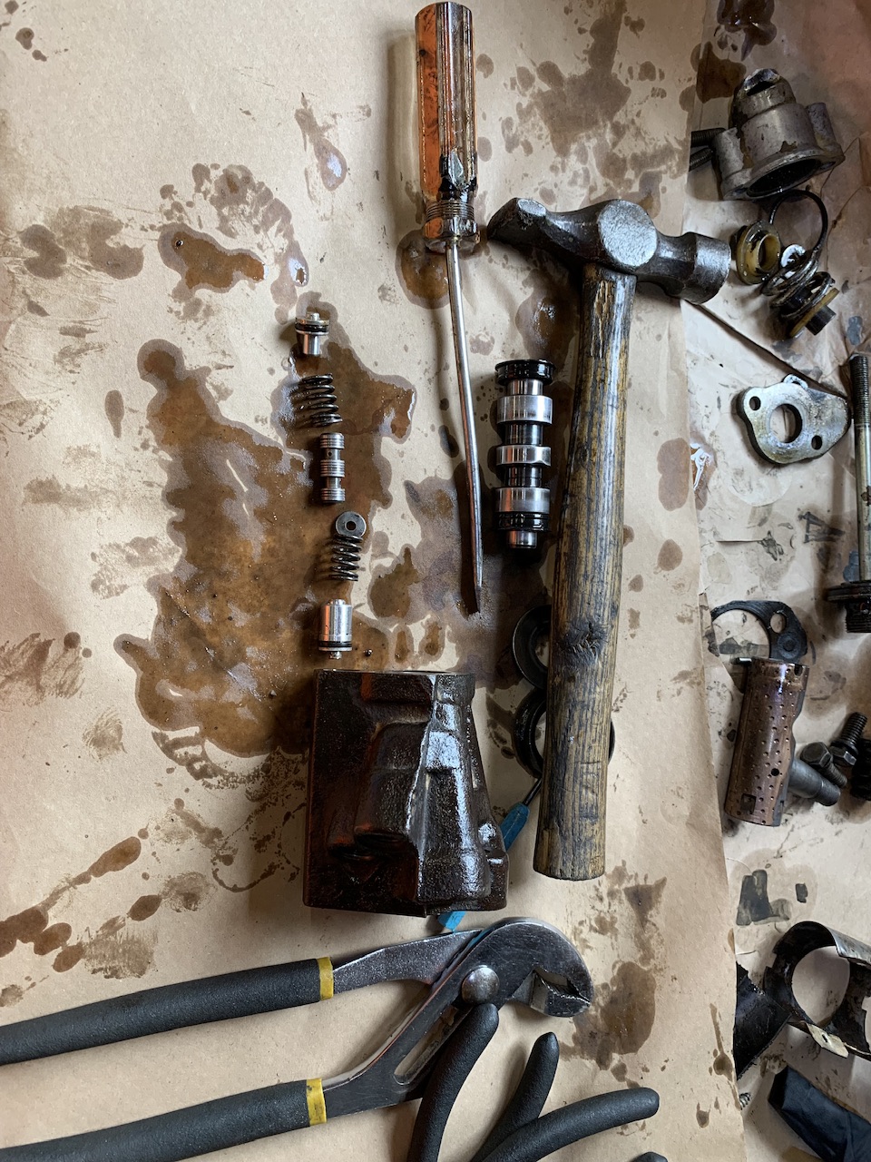

    Rebuilt the control valve
    Waiting on a new end cap now.

  25. Oneball
    Posts: 1,629
    Oneball
    It looks like the pin that holds the valve piston rod to the sleeve wasn’t put in properly so the sleeve could move around rather than just wear and tear.
  26. Oneball
    Posts: 1,629
    Oneball
    End cap arrived and steering is back together, seems to have sorted the play and wandering.
