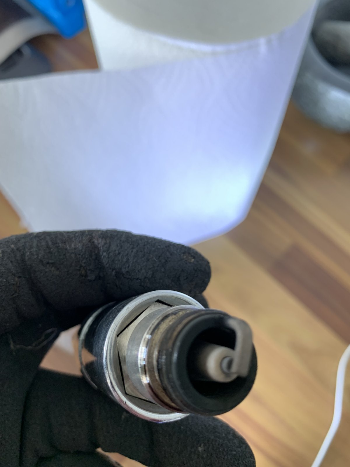

    After going to the garden centre yesterday to get compost I pulled a plug.
    I’d gone up 2 thou on the jets as I thought it was a little lean but have put the original ones back in.

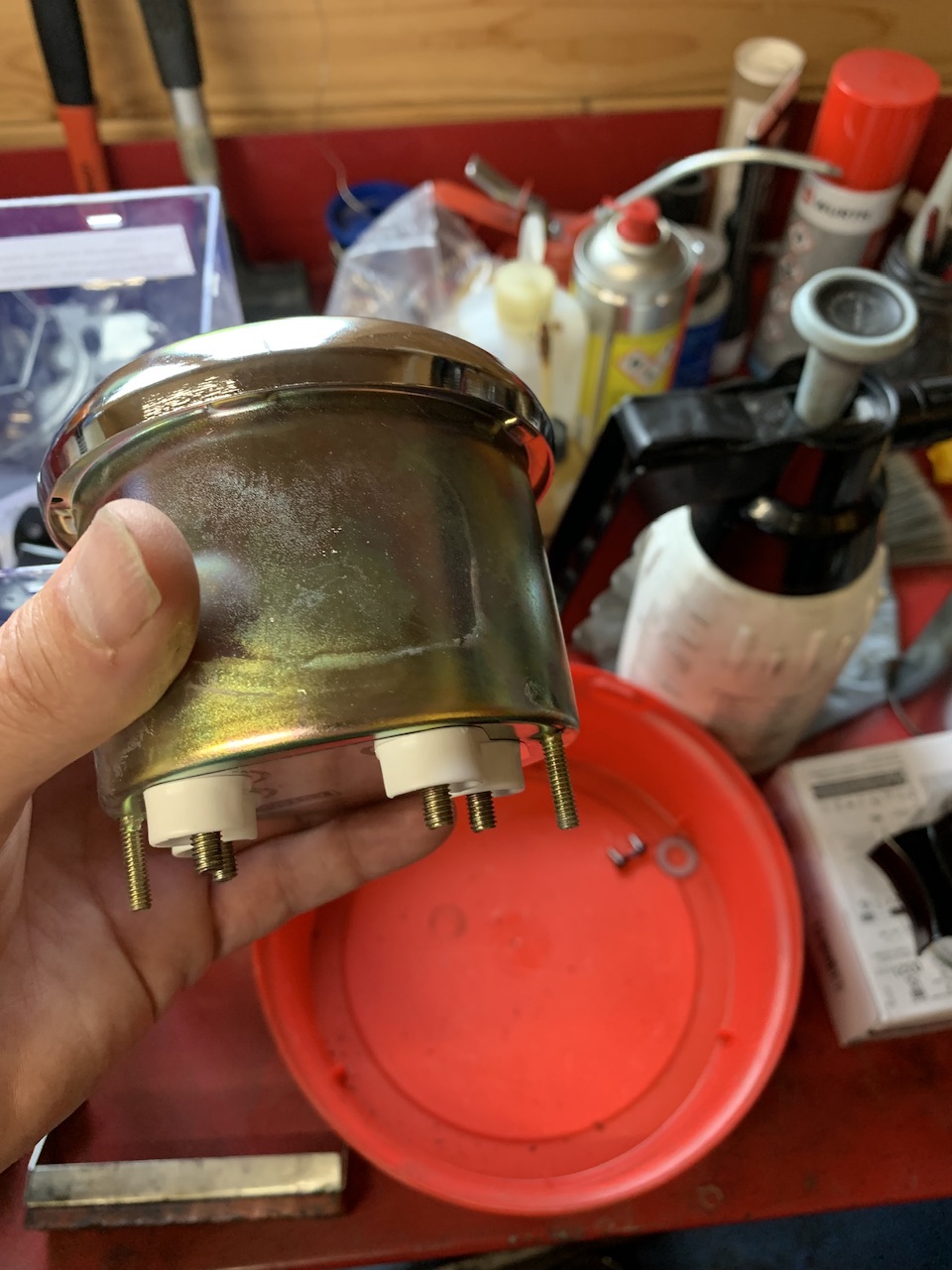

    I’ve also bought a rev counter, mainly for diagnostic purposes as it’s usefully when fiddling, but also, one day, it might need it :)
    It’s a Bosch one and I’m quite impressed by the quality it’s a steel case and pod.

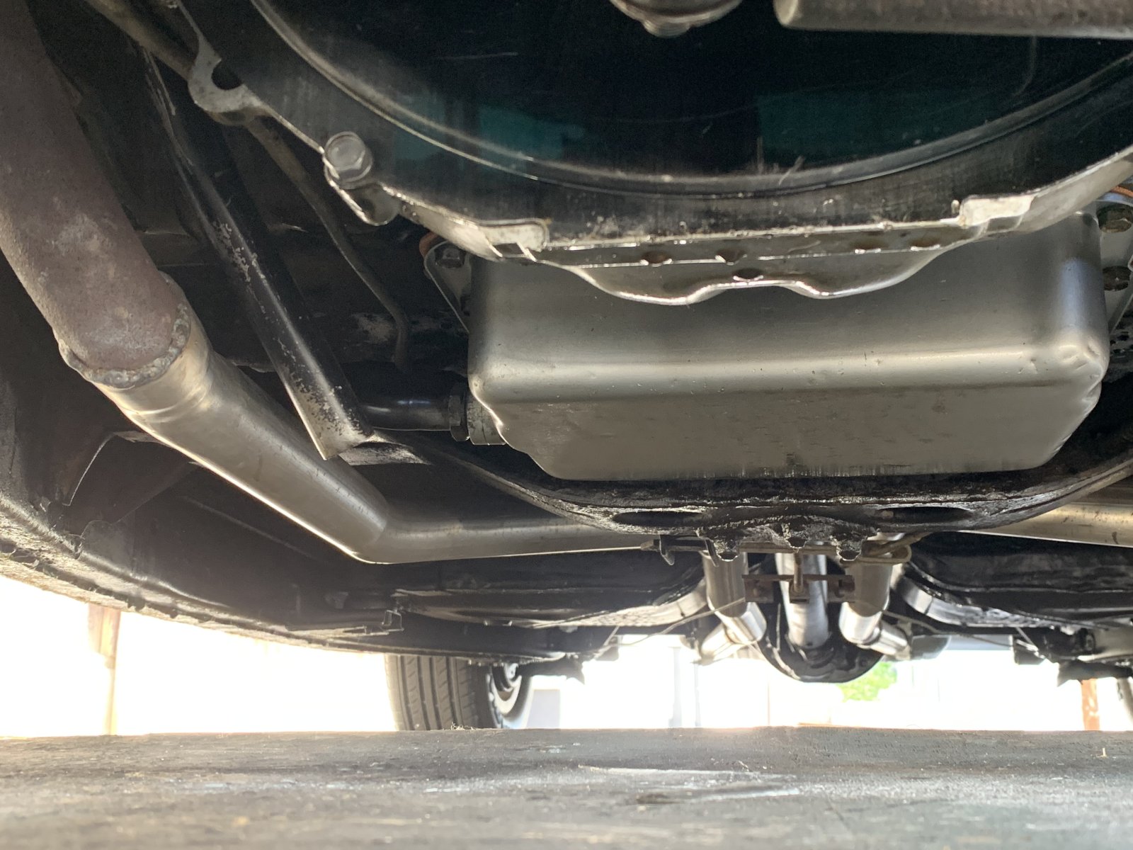

    Stuck a camera up it’s bum. Think it’s the rear main seal that is leaking, I’m surprised the flex plate is dry but there you go.

    This is more of a leak than I’d be happy to leave, it’ll coat the whole of the transmission after about 20 miles.
