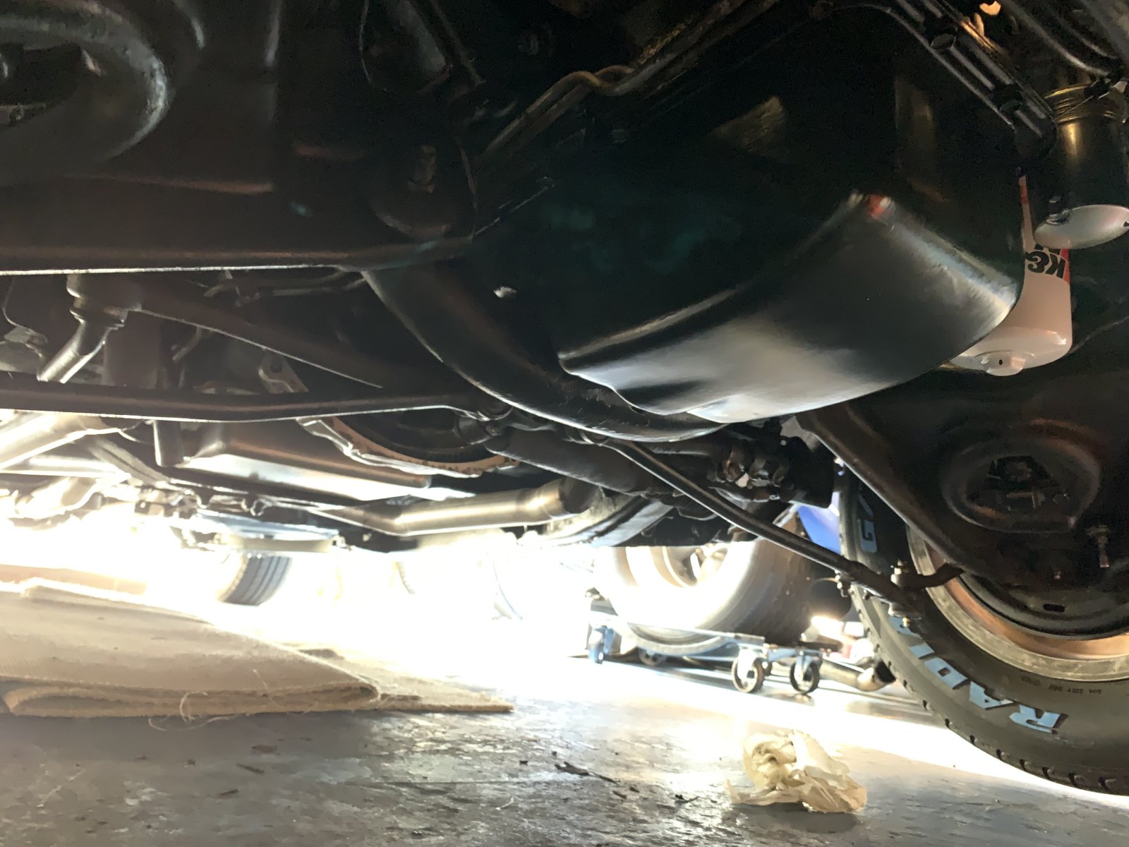

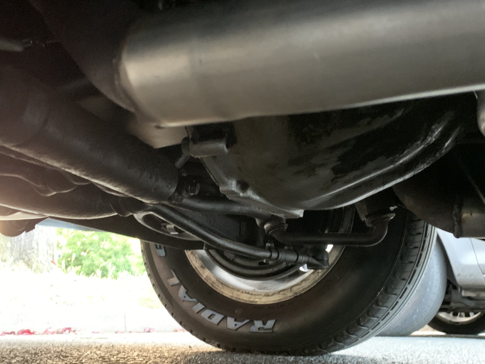

    I’ve owned one car or another from the sixties my entire adult life. I don’t mind the odd oil drip but this is really quite bad.

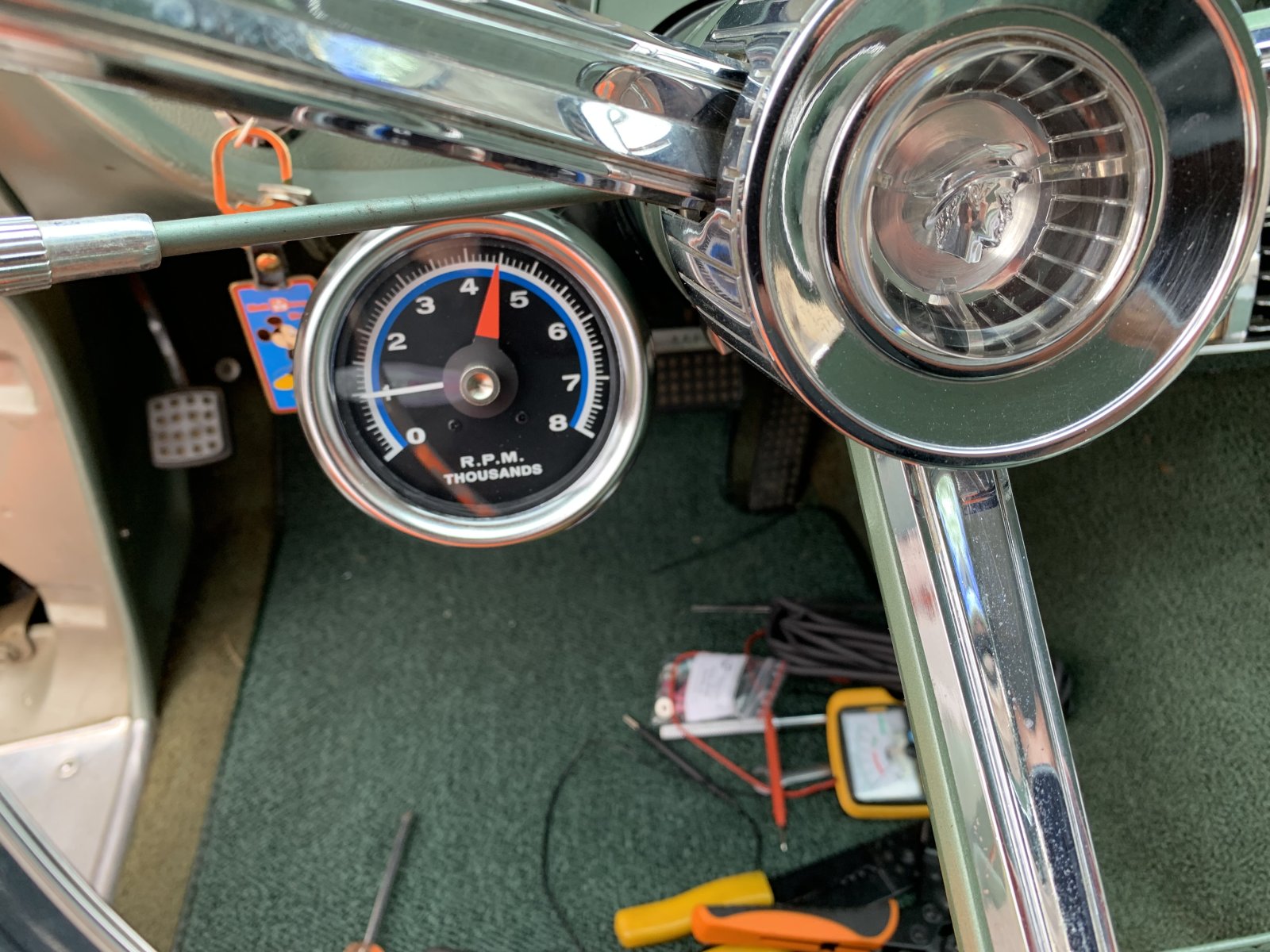

    Got the tacho mounted, just need to finish the wiring off in the engine bay.
    bobss396 likes this.

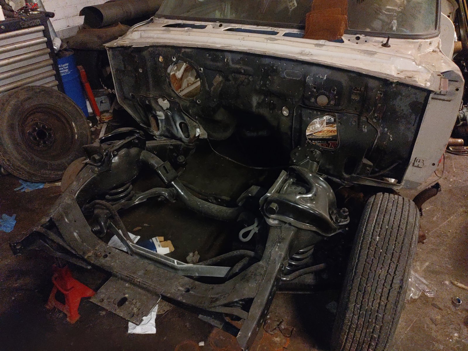

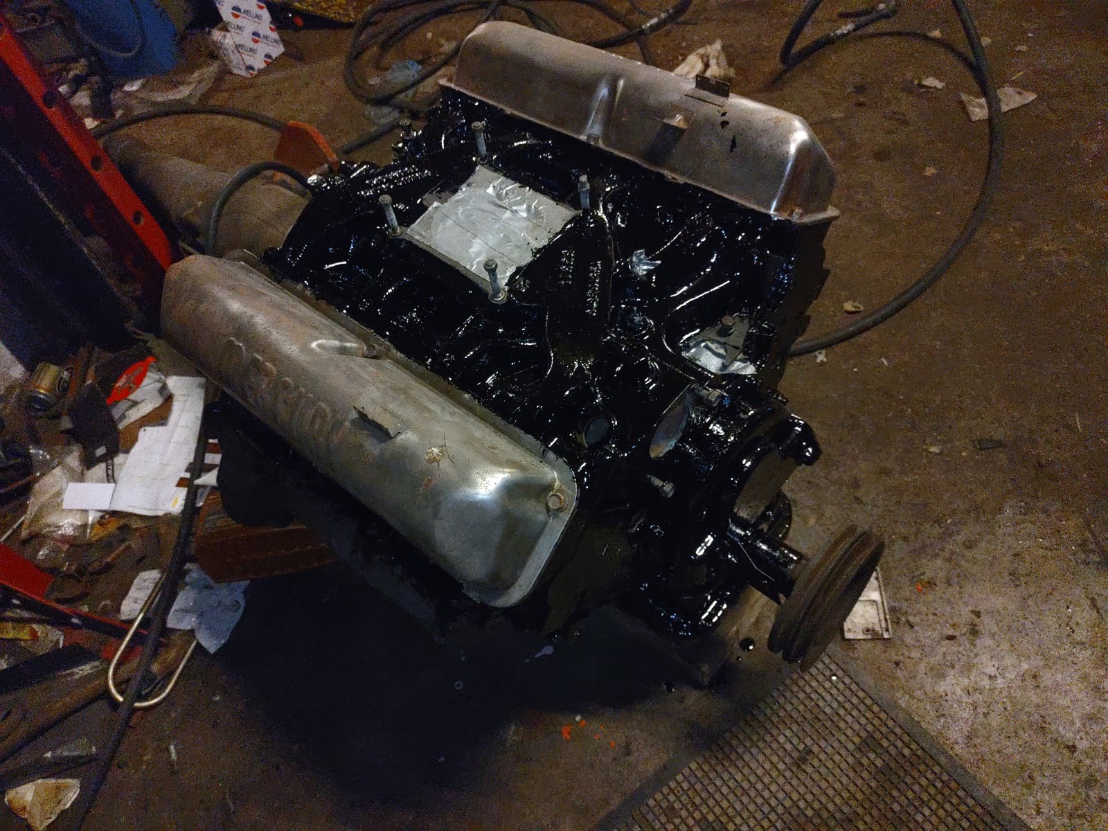

  4. Pontmerc
    Joined: Jul 13, 2013
    Posts: 447
    Pontmerc
    from Finland
    Thanks to you, i know the oil pan will go out when engine is in place.
    Thats get me motivated to paint the block and lift that engine trans combo in its natural habitat. 17215131233154962936071212889134.jpg 17215132307017160347908579981620.jpg
    bobss396 and Oneball like this.

    Finished making a loom for the tacho
    And it moves!
    Tow Truck Tom likes this.

    Sump off. Doesn’t look like the gasket has failed this time.
    Hopefully get a rear main seal tomorrow.

    Sump back on. Looks like a blob of sealer had got on the lip seal as there was a fair bit of debris around it. The lip seal isn’t the tightest fit in the groove so if this doesn’t work I’ll have to pull the engine and put a rope seal in
