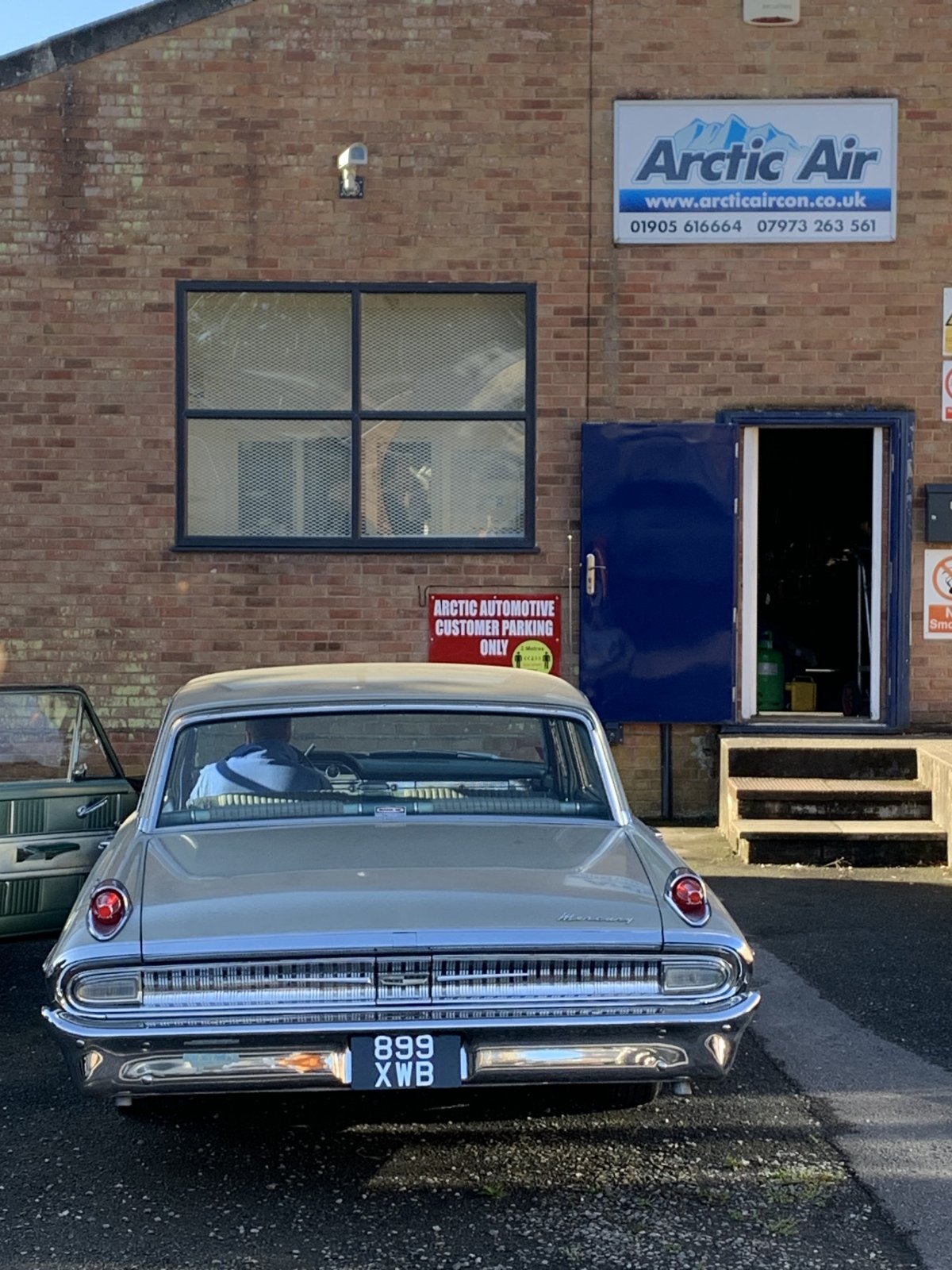

    45f here this morning, so I took the car to the AC repair place!
    The condenser is holed along with a couple of the rubber hoses, they’re going to get some bits and then I’ll take it back.

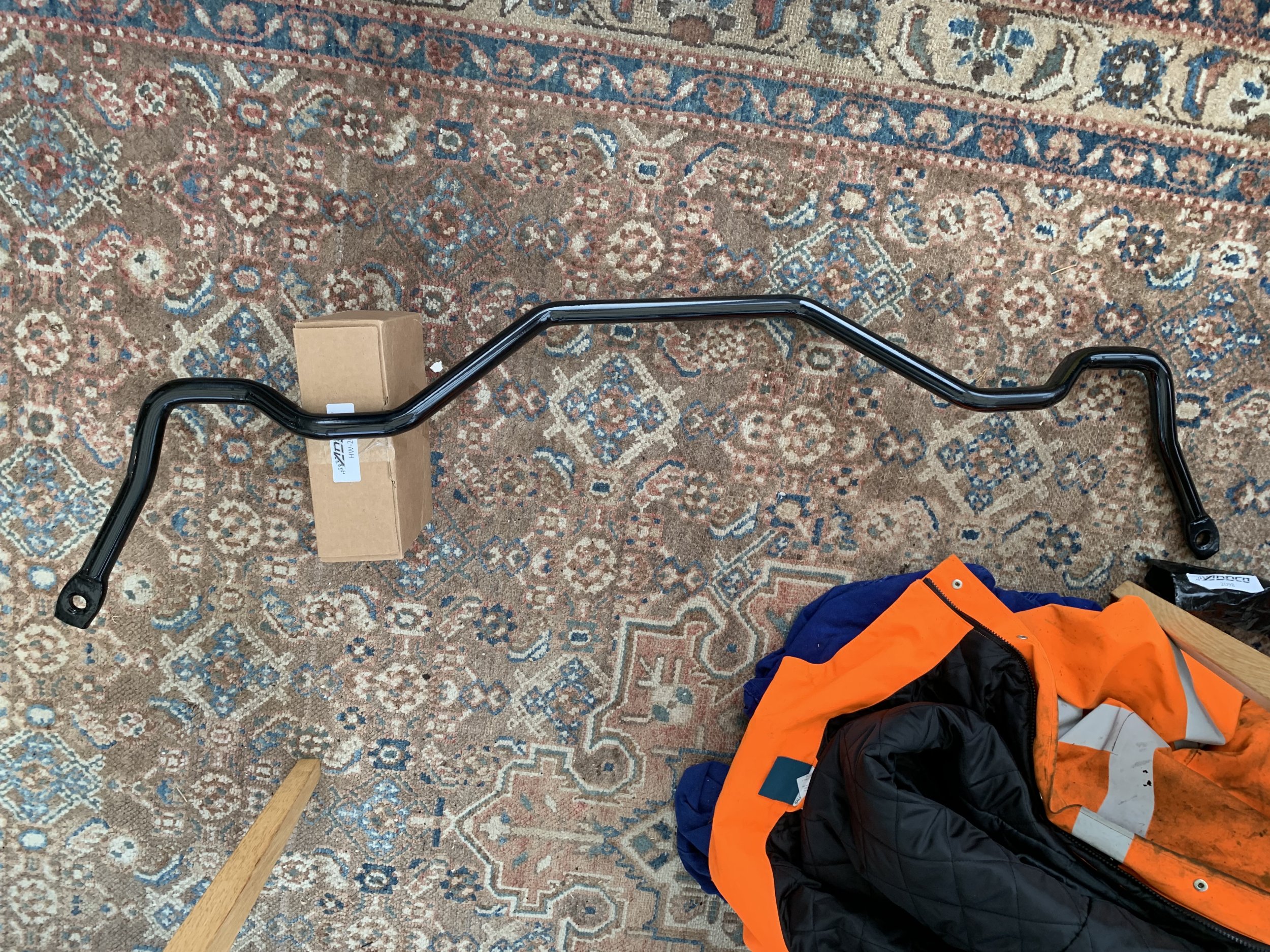

    Got a larger front sway bar, fingers crossed will try and fit it tomorrow morning

    It’s an Addco sway bar, my supplier over here got it for me but Summit etc have them. There’s 2 reviews on the Summit site that says they don’t fit but I got it on.
    They are a right pain though both for removal and install.
    Fuel pump off, front pulley off, generator off, drum and backing plate off and lift the engine a bit, but eventually got the old one out and new one in. Just putting it all back together.

    It’s just touching the generator, going to try a shorter belt. If that doesn’t work there is scope for some packers under the mounts that’d move it lower.

    I didn’t use the drop links that came with the sway bar as I’d put new ones on about 300 miles ago but looking at them they’re a fair bit shorter so will try them first see if it makes a difference

    I’ve put a 1/2” shorter belt on and it’s sorted.

    My links were way shorter too. I had to take out bumper bolts on each side to get the brackets on. The old bar, I just cut it off since I was working alone.
