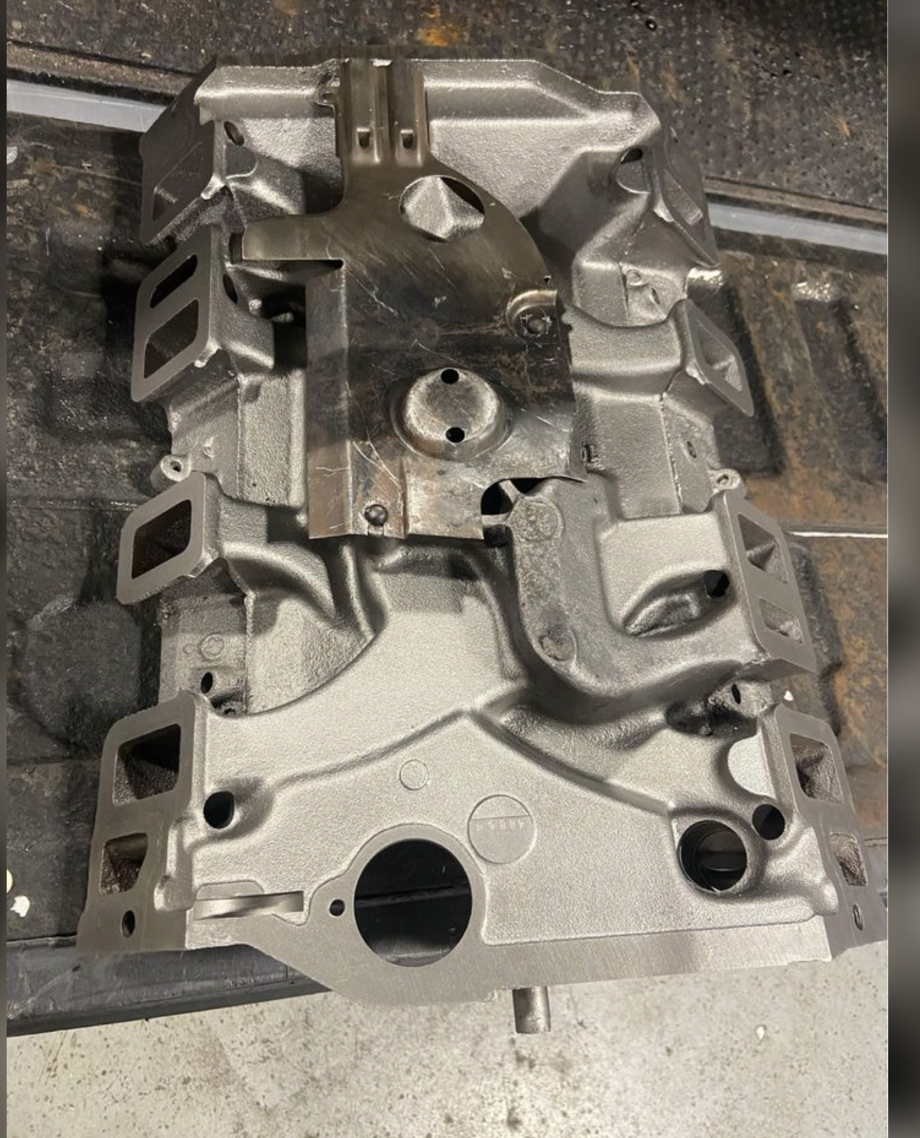

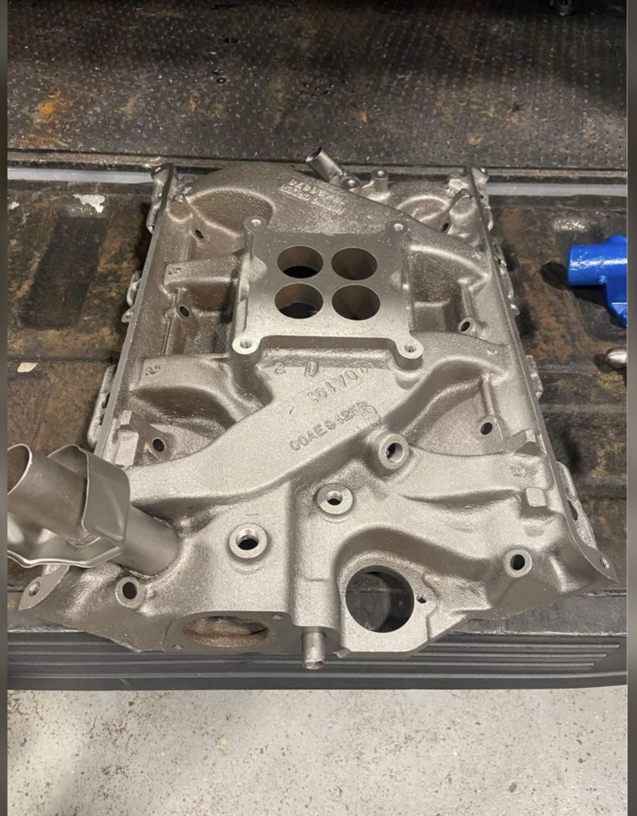

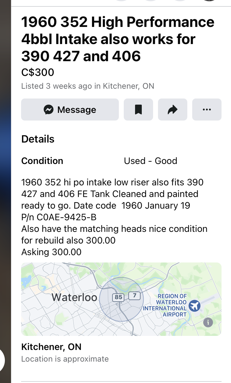

    I am very fond of FE's.... very strong workhorses..... If you decide to dig into the engine lightly. consider swapping out the intake with a FOMOCO factory Aluminum unit... the cast ones are extremely heavy(75-80lbs.)
    saw this listed locally for $300 and thats cheap.
    The risk is hopefully it hasn't been machined or warped....
    good luck.
    EDIT---- In my excitement over FE'S. I posted that FE "HiPo" 1960 intake
    It indeed was NOT a Hipo intake Tim... It took my future son in law to point that out to me.... Sorry for the misinformation,
    I knew it was too good to be true.

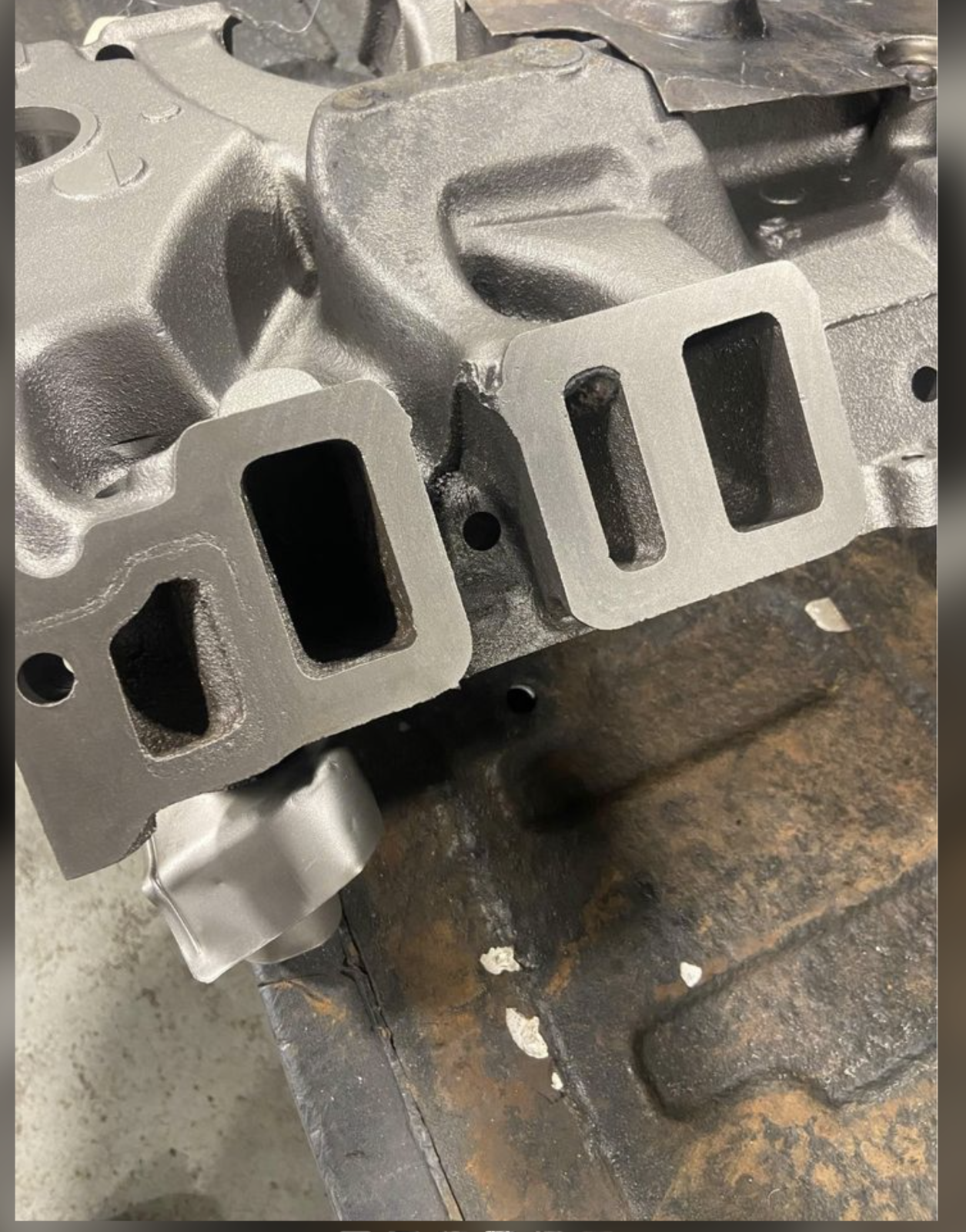

    Thanks Jeff. I’ve already bought an alloy intake from here and found a 4bbl Autolite on eBay. The racer in me couldn’t resist!
