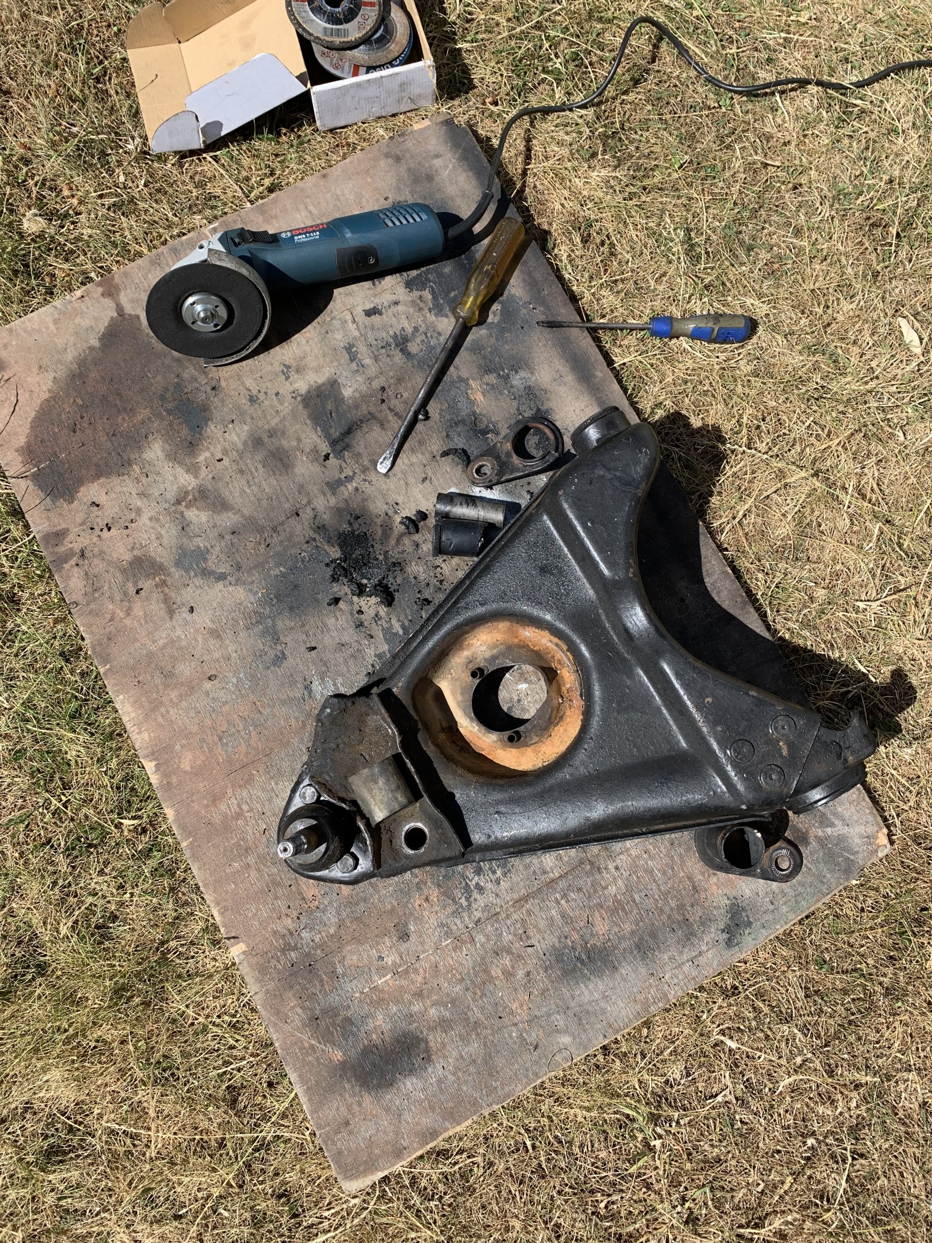

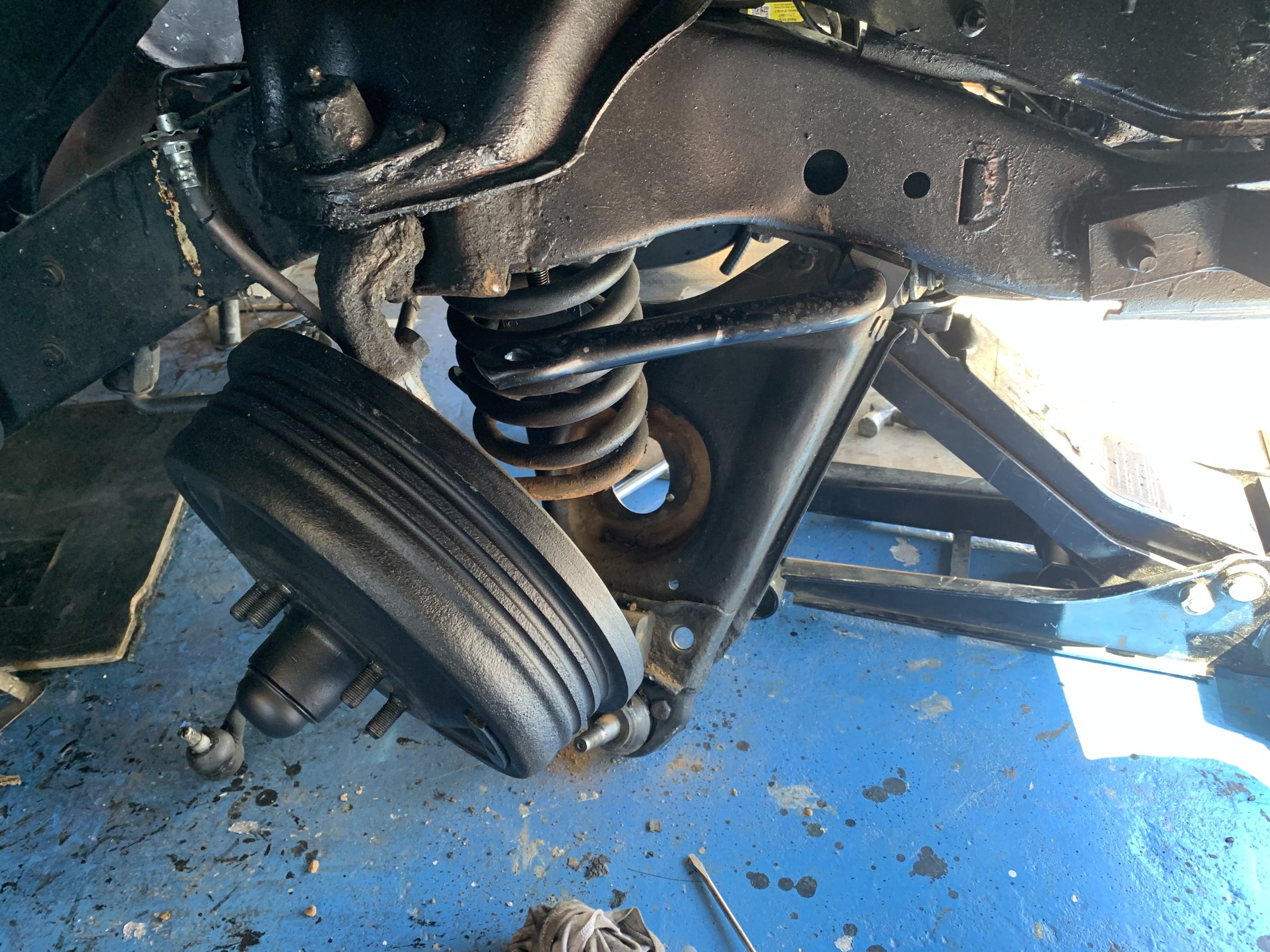

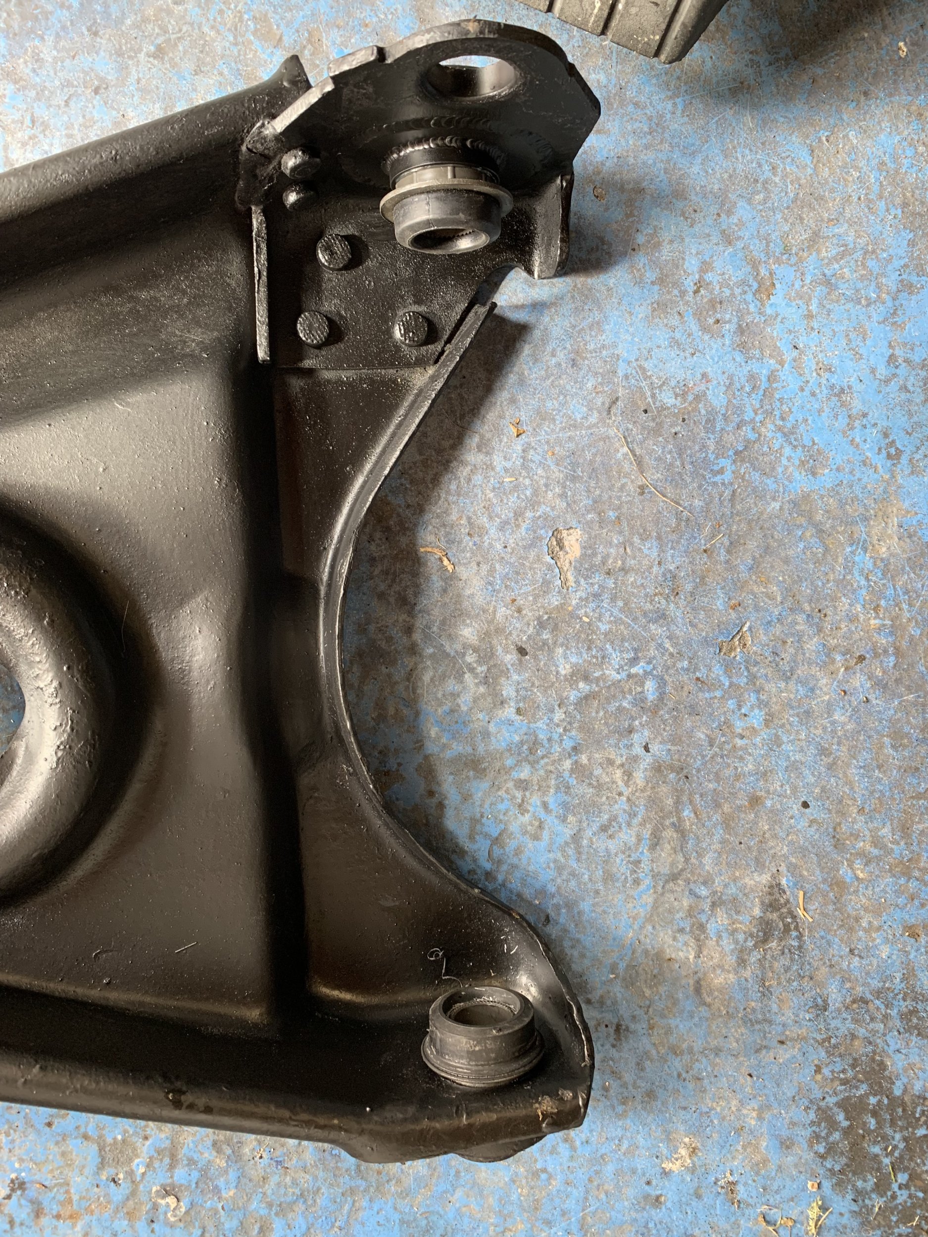

    Decided to get on with hopefully the last bit that’s causing the woolly front end, lower arm bushes. The Merc ones are silly money so copying @FrozenMerc and replacing the complicated double front bush with a single one.
    Managed to get a splitter that fits the truck sized lower ball joint without ******ing it as it’s new.
    Arm removed.
    That’ll explain the wandering and nasty turn in then;
    Need to get the other side off, then weld a sleeve in to take the round Galaxie bush.

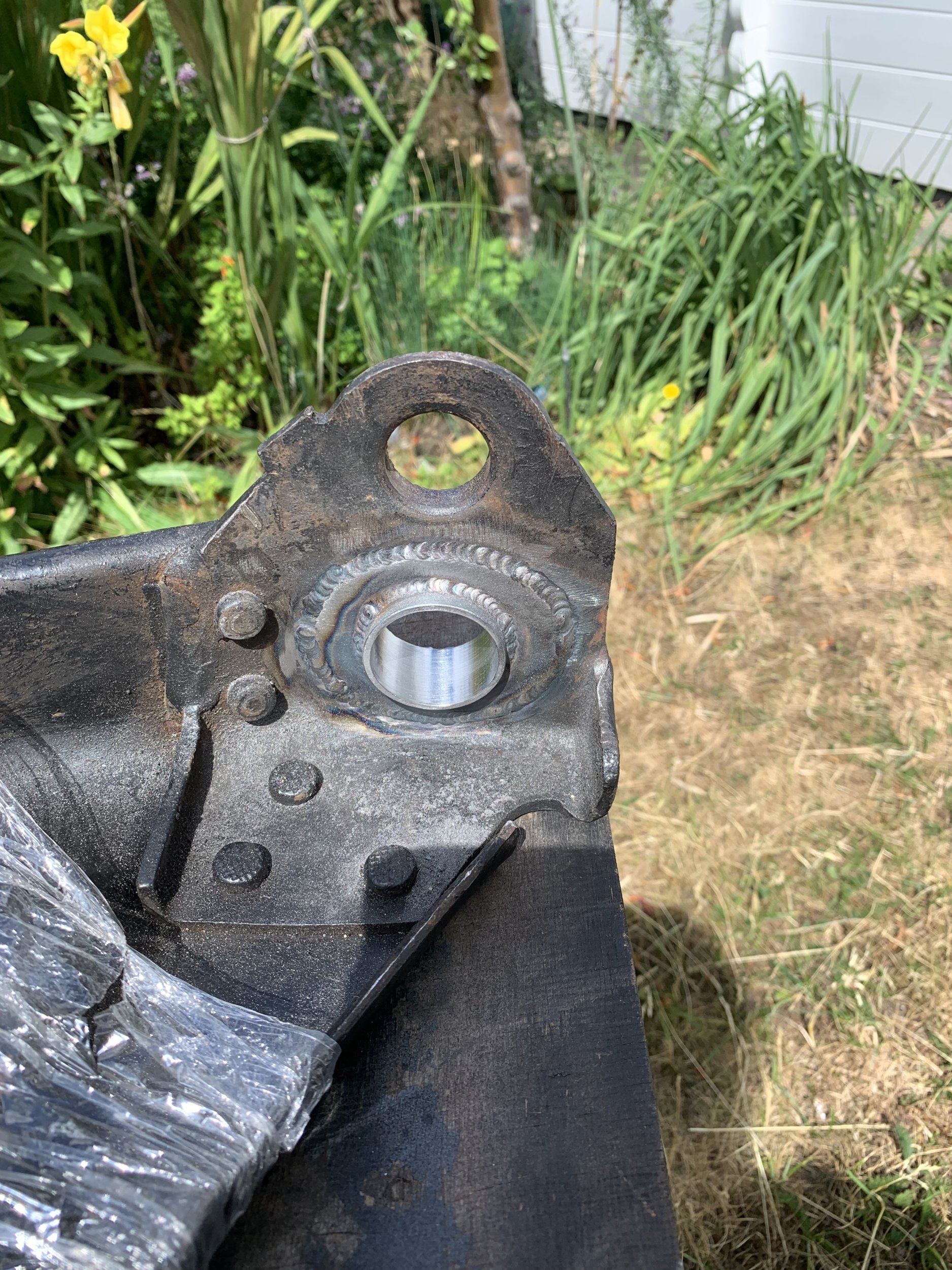

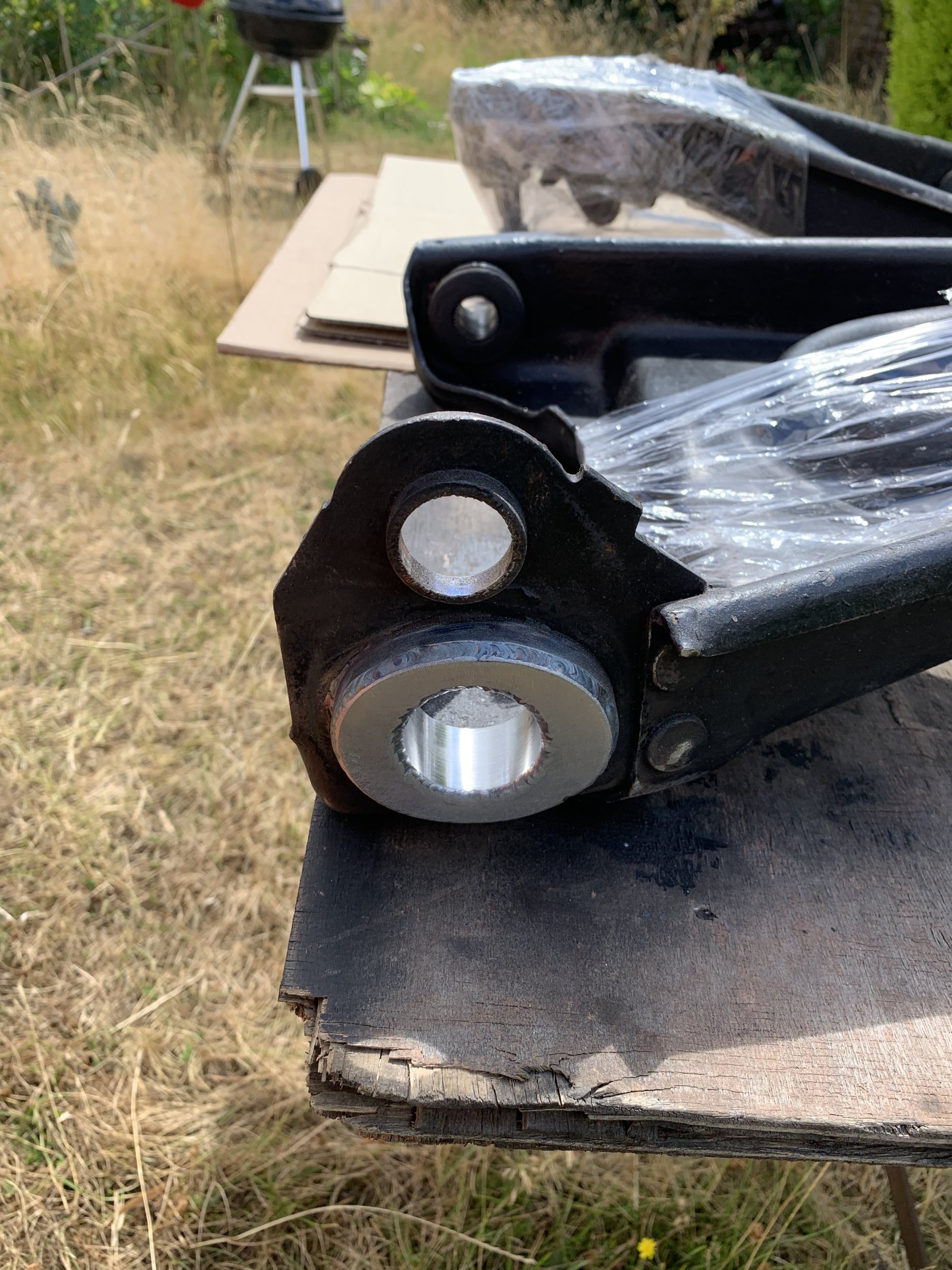

  14. Oneball
    Joined: Jul 30, 2023
    Posts: 1,631
    Oneball
    Inserts welded into both arms to take the single round rear Mercury/Galaxie bush. I went for the rear instead of the front Galaxie bush as it takes the larger bolt used by the original bush.

  15. Oneball
    Posts: 1,631
    Oneball
    Bushes pressed in

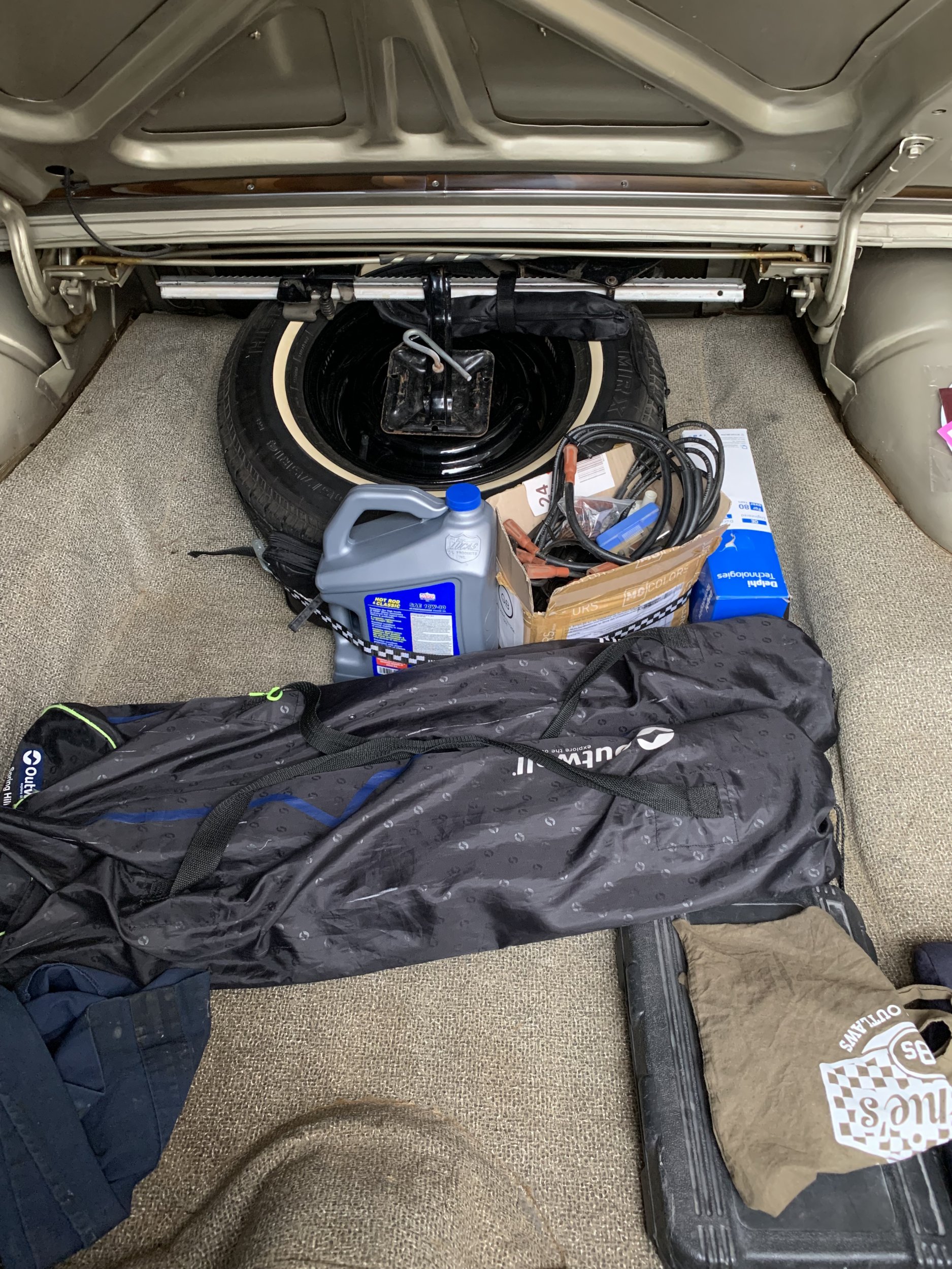

    I’m off to France in a little over a week in the Merc. This’ll be the longest trip it’s done since the 1970s.
    I’ve ordered a spare fan belt and have got spare fuel pump, coil, condenser, rotor arm and cap as well as the usual fluids. Anything ive missed??
    bobss396 and guthriesmith like this.
  18. bobss396
    Joined: Aug 27, 2008
    Posts: 18,732
    bobss396
    Points too? Flat fixing materials, small compressor, empty or collapsible water jug.
    Oneball likes this.
  19. Oneball
    Posts: 1,631
    Oneball
    Thanks, I’ve got points and I did buy a lug nut wrench and turned a bit of steel down to make a jack handle as they were missing. Tyre pump is in the other car. I’ll move it over and pop a water bottle in too.
