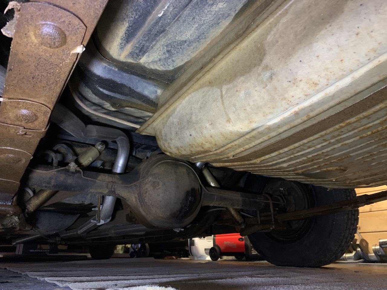

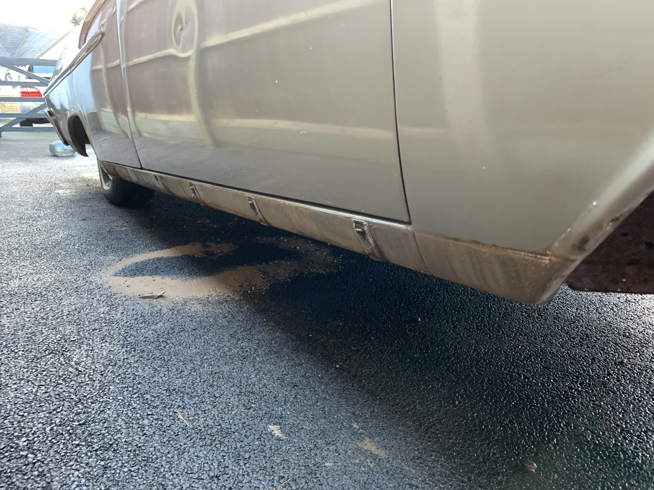

    Sill covers off and no nasty surprises.
    The leak on the drive wasn’t the steering it was the fuel pump diaphragm, so I’m ***uming that’s ******* into the sump too.

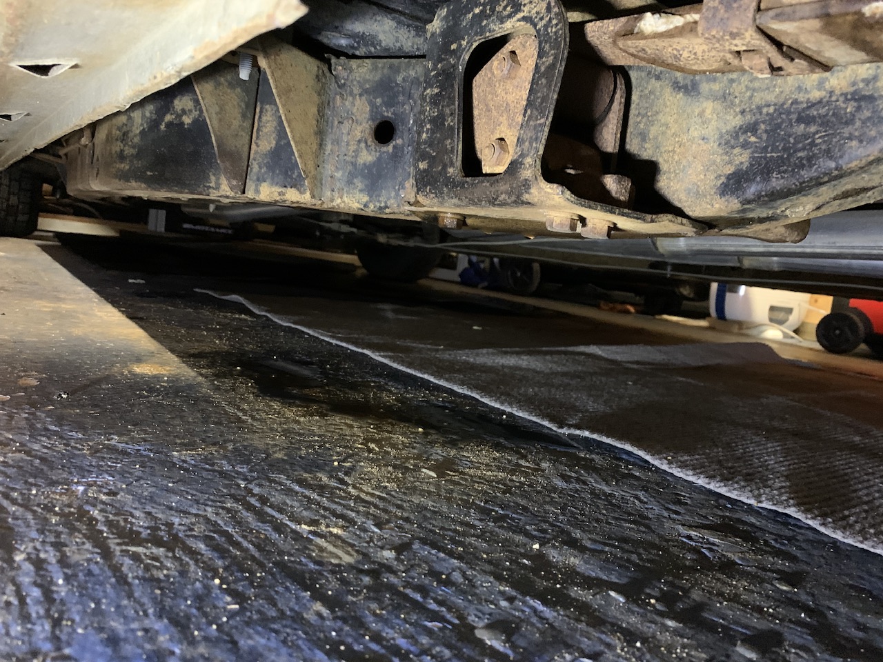

    About 12 hours later I think I’ve got most of the mud and sand off the bottom

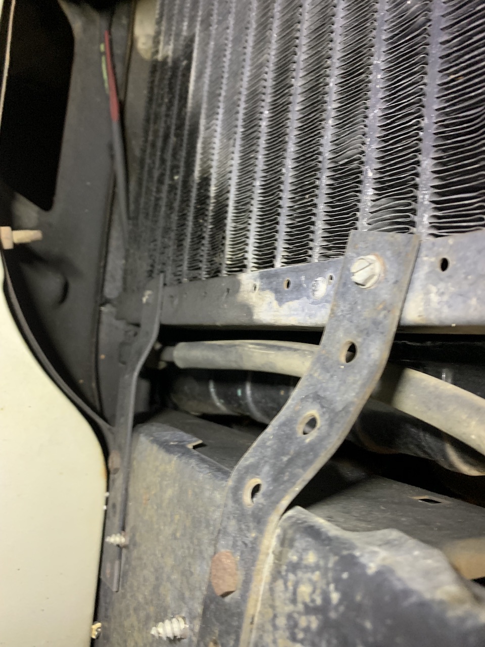

    Think I’ve found why there’s no gas in the AC
    Power steering grumble is the pump, it’s a newly rebuilt one but the oil has a festive sparkle to it. I’m going to leave the underside till the New Year to properly dry out before coating it.

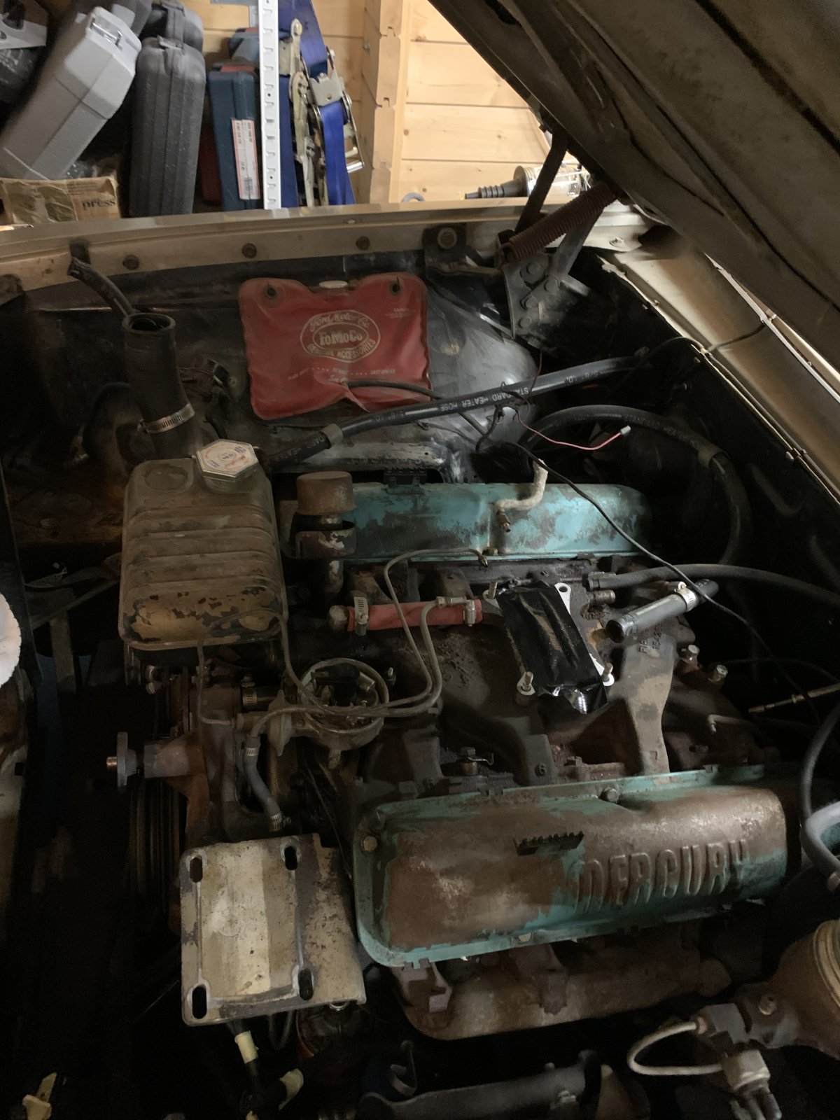

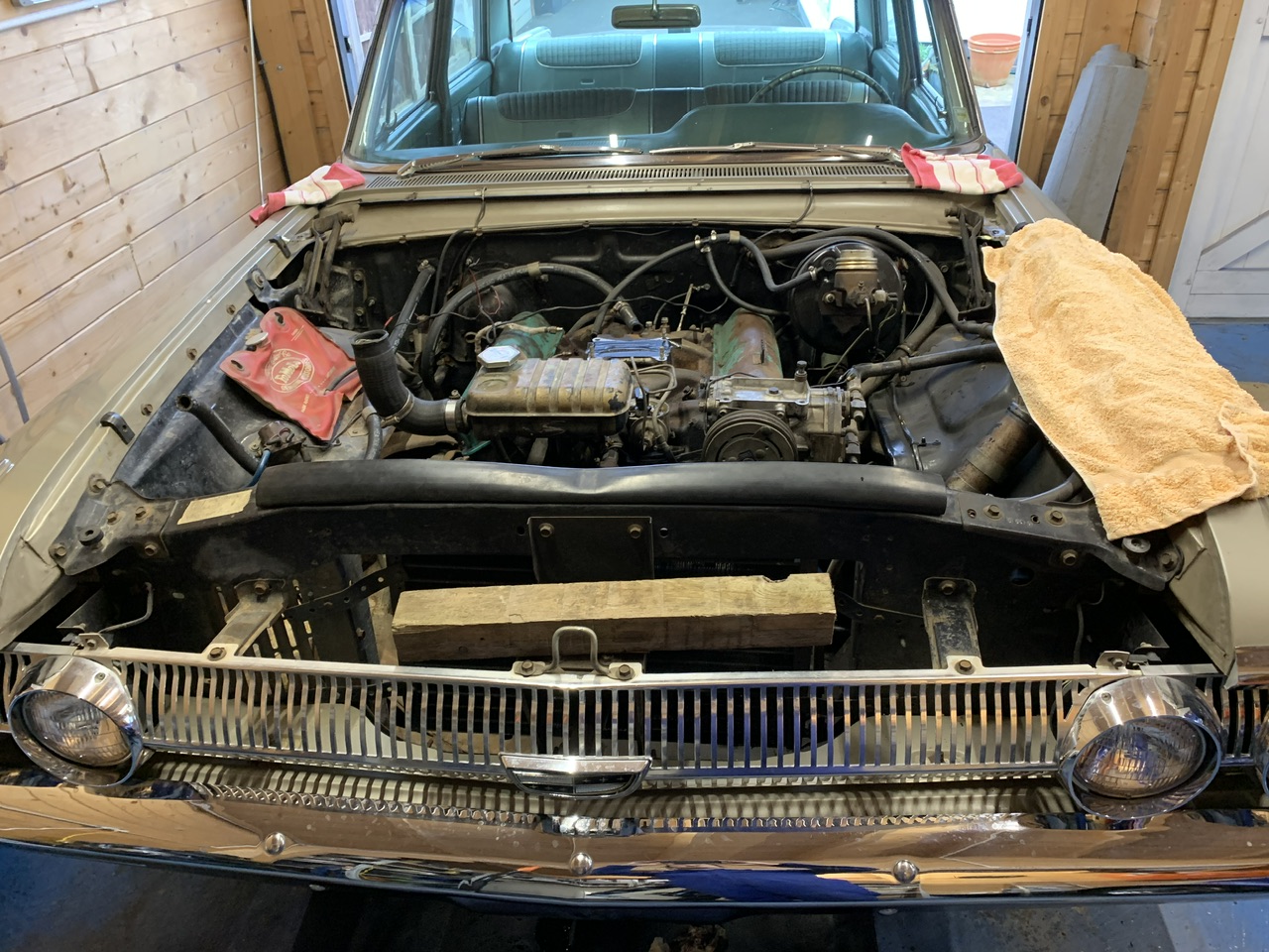

    Engine is ready to come out, just trying to come up with a plan to support the transmission whilst keeping it mobile.

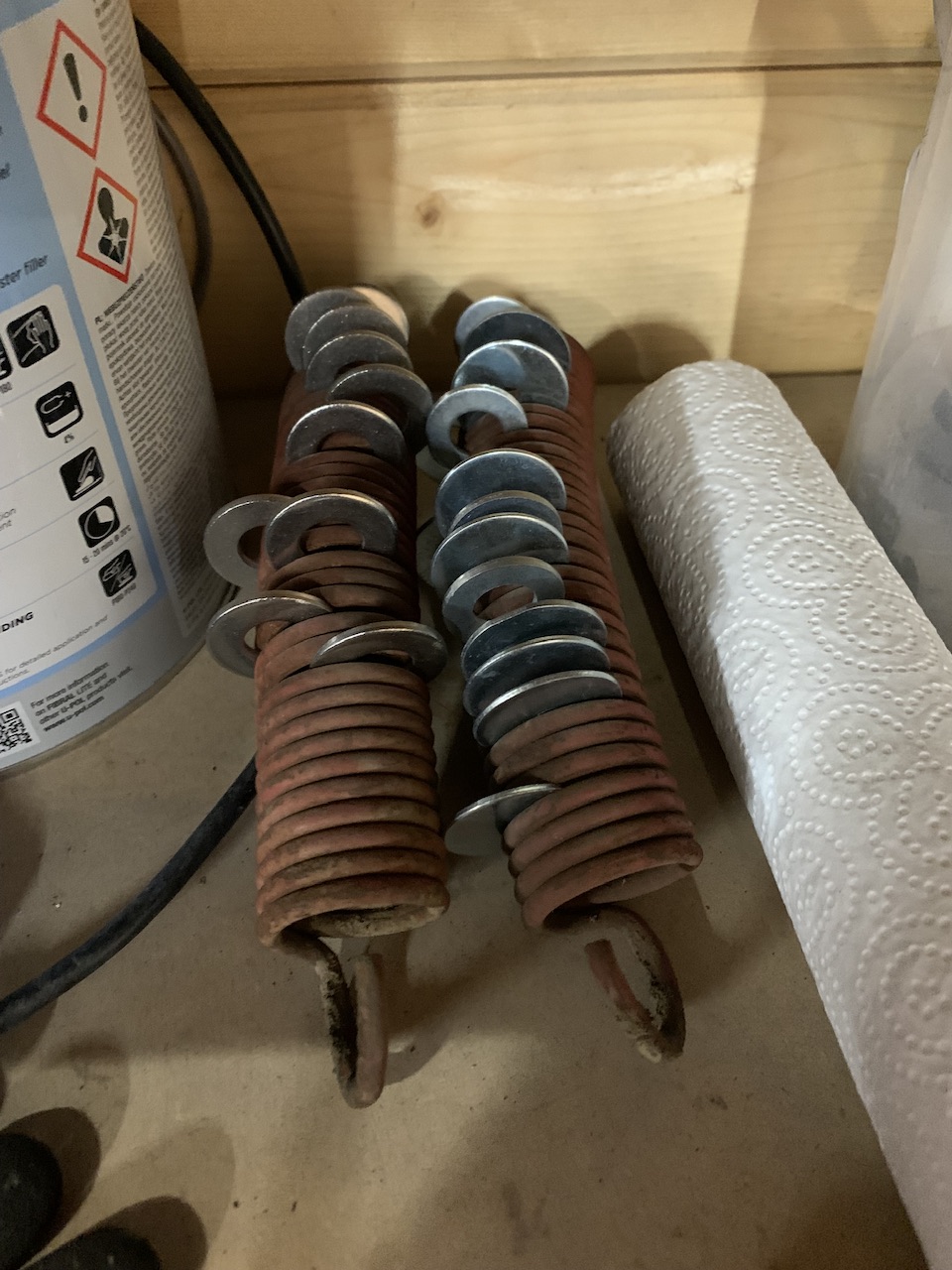

    Whoever posted on here somewhere about using washers to help get the bonnet springs off is a genius.

    Ratchet strap between frame rails and piece of 2x4 between strap and transmission.

    Thanks. Ratchet strap is what I was thinking. Block of wood is a good plan though.

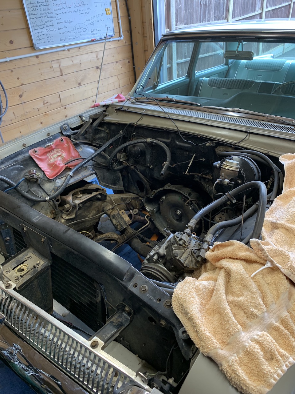

    Bonnet off
    And engine out, it’s going to have to sit there a while. I’d ***umed I could mount it to the engine stand with the same bolts I use for Chevys but they’re too small so will have to get some after Christmas

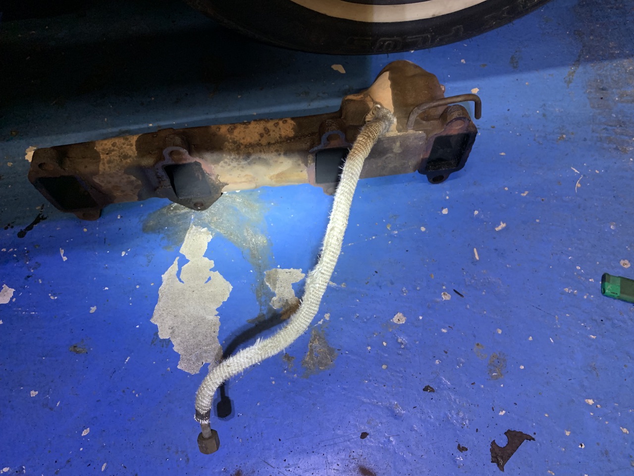

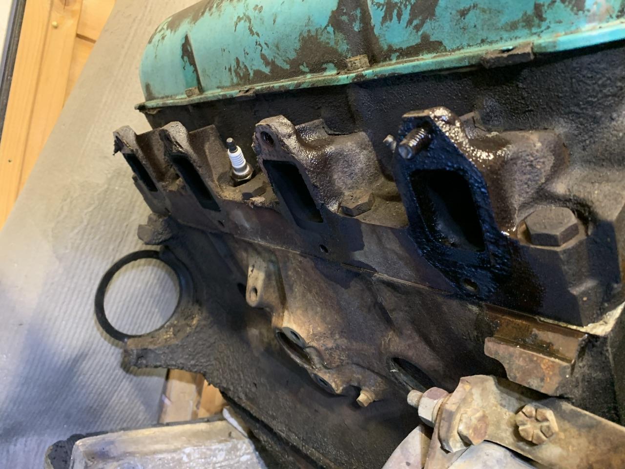

    Got the LH exhaust manifold off with out too much trouble. The RHS is proving a bit harder.

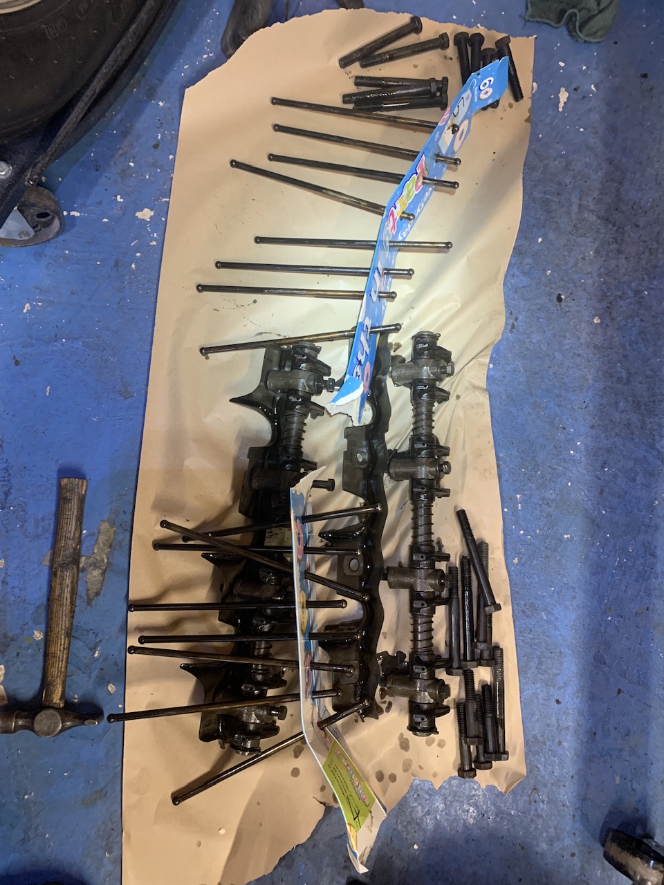

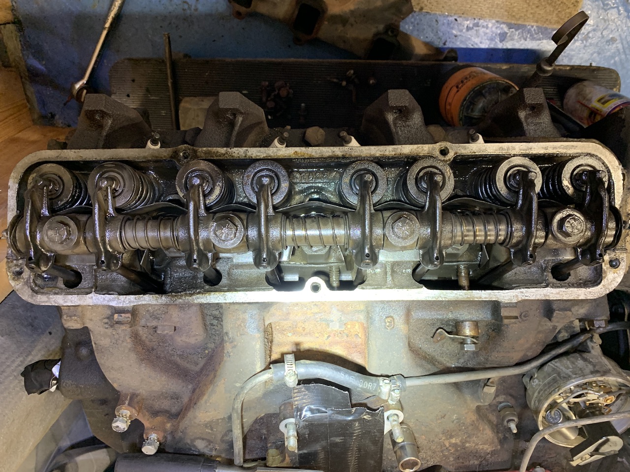

    Took a valve cover off, top end looks pretty good for a 60 year old motor

    Broke one bolt but got the other side off too.
    Choke heater is blocked. Not sure whether to keep it or convert to electric

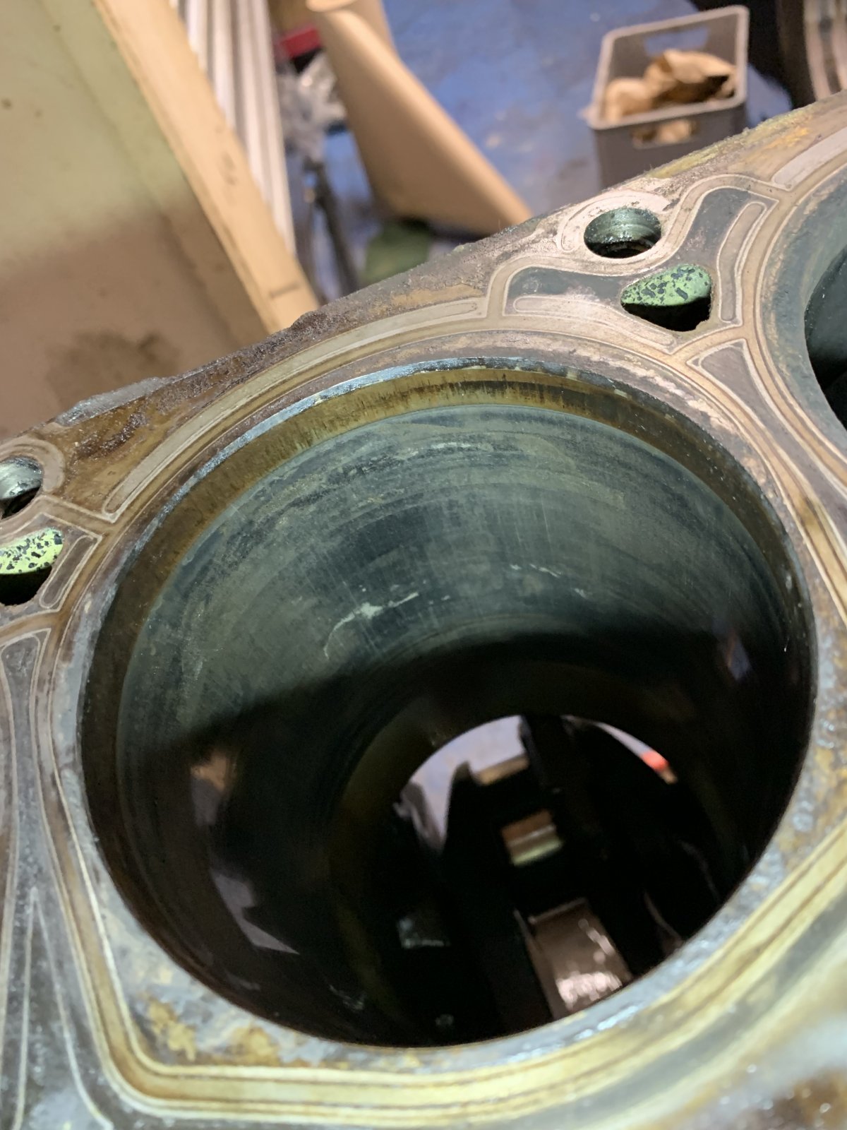

    Oneball

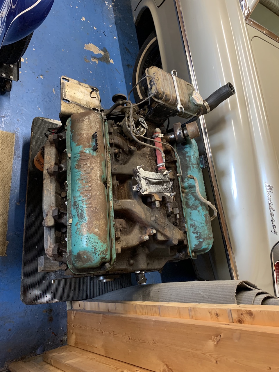

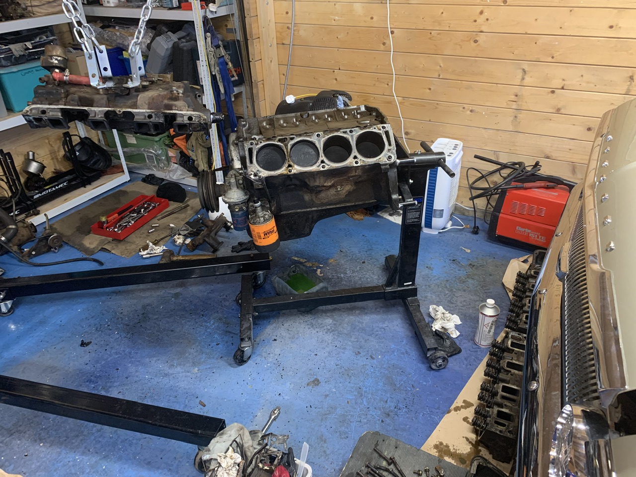

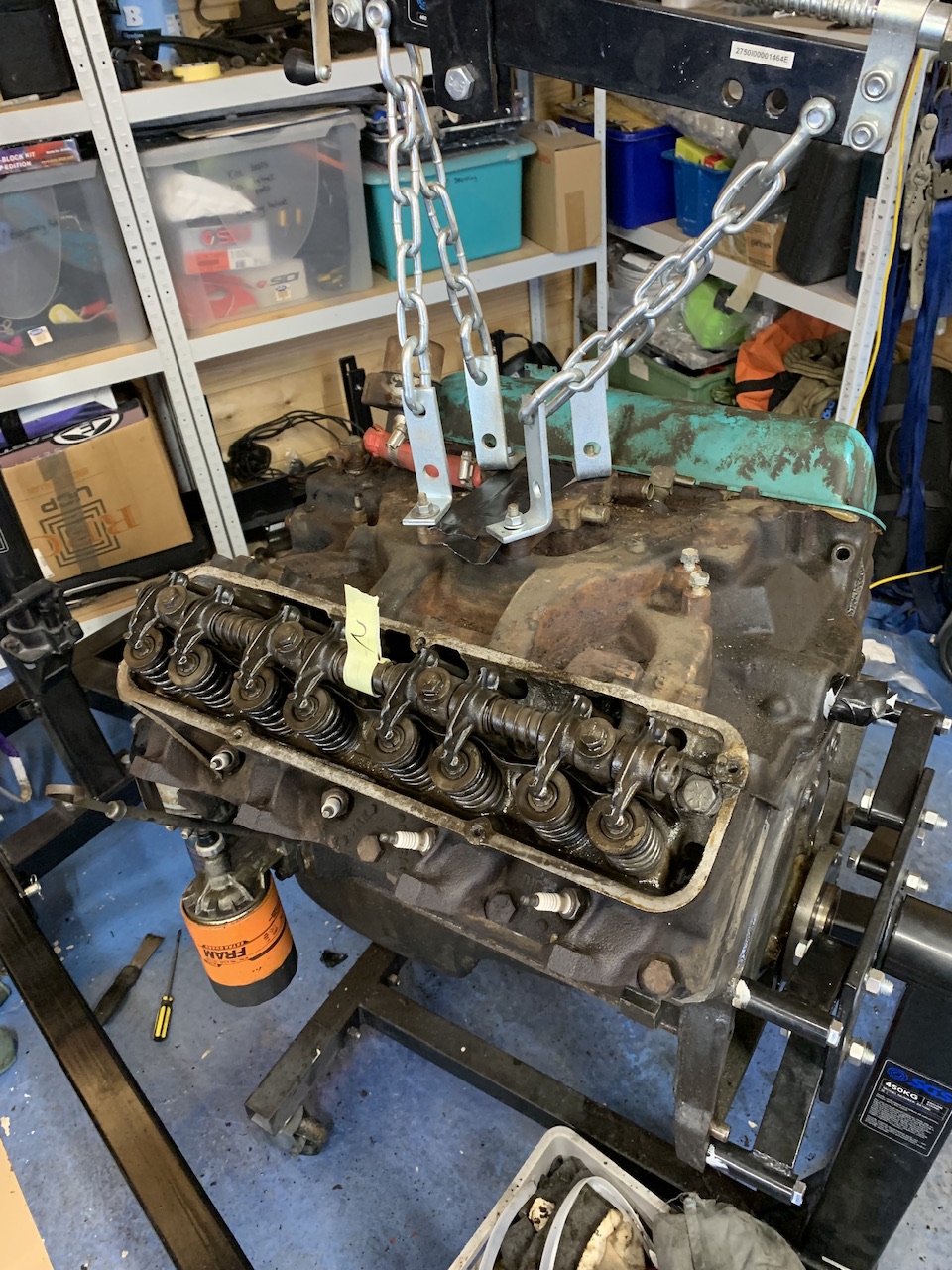

    Back from the in-laws and got the engine on the stand today.
    And stopped the inlet and heads.

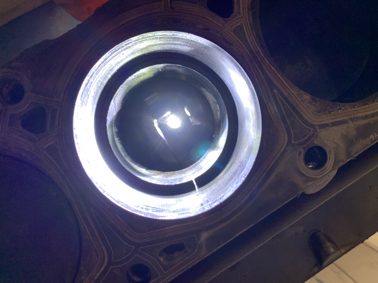

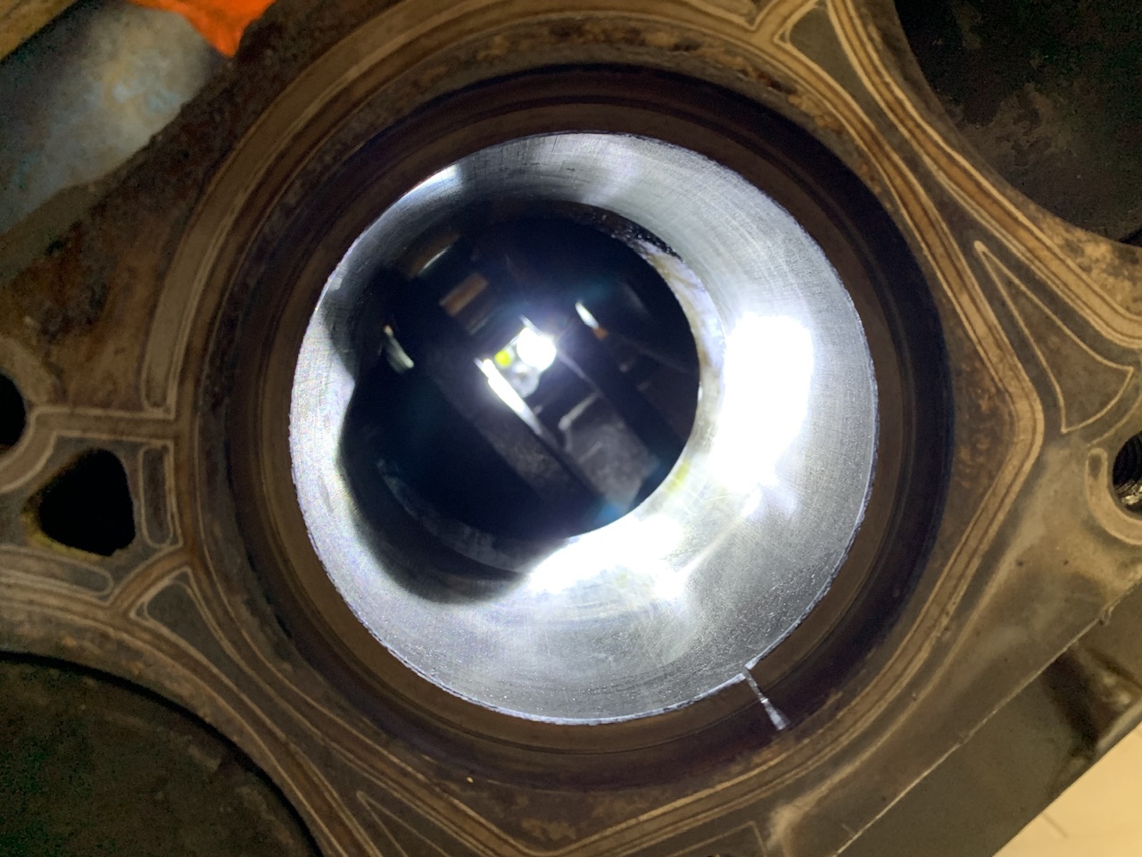

    Think it’s probably going to need a re-bore, there’s basically no wear but it looks like it’s got seized some point in the past.
  17. bobss396
    Joined: Aug 27, 2008
    Posts: 18,741
    bobss396
    A good honing may clean that up. Who is doing the prep work, you or a shop?
    Oneball likes this.
  18. Oneball
    Joined: Jul 30, 2023
    Posts: 1,643
    Oneball
    Me, I do pretty much everything myself unless I don’t have the tools like machining.
    It’s borderline. I’ll give it a try but it catches your fingernail. Bit of a shame as you can still see the crosshatching in some of the bores. I’ve not actually looked at all of them so it may be the worst or it may not.
  19. Only one bolt? Some people have all the luck!
  20. Hmmmm. For a daily cruiser, I’d probably hone and go.
    About 6 yers ago a friend had a stuck 318 polly. Soaked for a while, no good. I bowed up in a pry bar an got it to turn.
    He changed the oil and been driving it since.

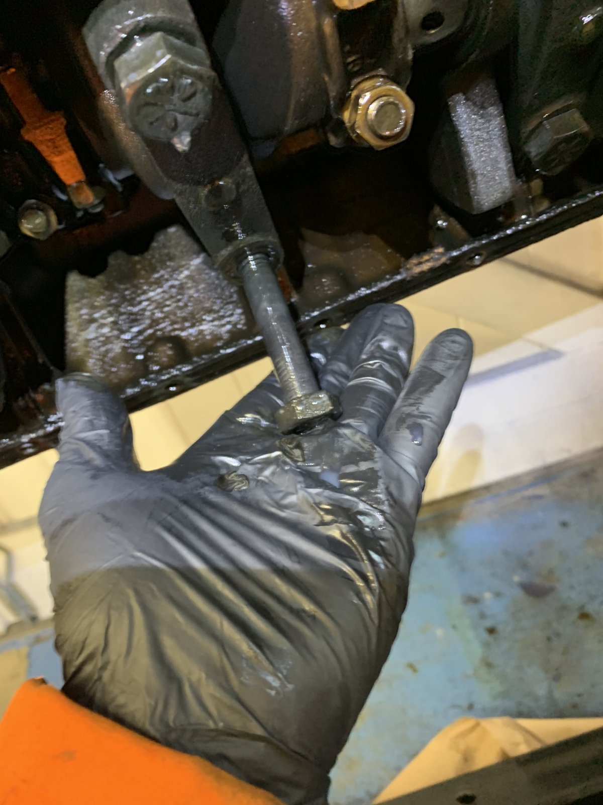

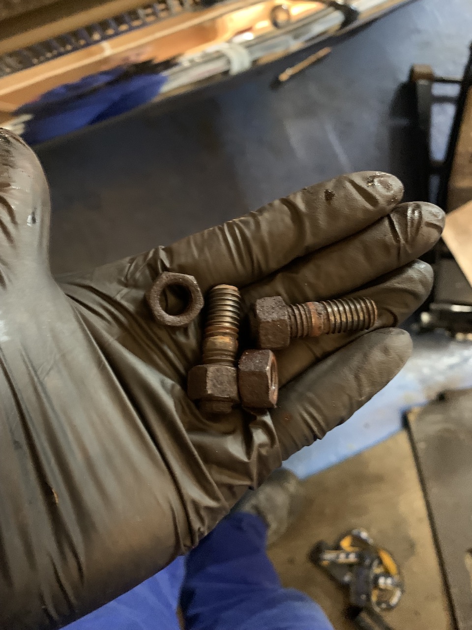

    There was about 3/4” of it sticking out so I welded a nut to the end. It broke. I did that 3 times and it just got shorter. It ain’t coming out so going to have to drill and tap it.

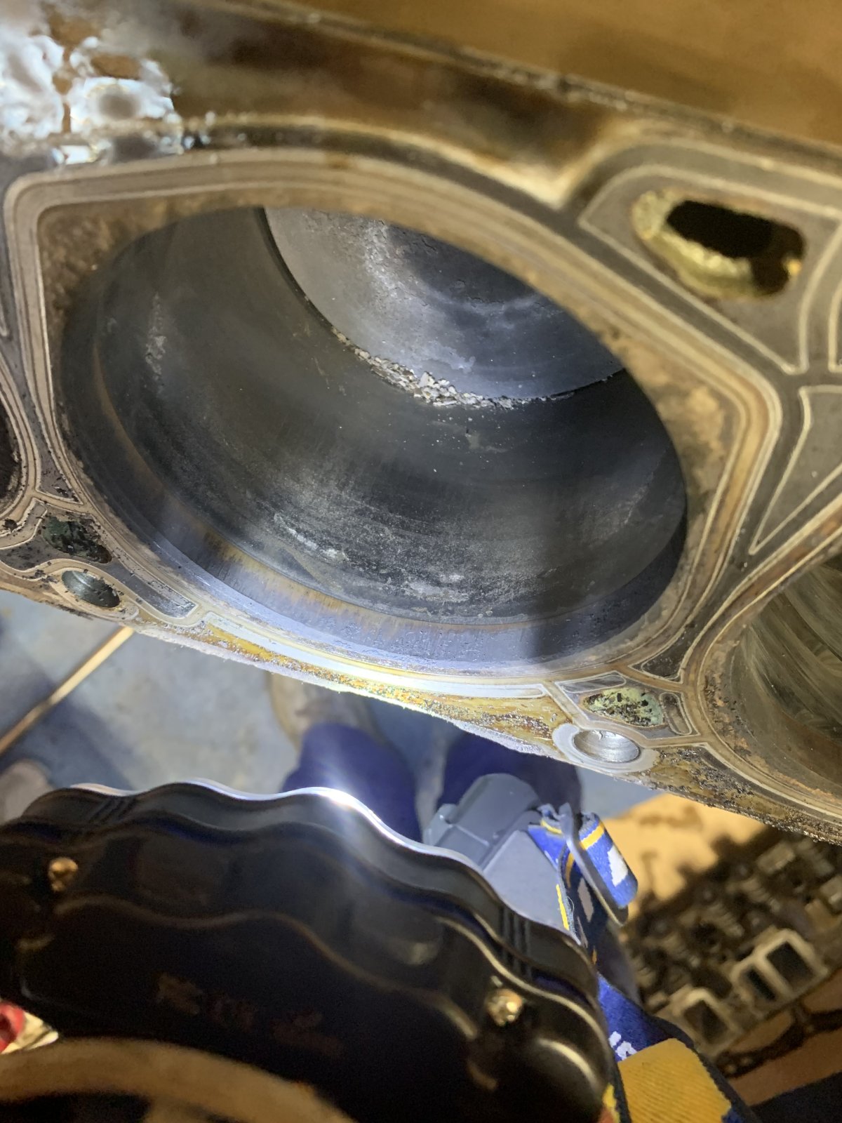

  23. bobss396
    Posts: 18,741
    bobss396
    Only one slug was involved? Check that cylinder and head carefully, something may have let coolant into the bore.
    Oneball likes this.

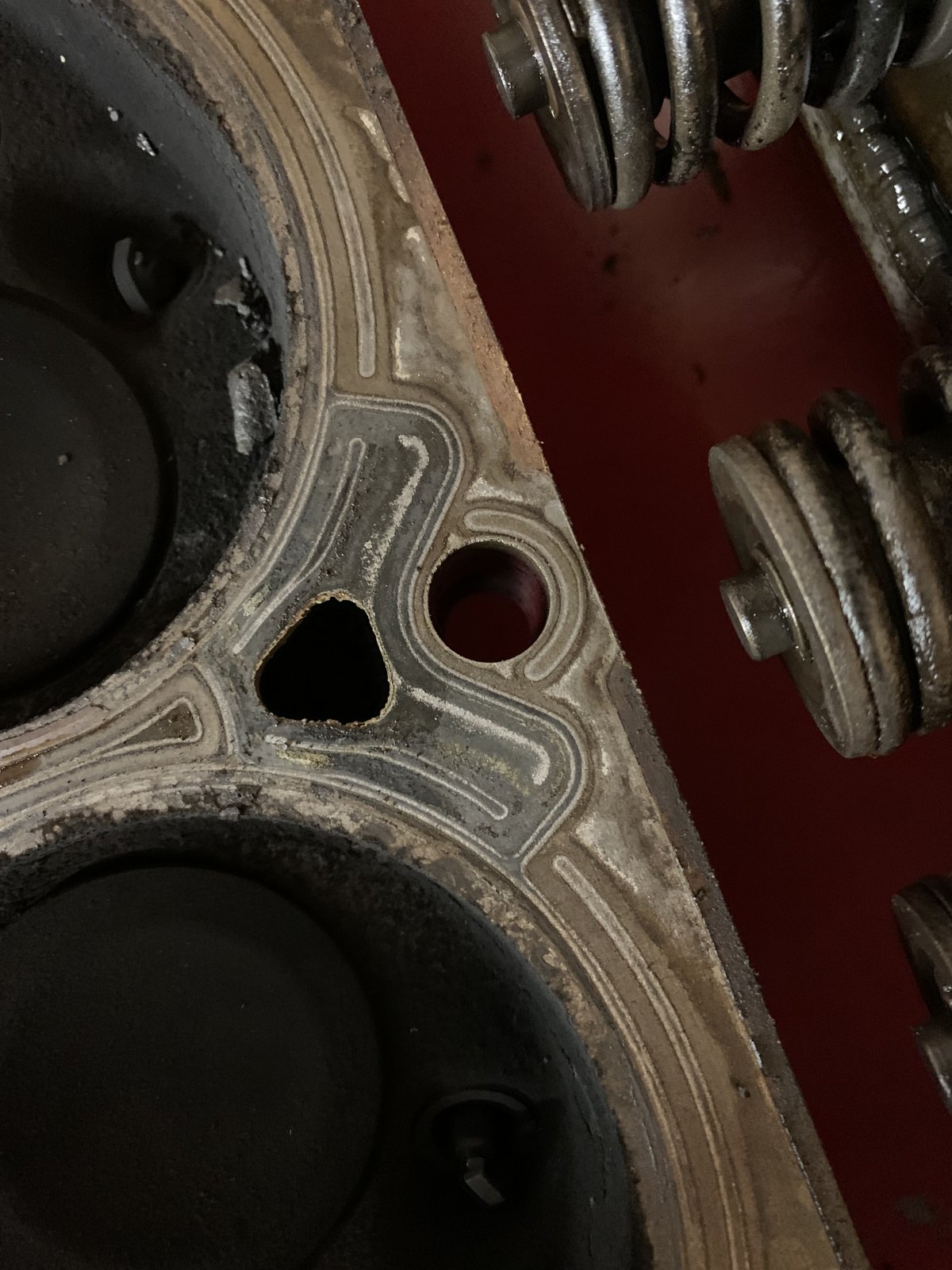

  24. Oneball
    Posts: 1,643
    Oneball
    Thanks, good tip. It does have two different head gaskets; a metal Ford one and one of those nasty silver fibre ones. Will have a proper clean and look tomorrow.
    Okie Pete and bobss396 like this.
  25. bobss396
    Posts: 18,741
    bobss396
    Which side was the bad slug on? Odd that someone would pull one head and not the other side too. On the "bad" side, look closely at the gasket for damage or sign of a water track.
    Oneball likes this.

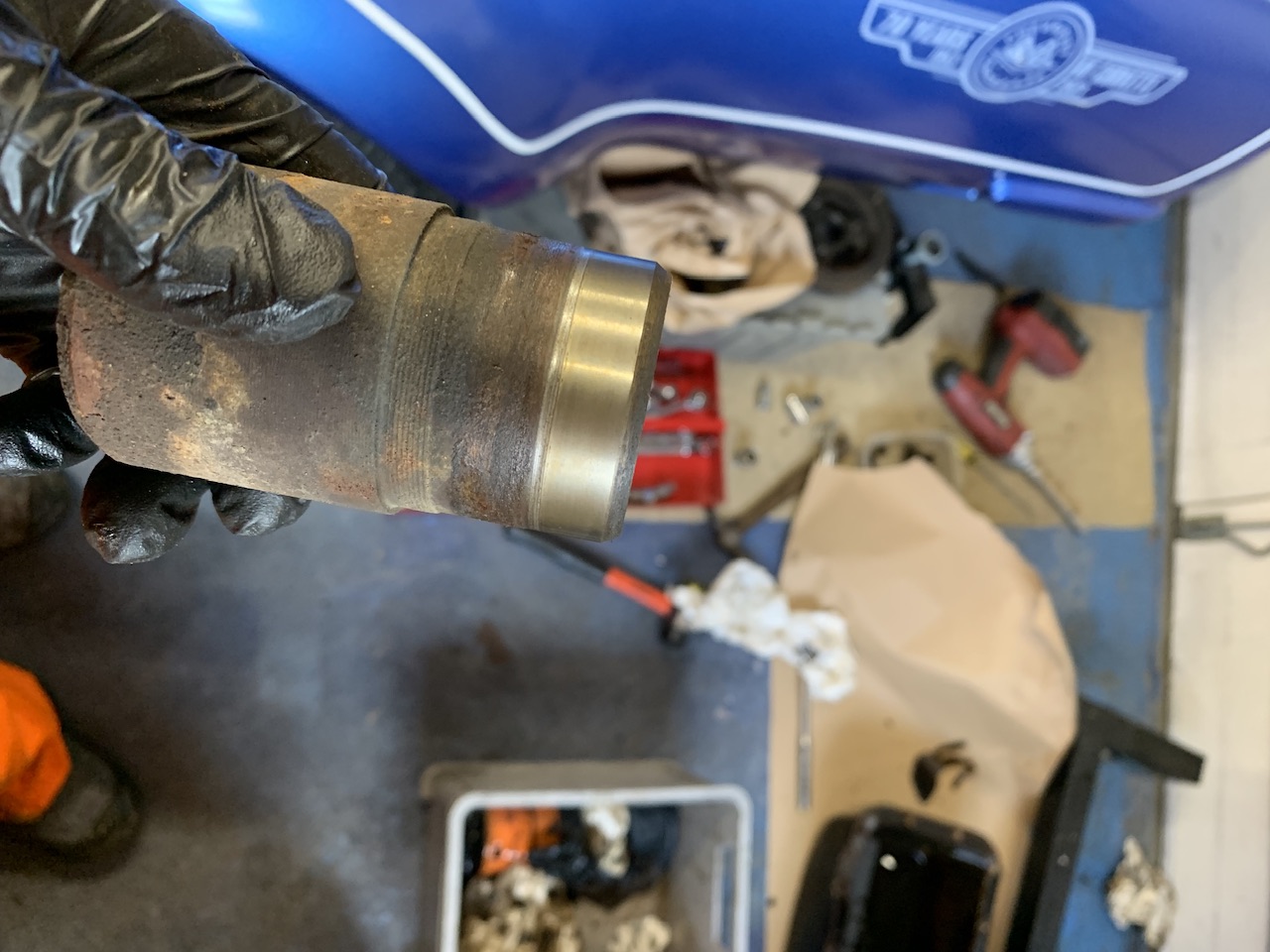

    Oneball
    Got the sump off and that piston out. Bearings look good, piston is ok, rings aren’t bad, if it wasn’t for the water I wouldn’t be doing anything. IMG_5929.jpeg IMG_5930.jpeg IMG_5932.jpeg
    About that water, it’s had a sump full by the looks of it at some point, that’s water dripping from the main’s bolt.
    This is on the original gasket side, the only bit of the gasket surface that might just might be compromised is this bit. And I’m sure
    The other option is the sump has had water in it because of a failed gasket on the other bank and this bore is wet via the carb. The air filter element was in upside down (they’re like a top hat) and there was evidence of water sitting in the air filter housing or there’s a crack in the bore but I think that’s really unlikely.

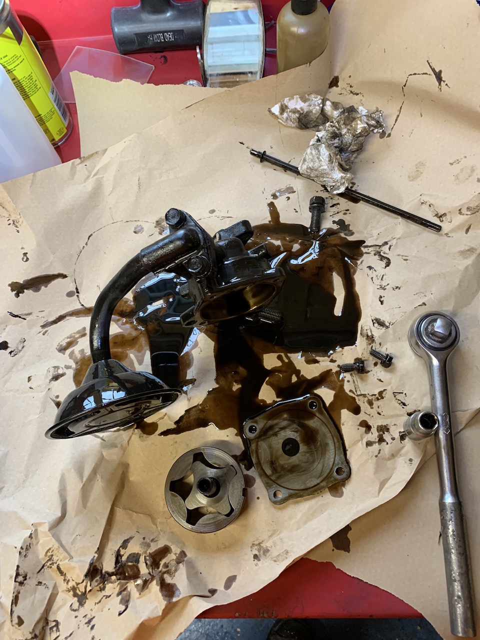

    Oil pump is a bit rough.

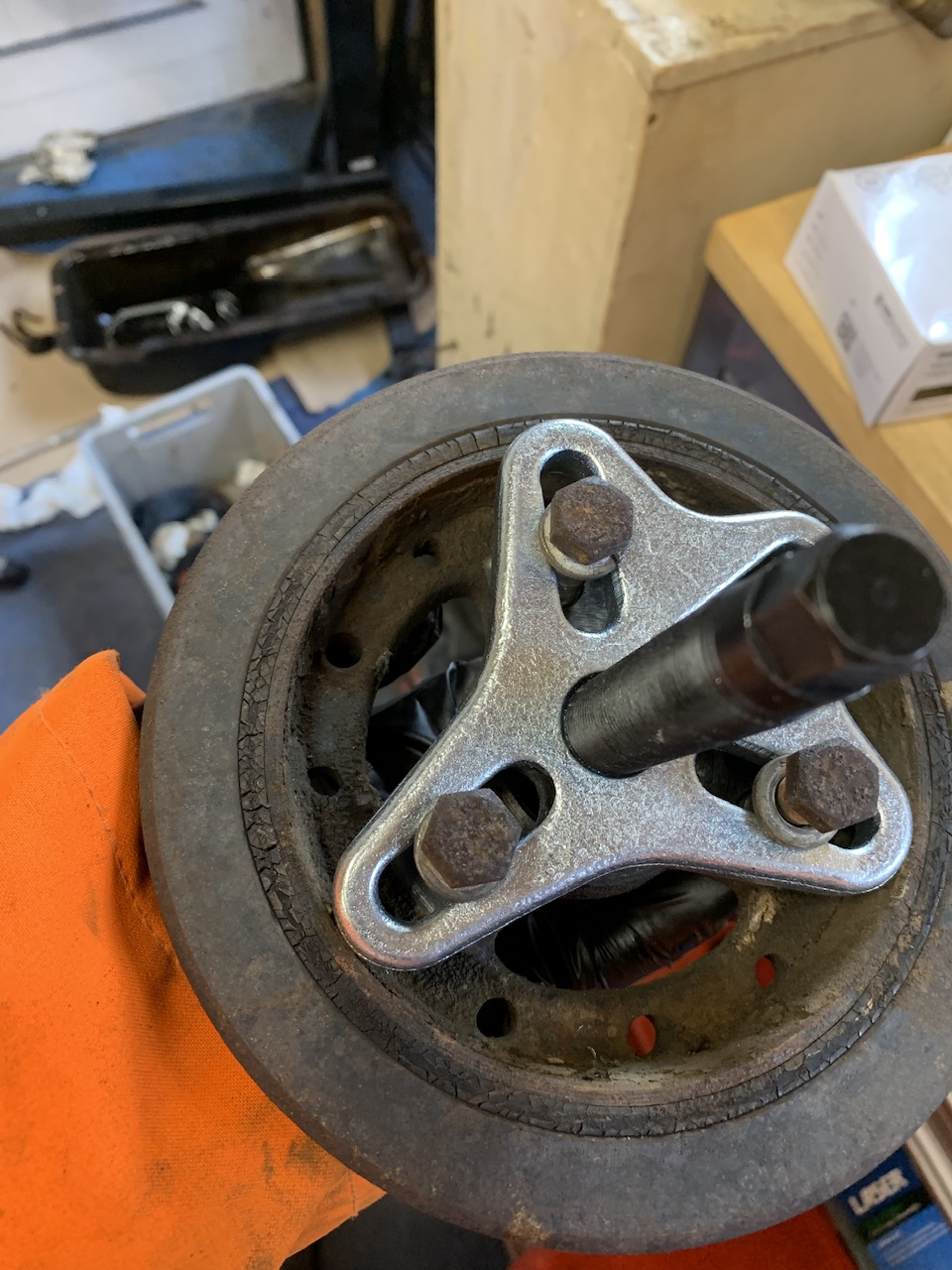

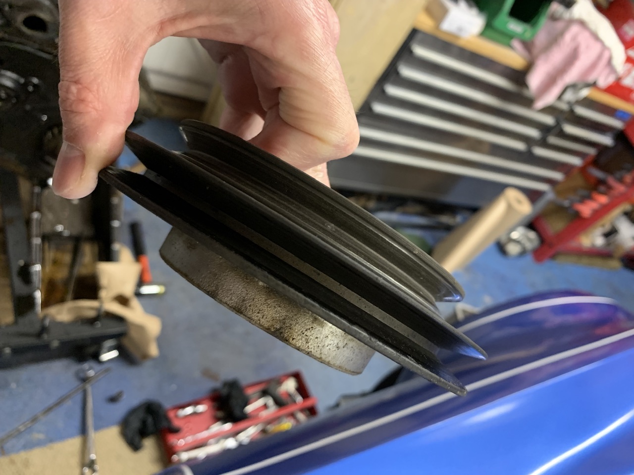

    Think I’ll change the pulley spacer as that groove will probably not be in the “right” place with a different seal
    And a new damper too.

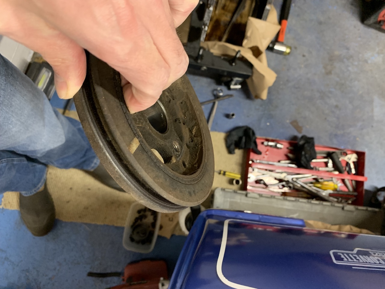

  28. Oneball
    Posts: 1,643
    Oneball

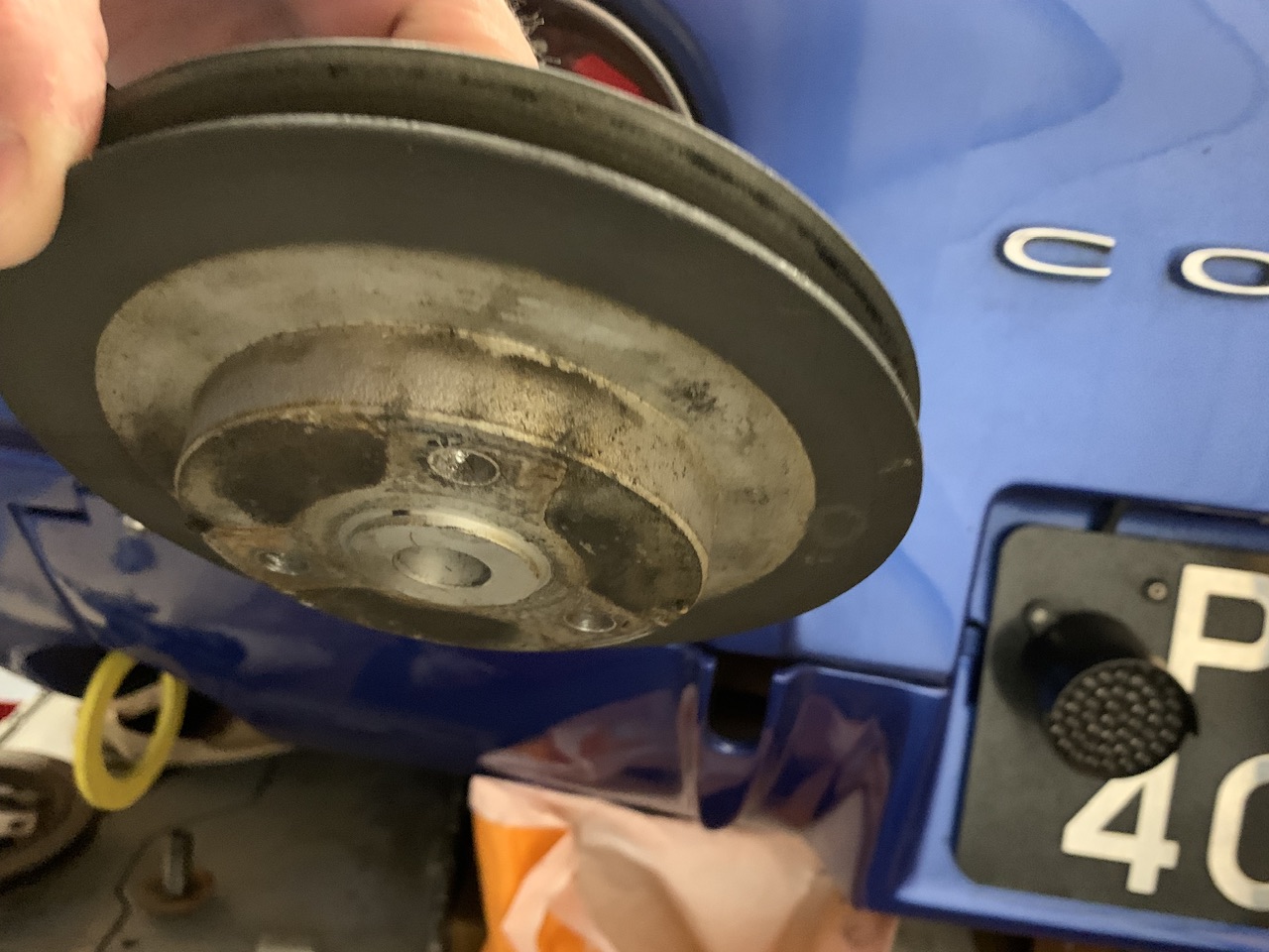

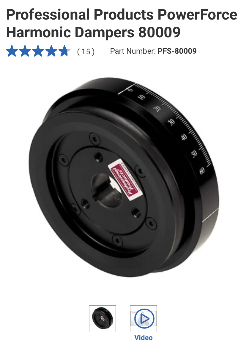

    I’m struggling to find a definite answer about balancers. Do the aftermarket ones allow you to bolt up the extra pulleys I have.
    Stock balancer has one pulley.
    Bolted to it is a two pulley arrangement for PAS and AC
    Can I use that with something like this
    bobss396 likes this.
  29. Pontmerc
    Joined: Jul 13, 2013
    Posts: 447
    Pontmerc
    from Finland
    When i replace damper in my 63 390, there was only 427 dampers avaible.it is bigger diameter but was direct bolt in.even came with new pointer for advance.
    So yes, that should work.
    Oneball likes this.
