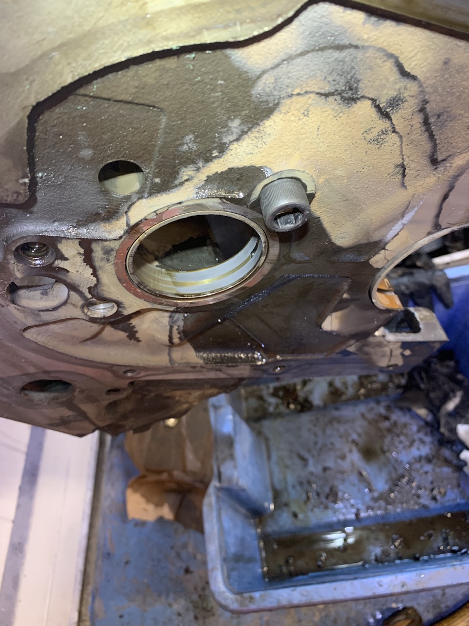

  1. You can re-use that pulley spacer, by installing a speedi-sleeve. It presses on, and gives the new seal a smooth place to ride.

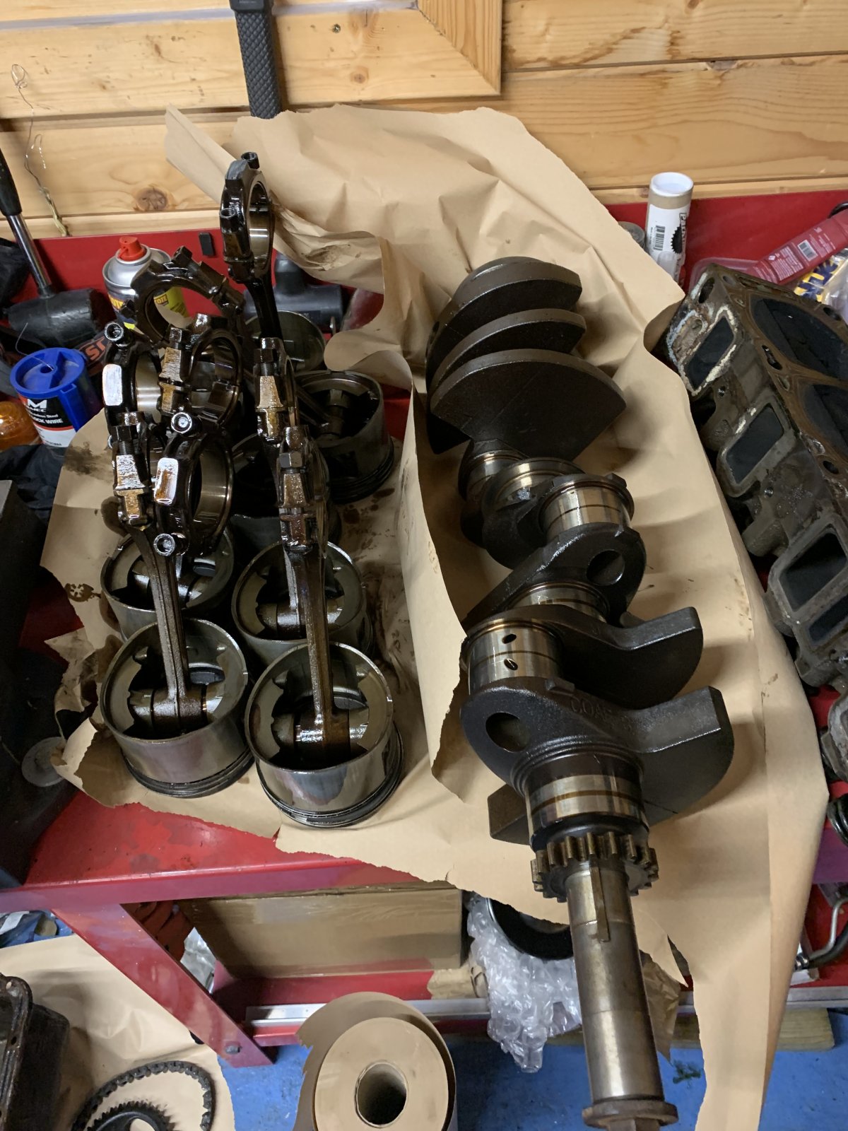

    Bottom end all stripped. Crank looks tidy.

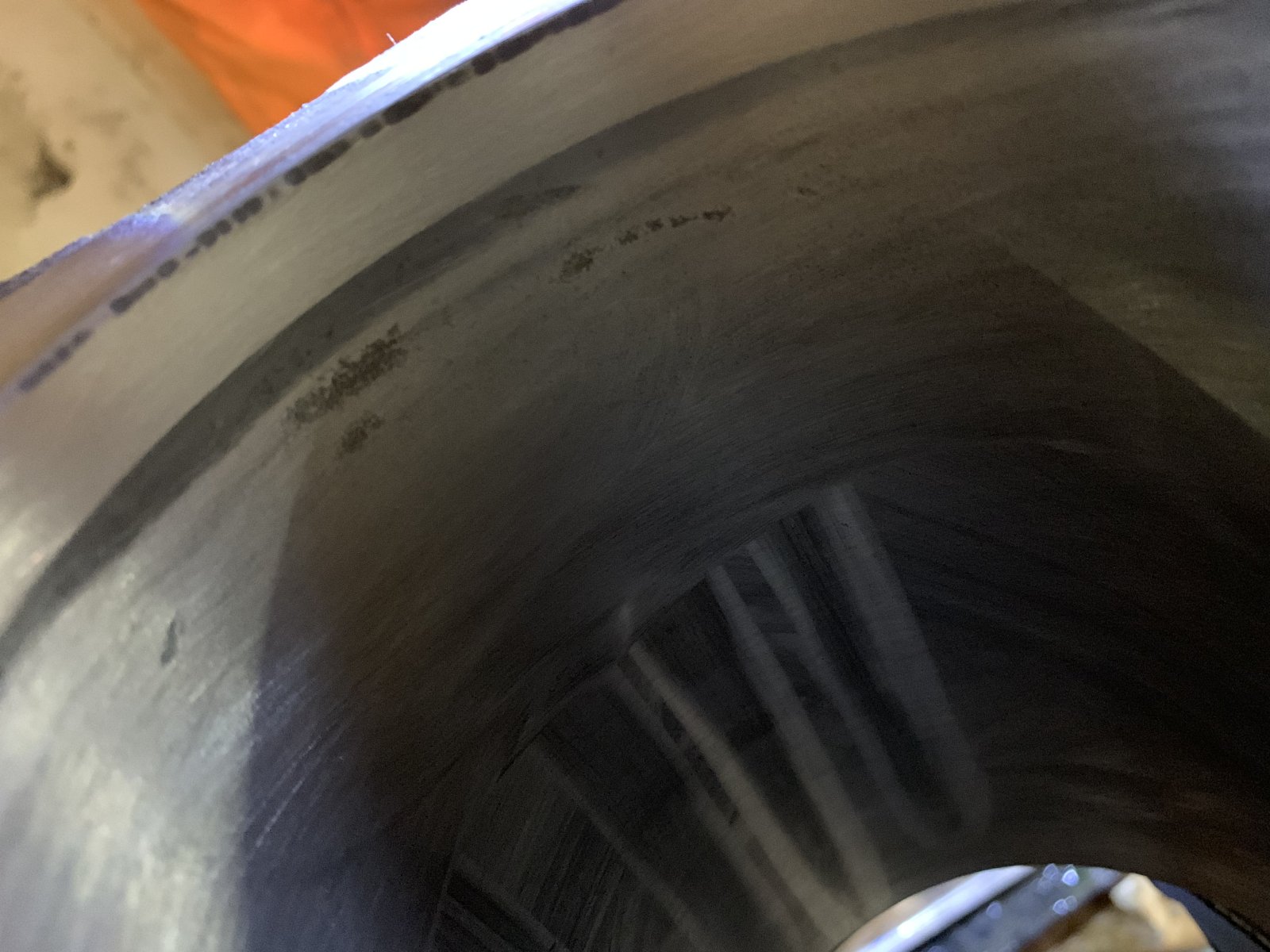

    Ran a hone down the iffy bore, still iffy! Will hopefully get back in time tomorrow to have a better go in daylight. Whatever an electrician tells you is a good number of lights in your garage, double it.

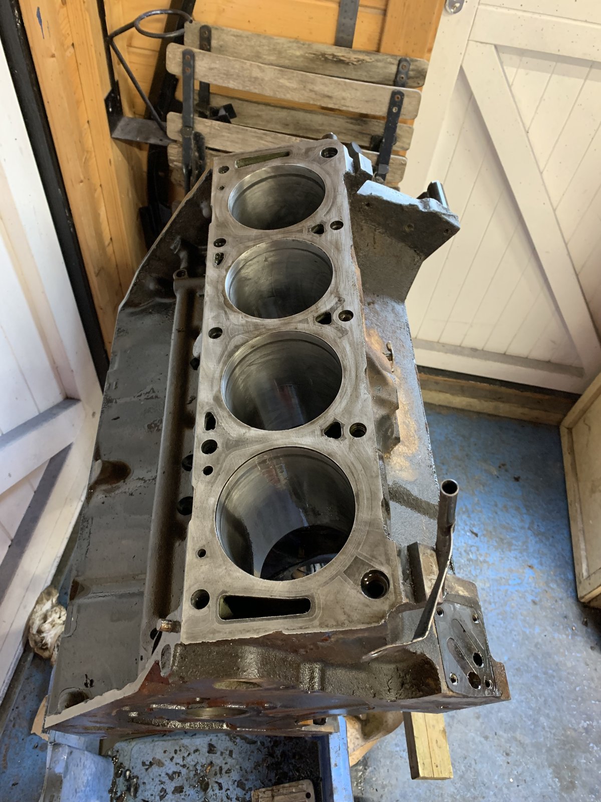

    If the "iffy" cylinder and piston were caused by coolant or water finding its way into that one bore, usually it should be pretty visually obvious. The combustion chamber, valves and the top of the piston tend to look like they've been steam cleaned with hardly any trace of carbon or other deposits. As for the water in the crankcase, make sure the PCV system is intact and working as it should.

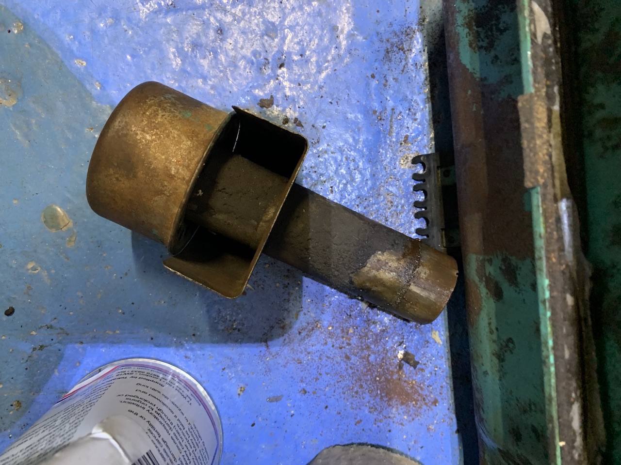

    I think whatever happened was a while ago as all the valves, piston tops, combustion chambers look the same and are just carbon-y from running to rich, the choke heater tube is blocked. That also means it’s not really been burning oil so fingers crossed some new cast rings and a hone will see it good.
    No PCV on this just a road draft tube but I’m going to fit a PCV system when it goes back together.

    Everything is honed or at least honed as far as I’m willing to go. There’s nothing particularly bad left, there’s still some pitting in the one pot but it’s going to be better than before which seemed ok.
    Took forever, my coordination is ******ed since my accident, can’t do one thing with one hand and something else with the other.
    Cleaned the top of the block too. Just a couple more gaskets to come off and tap the front oil ways for fitting the later style cam thrust plate. Then clean and paint.

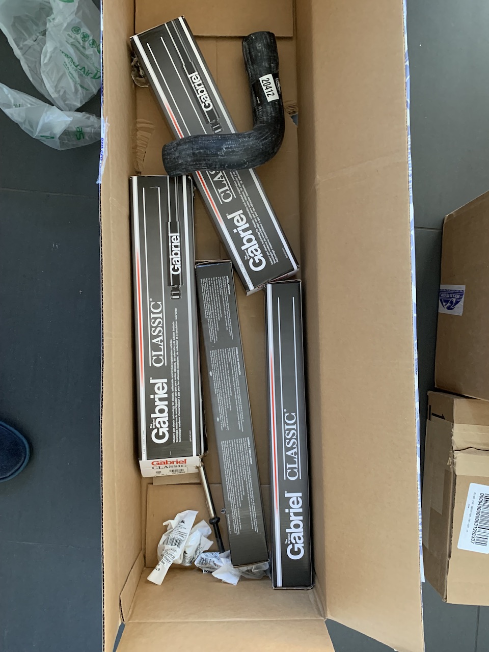

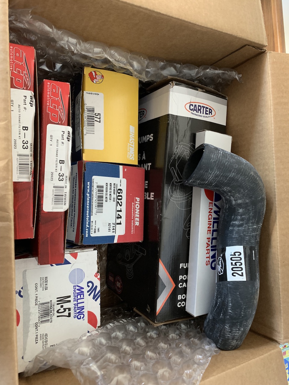

    Loads of bits turned up today. IMG_6044.jpeg IMG_6047.jpeg IMG_6046.jpeg IMG_6045.jpeg
    Still waiting on the custom cam I ordered in November though, don’t really want to put it together till I get that as I’d like to put the cam in first for ease.
    Modified the block to take a cam thrust plate; removed the two oil way plugs and tapped to 7/16-14.
    Really didn’t like the amount of thread engagement available to give sufficient clearance to the oil feed to the bottom of the dissy so modified it to give the oil room to p*** a longer bolt.
    williebill likes this.

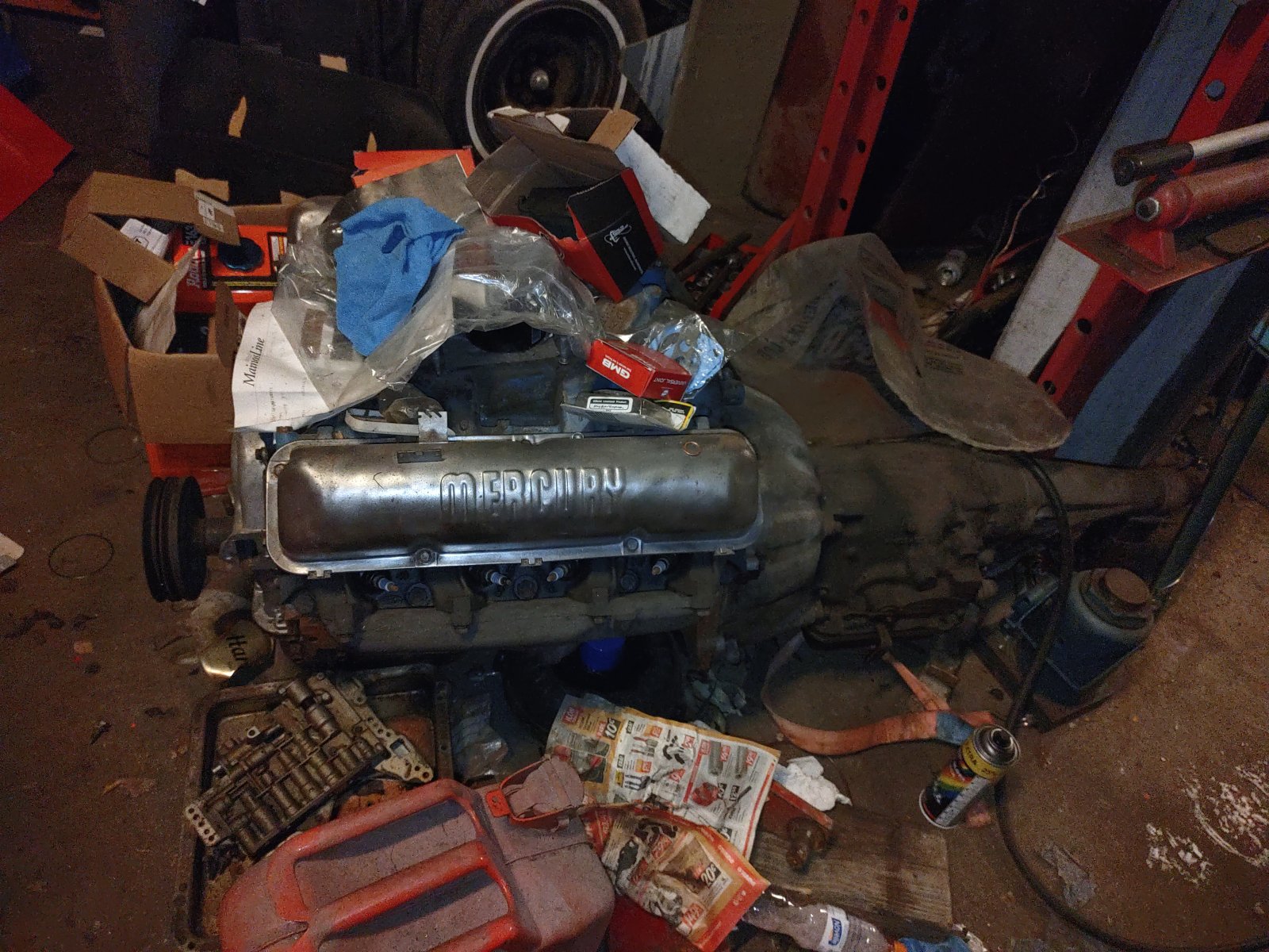

    Myself, im some cases very lazy ***.
    This full overhauled overbored line bored etc 390 has wait allmost 2 years to go in my colony park.
    I dropped it on the ground and dent oil
    pan and that piss me off very baddly and its still waits new inspiration. 17053358064632740562739448464296.jpg

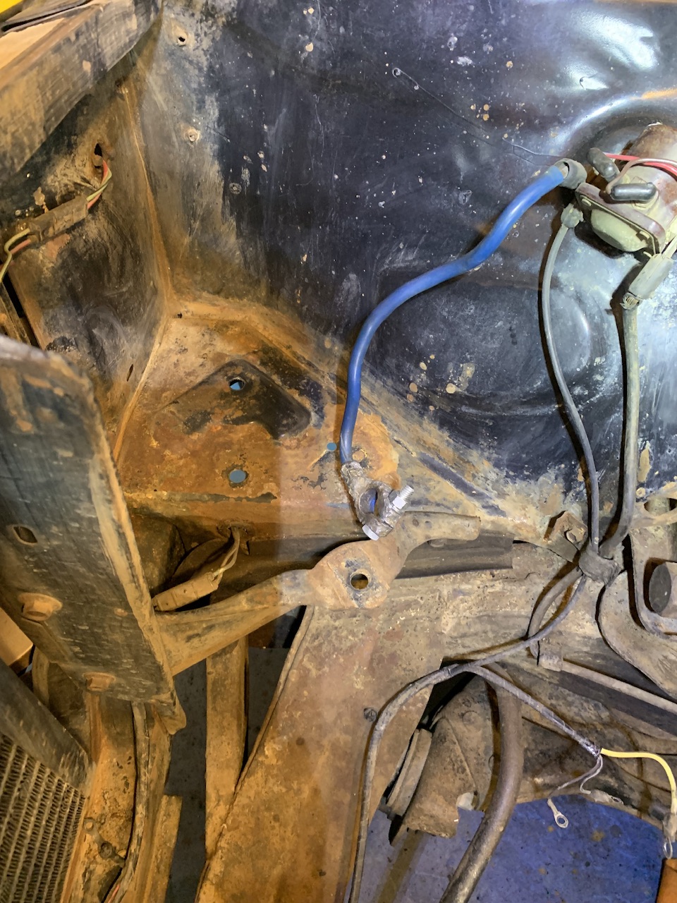

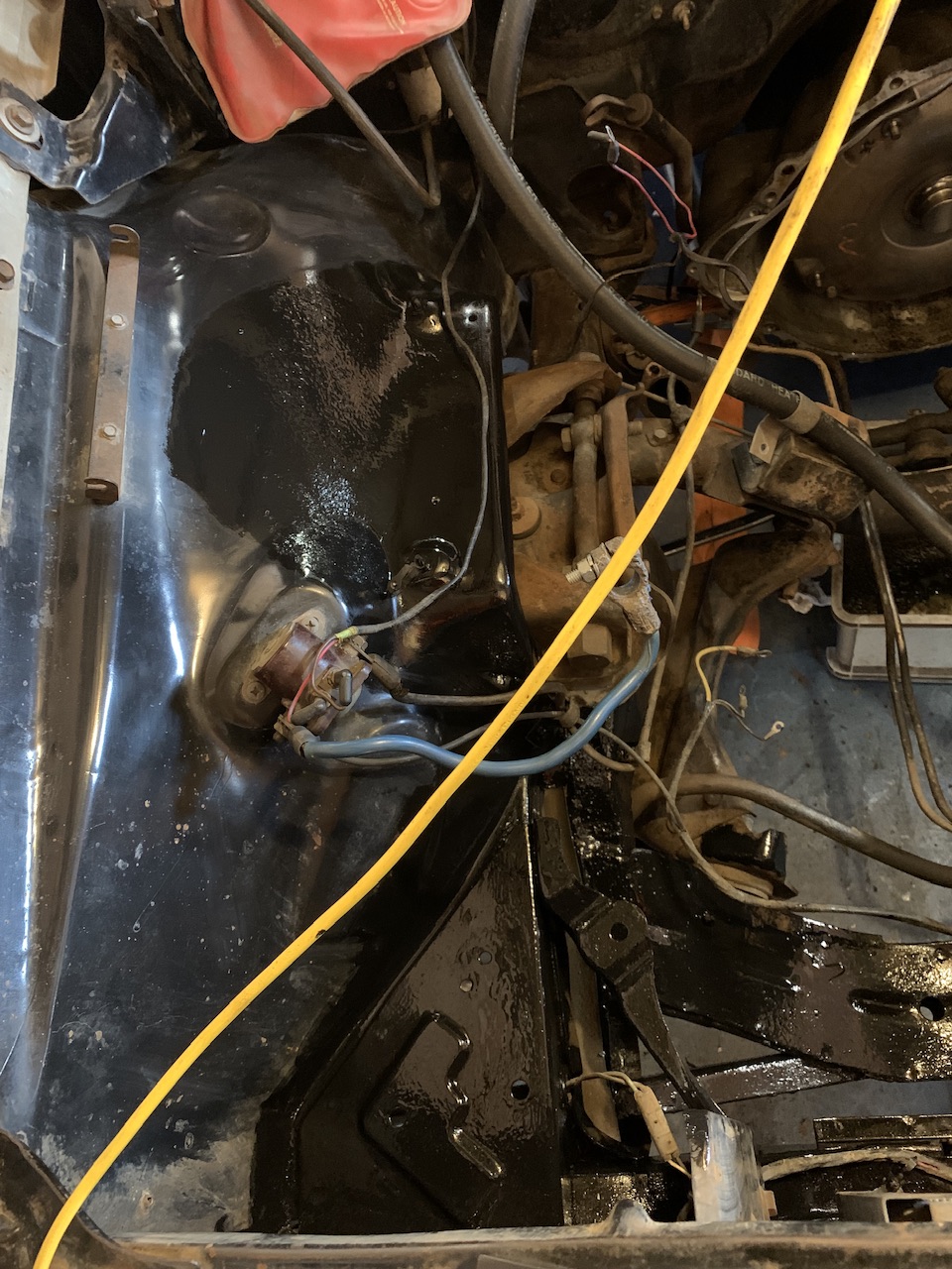

    Managed to get the oil filler tube out of the original manifold without completely ******ing it, which I thought was a bit of a win.

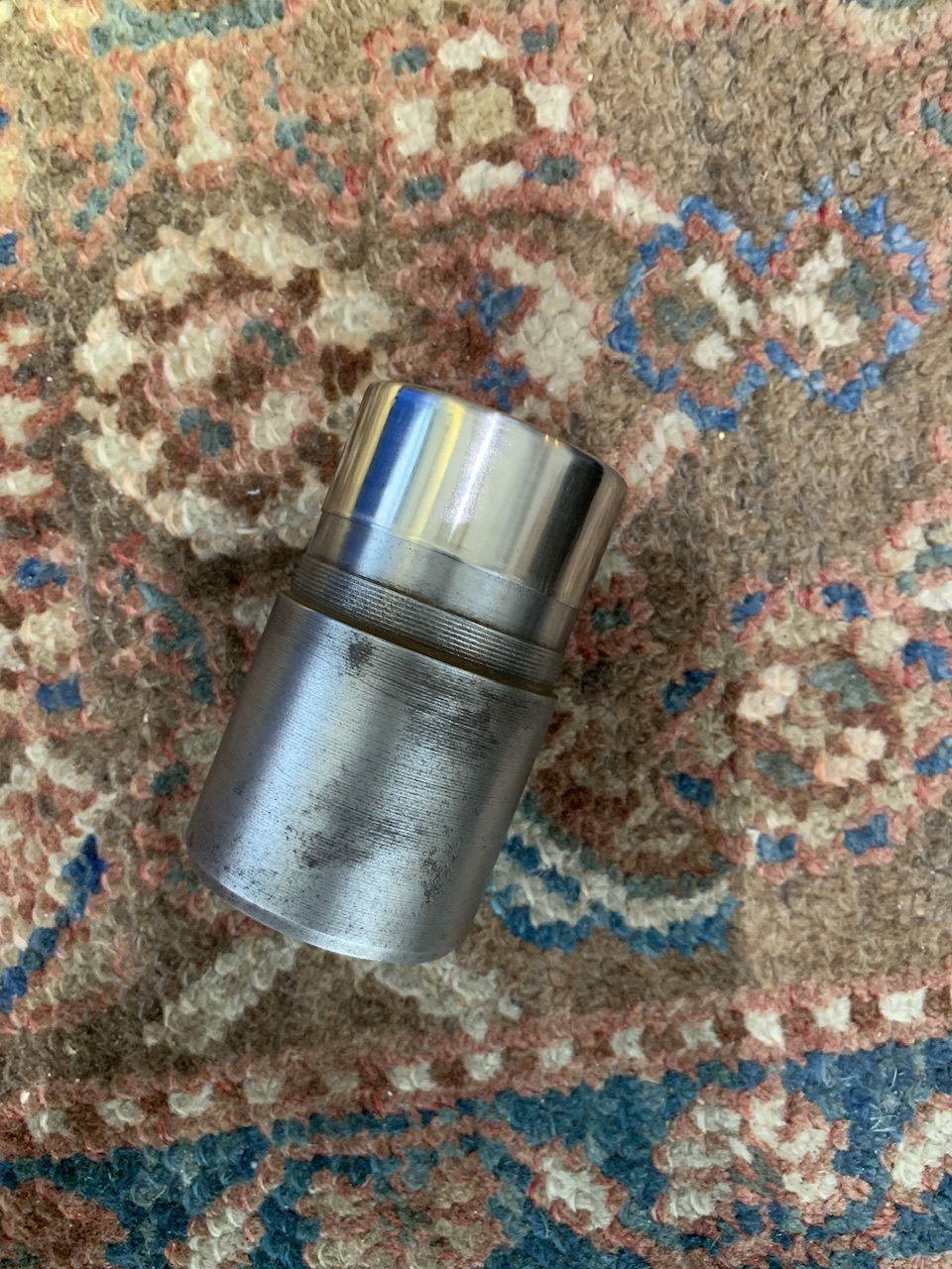

    Put a sleeve over the crank damper spacer, fingers crossed.
    And cleaned and painted the bit of rust under the washer bag and battery tray.

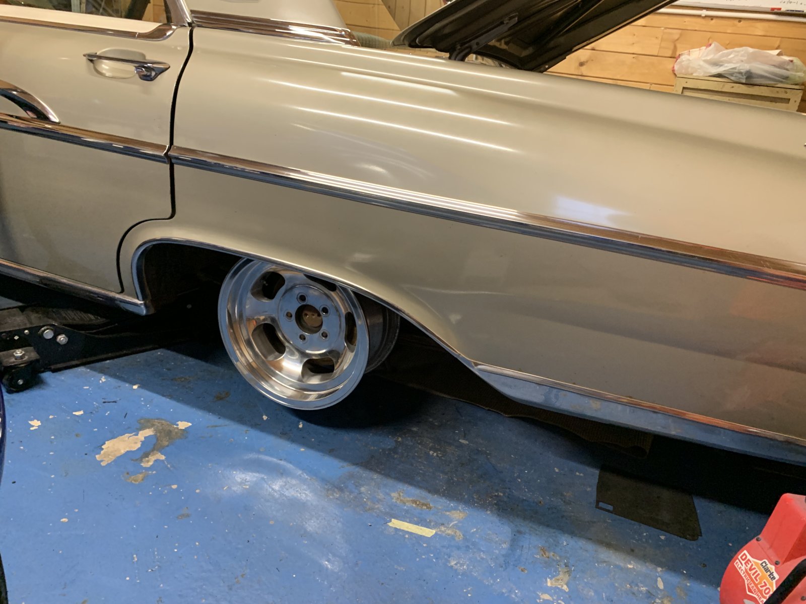

    Looking for a bit of advice on tyre sizes. I’ve got some 15”x7” slot mags for it, what’s the thought on 215 vs 225?

  16. A 215/70R-15 will be very close to the same diameter as the OEM 14" tires @ 27". A 225 will be slightly oversized. If you want more 'meat' on the back, a 255/60R-15 will 'match' the 215 fronts for diameter but you'll need to measure wheel backspacing to ensure clearance. A 4.25" backspace should center the tires in the wheelwell.
    Unlike the '50s era Fords/Mercs, the '60-64 cars have roomy wheelwells, you could fit even larger/wider if wanted with the right wheels. I've got 235/60-15 front on 15X7 and 275/60-15 rear on 15X8 on my '60 Ford, they clear without rubbing with a 4.25" backspace. I calculated that even a 295/50R-15 would fit in the rear but would need a custom backspace of 5.25" on a 15X10 wheel for clearance.

    Thanks @Crazy Steve that kinda confirms what I was thinking. Probably go with 215.

    I run a 235-15 on the back of my car. Getting them off is a bit of a chore, they fill up the wheel well quite a bit. I run 215-15 up front.

    I might get a couple of 215 fitted that’ll be for the front and see what they look like on the back before getting another 2.

    They should be fine. My front is dropped a little (cut coils) and the tires will hit the inner fenders at times. The disc brake kit shoots the wheels outward just enough.

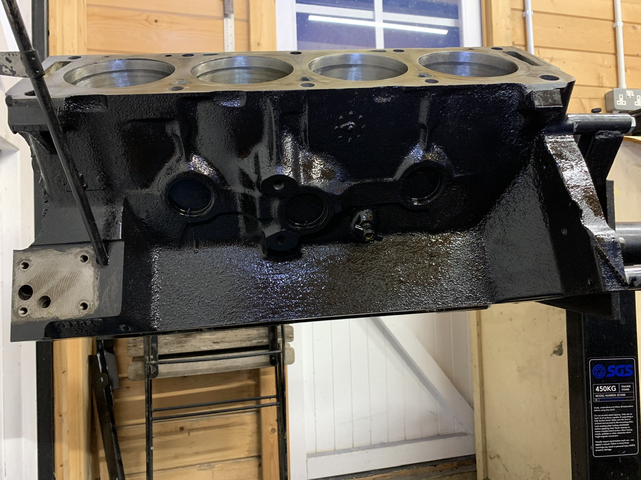

    Finally got above freezing here so dug the jet wash out and cleaned and painted the block.
