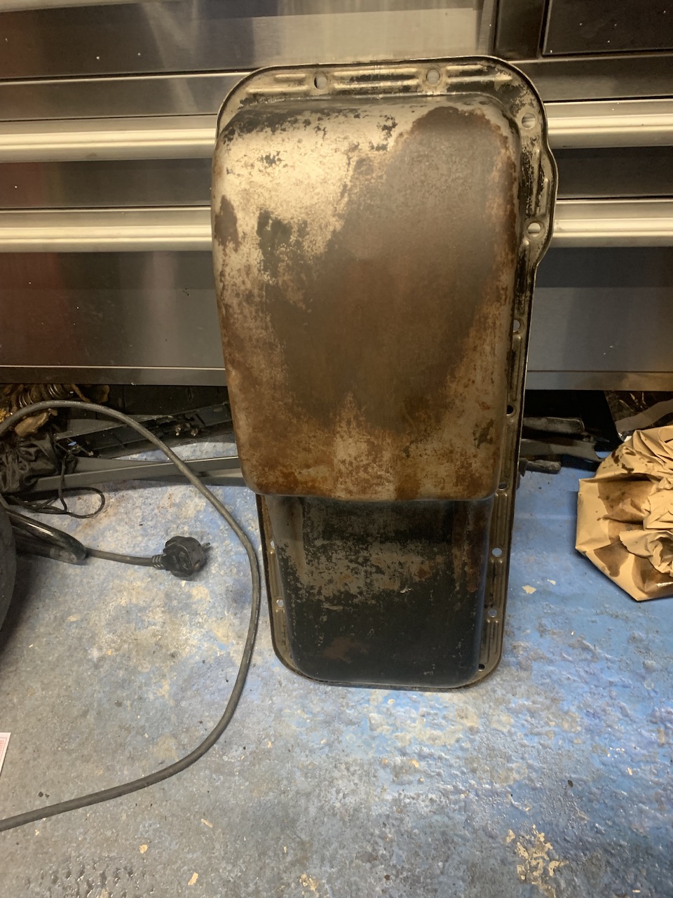

    Almost over the hill of cleaning gritty, oily, concrete encrusted crud if everything I’m also sure someone’s Labrador has been shredded under here at some point there was a lot of fur stuck to the sump!

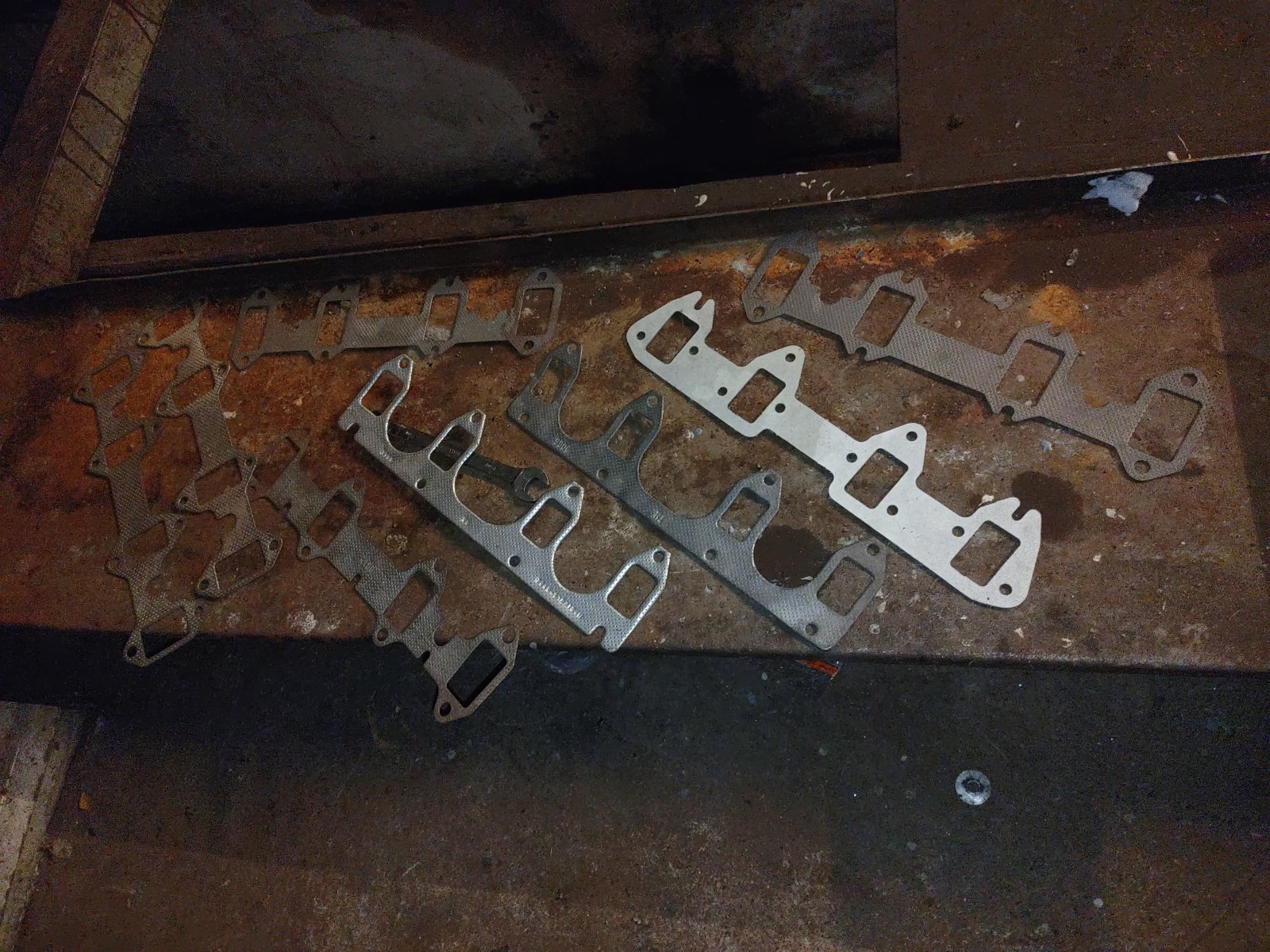

    Hey, if you are a true fe owner, you gotta habe few extra exh gaskets, or do it right and resurface head and manifold and not use any gasket. 17061129660211514966552687099286.jpg

    I had my 352 exhaust head surfaces milled up and the fit is proper,.. no exhaust leaks.
    Yes.. the die hard FE guys will tell you no exhaust gaskets.... but its a royal PIA when there is and the engine is ***embled and in your car.
    I opted for a very popular gasket from Remflex. They seem to be a favourite in the FE circles I know.
    It's simply your choice.
    http://catalog.remflex.com/category_s/97.htm
  6. Oneball
    Joined: Jul 30, 2023
    Posts: 1,644
    Oneball
    Thanks both, it’s definitely getting gaskets, not going with Henry Jr’s penny pitching idea! I’d seen those Remflex ones in a Mustang place over here then promptly forgotten about them.

    I used to make my own gaskets from leftover dead-soft copper at work. Around .050" thick worked well and deformed while it was socked down.

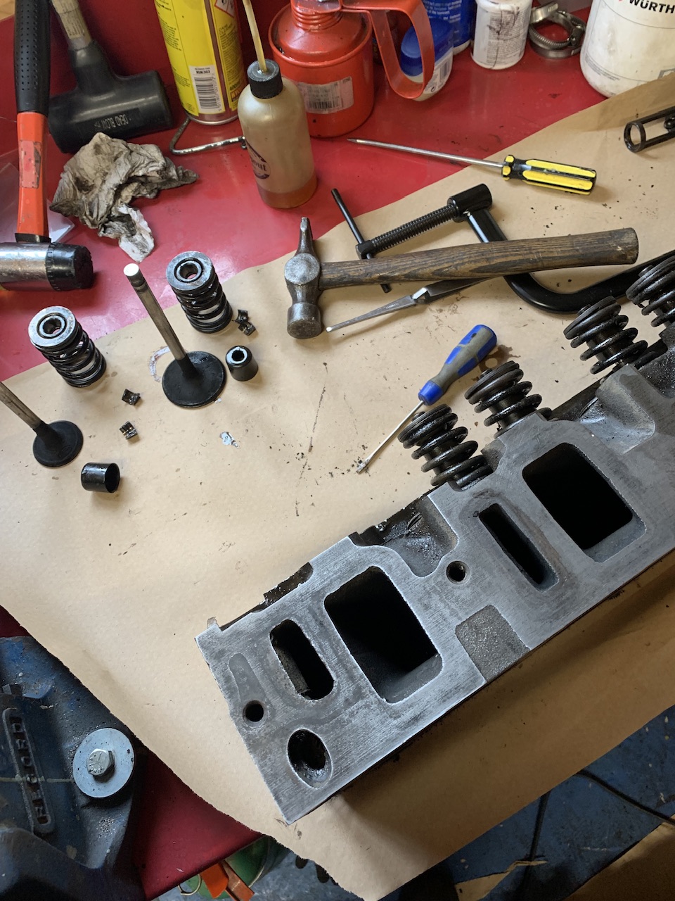

    Guides, especially the exhaust, aren’t good. Was hoping to get away with just lapping the valves in. ******! Will see if I can get them down the engine place tomorrow.

    There’s some of the perforated metal ones in the gasket set, I’ll give those a try. They’re quite thick and squidgy.

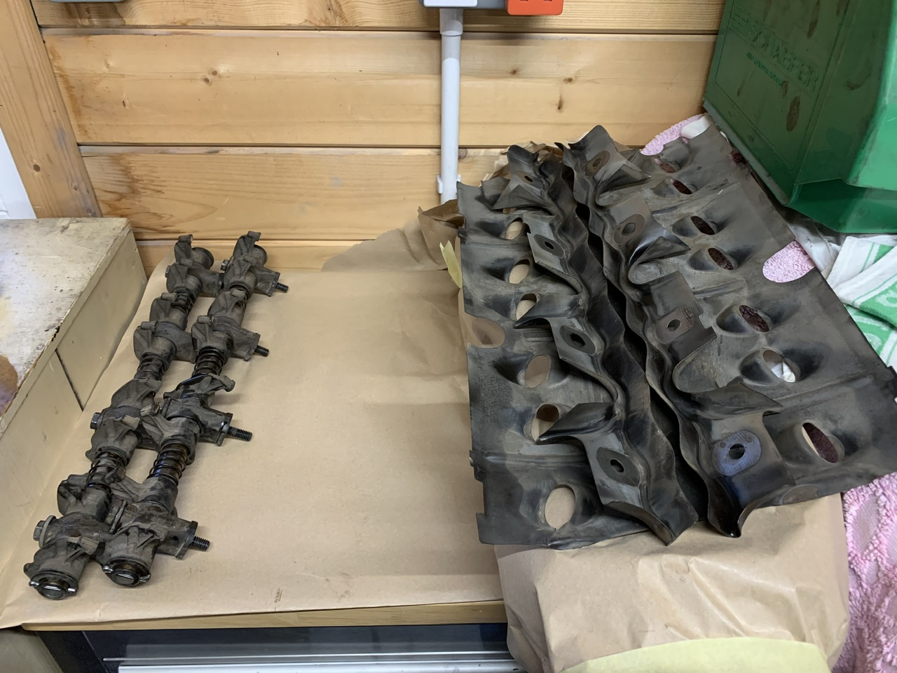

    Dropped the heads off at the engine place, dumped them straight in the parts washer, saves me a job! They’re going to strip and ***ess whether it needs valves as well as guides and a seat job.

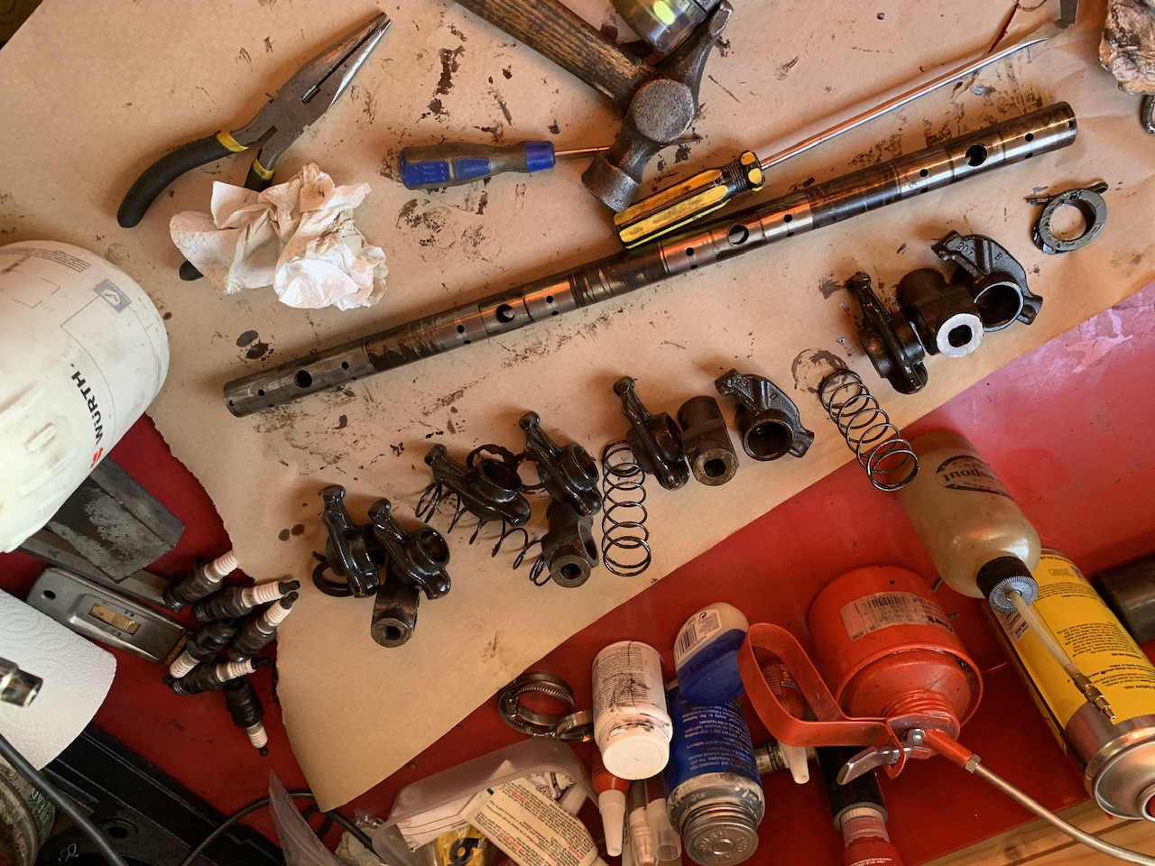

    Go one of the rocker shafts apart for cleaning
    Knocked the plugs out of the shaft and cleaned the gloop out of the inside, really glad someone else is doing the heads!
    Stopped off at the paint place on the way home and got some paint for the rocker covers. Um’d and Ah’d about this for a while. Gold seems the go to colour but I didn’t think it’d be a good choice with the car being gold too. I liked the contrast of the original bluey green so I’ve chosen a bright turquoise.

    Those perforated metal gaskets has not hold very good in long run.just my personal experience.
    Do as you like.you been warned.

    I’ve always thrown them in the bin, but someone said they worked quite well so thought I’d give them a try.

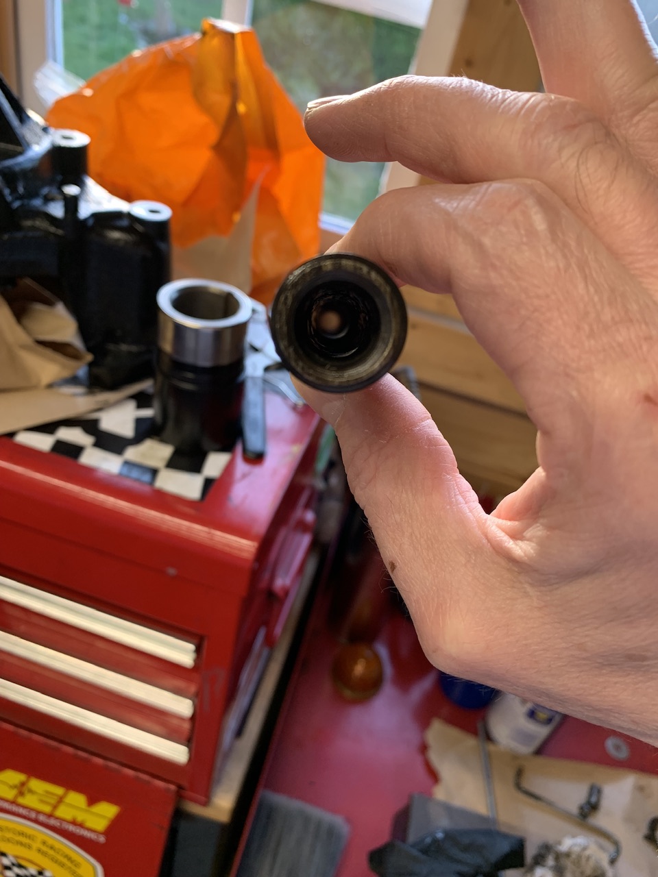

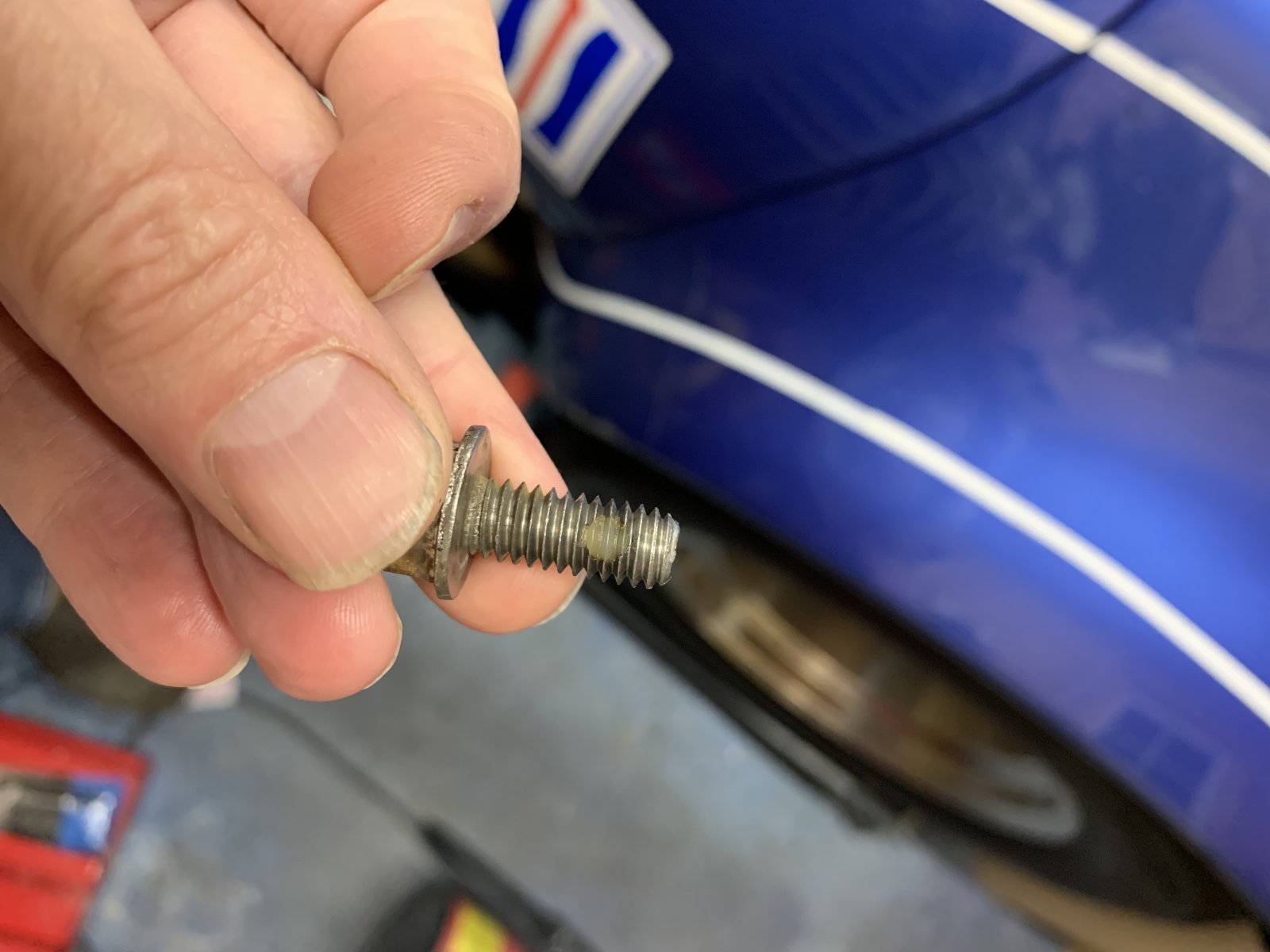

    One thing I noticed that I’ve never seen on anything before is the timing cover bolts have a plastic insert, I’m guessing to make them shakeproof.

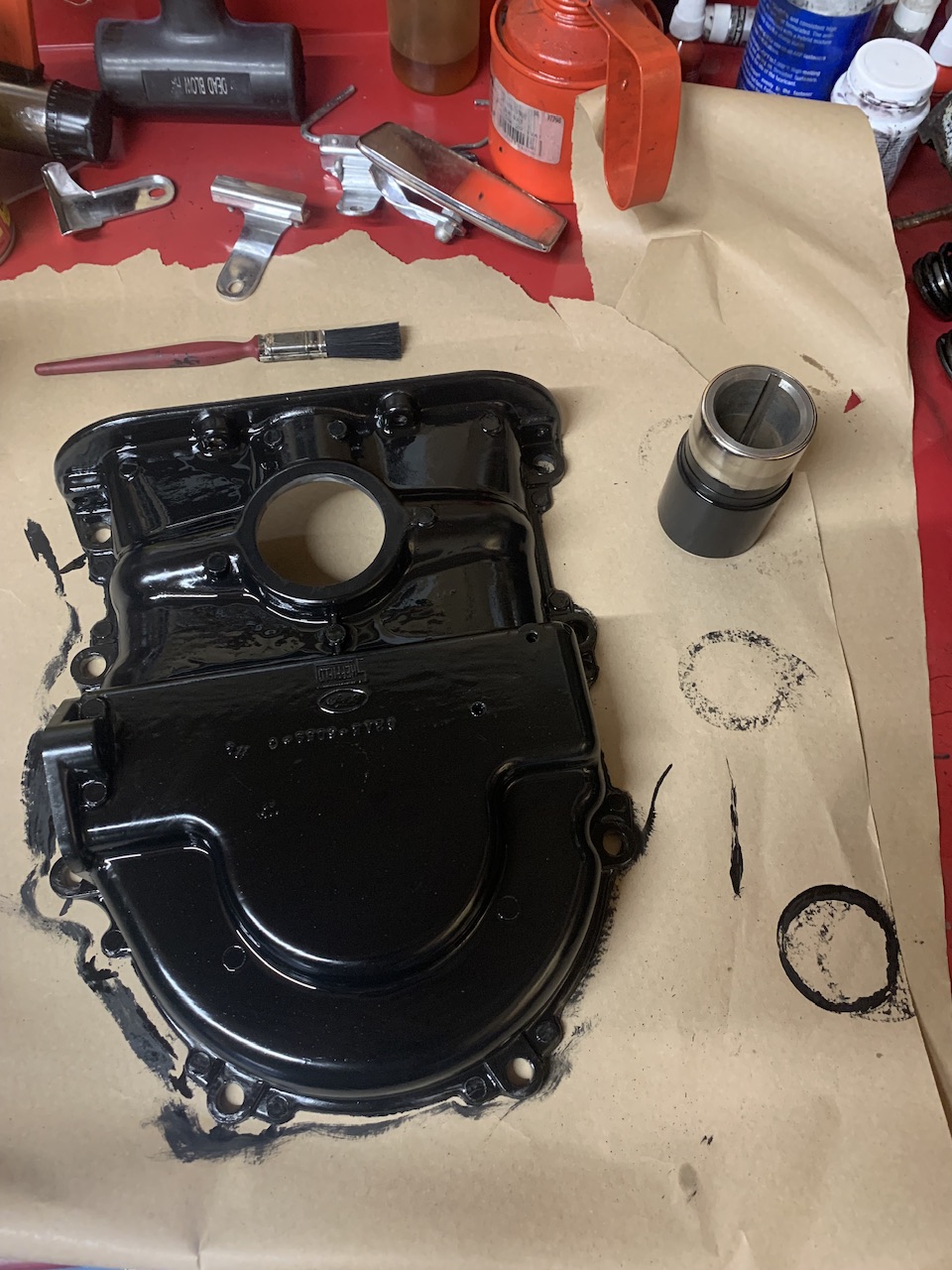

    Tried out the paint for the rocker cover paint.
    After painting the oil filler tube I realised I’d not actually tried it in the Offenhauser intake. I’m ***uming they’re a stock size?
