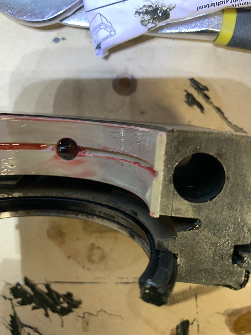

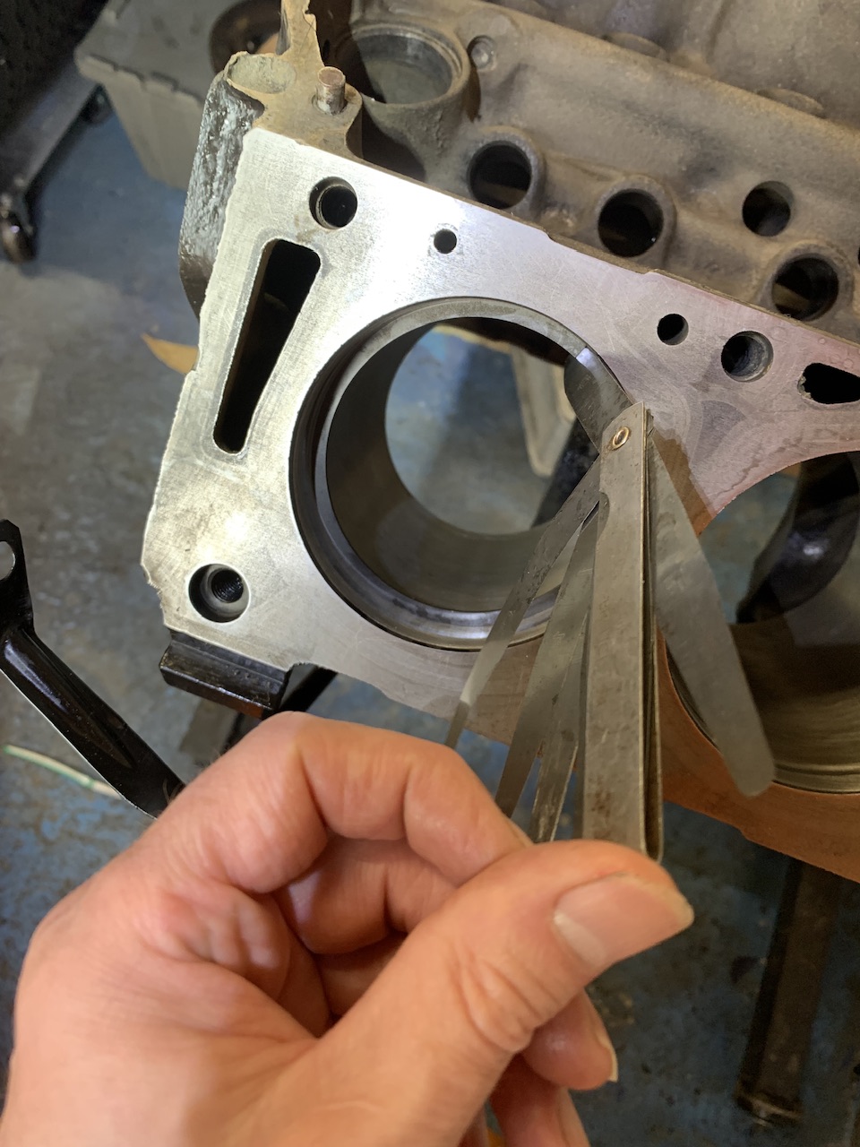

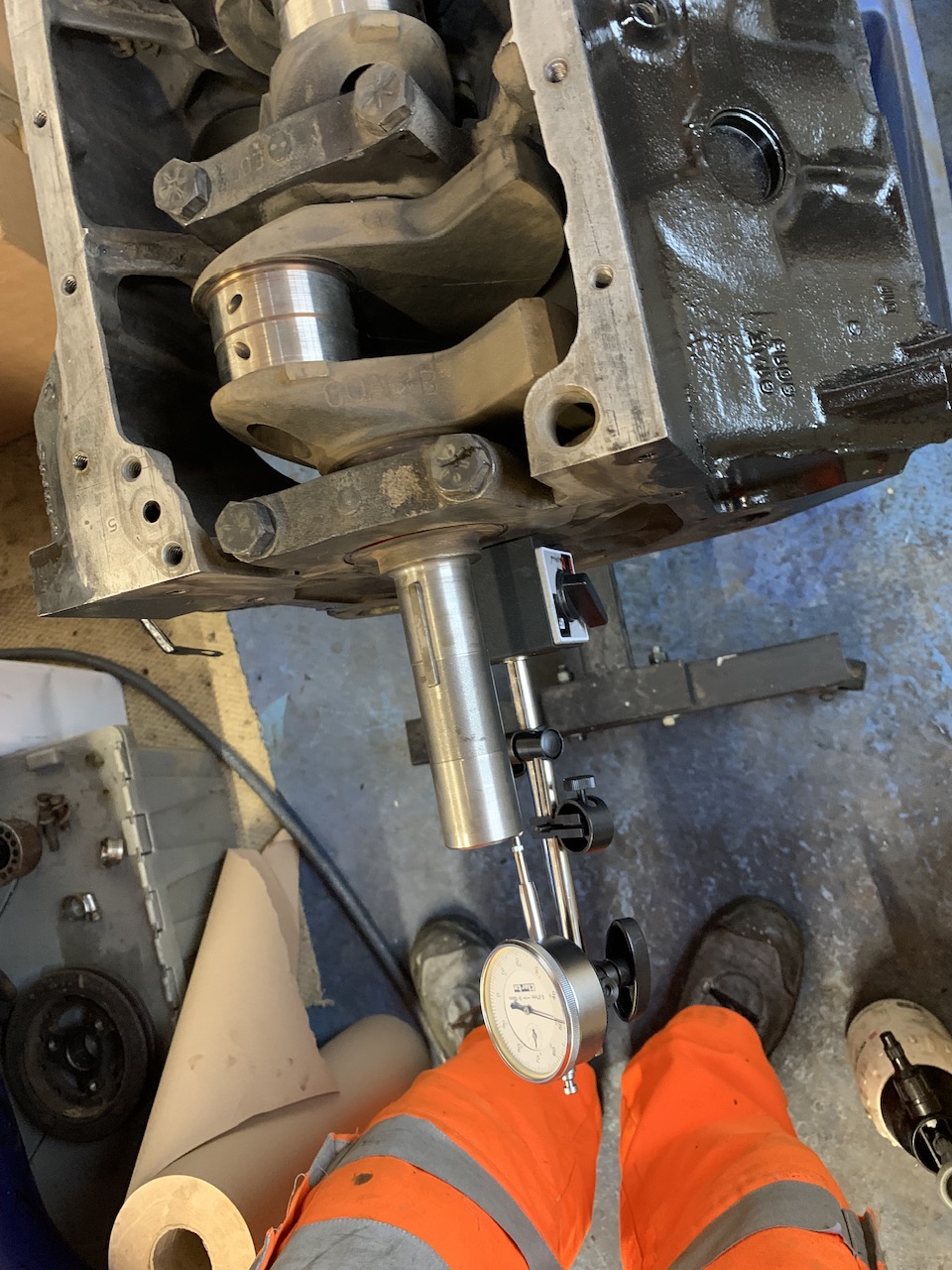

    So the registration office want to come and inspect the car in 3 weeks and it need to be complete :eek:
    Checked ring gaps
    And put the crank in, those rear main cap seals are a ****** stupid idea!
    I had to pull the rear main cap as the side seal didn’t seem right, at which point the crank seal fell out. Put the main cap back on, and all the seal gubbins and checked the end float
    At which point I couldn’t remember if I’d put the rear main seal in the right way, FFS, so took the main cap off again! Yep I had put it in right but this time I took a photo so I didn’t question myself.
    Did I mention how stupid those rear main cap seals are! :mad:
    Jeff Norwell and guthriesmith like this.

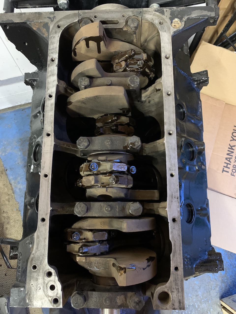

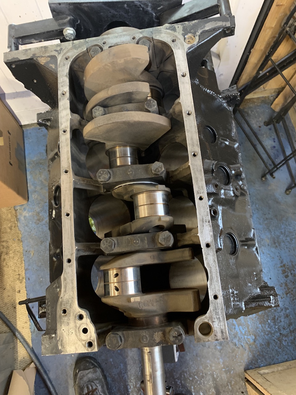

    Oneball
    Bottom end together.

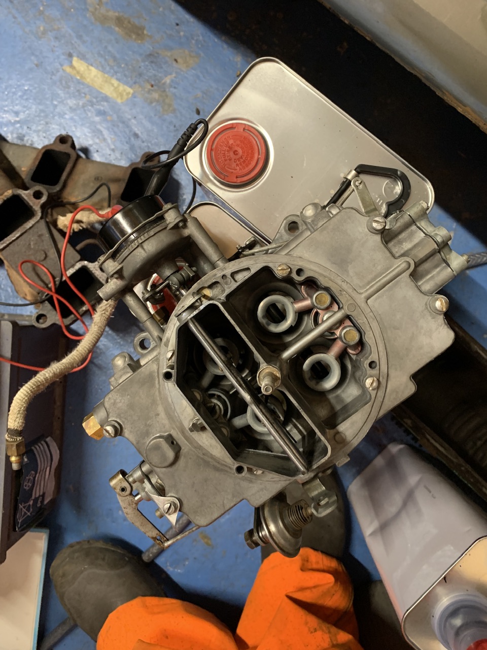

    4 mins from closed to open, we’ll go with that. Just need to block the choke suction port and set some bits up and the 4bbl will be good to go.

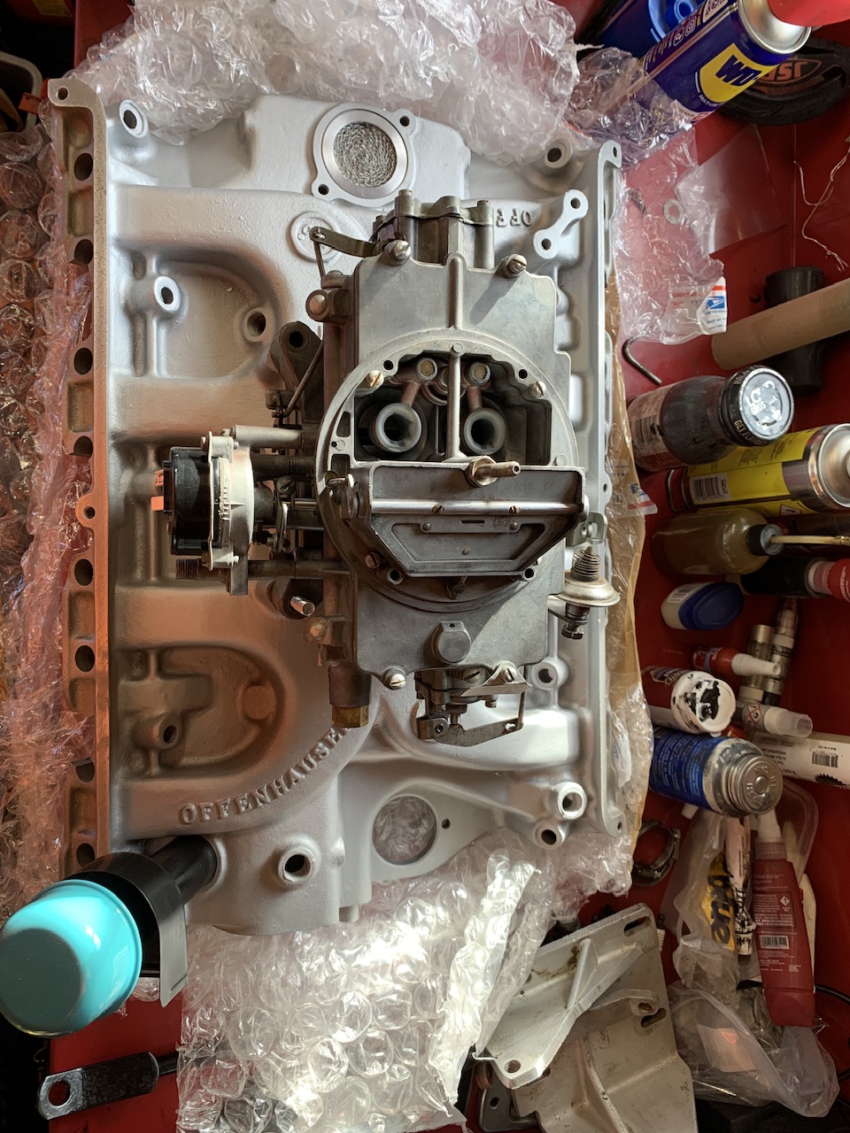

    Did some trial fitting with the intake. Possibly a controversial choice if you read the internet but I like the idea behind it. Plus it allows me to run a PCV and keep the oil filler tube so no need to change valve covers and it’s kinda period.
    Need to fab a plate for the PCV and get a different carb spacer as the internet was wrong again (don’t tell my nephew!), will have to visit the Mus!£&g shop :oops:

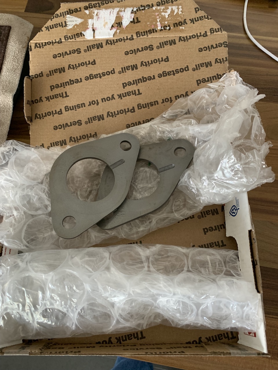

  28. Oneball
    Joined: Jul 30, 2023
    Posts: 1,643
    Oneball

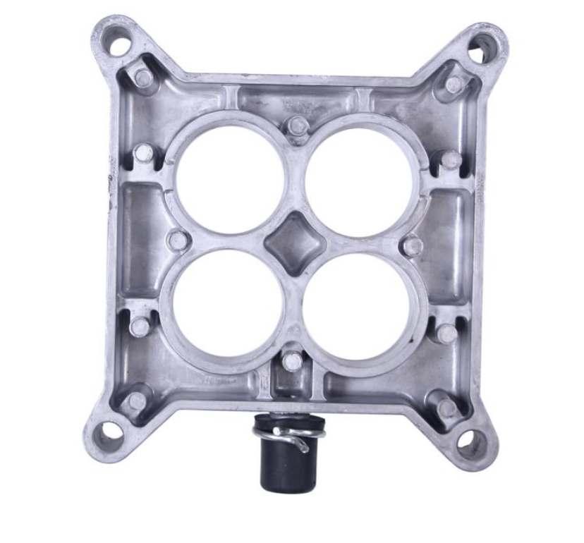

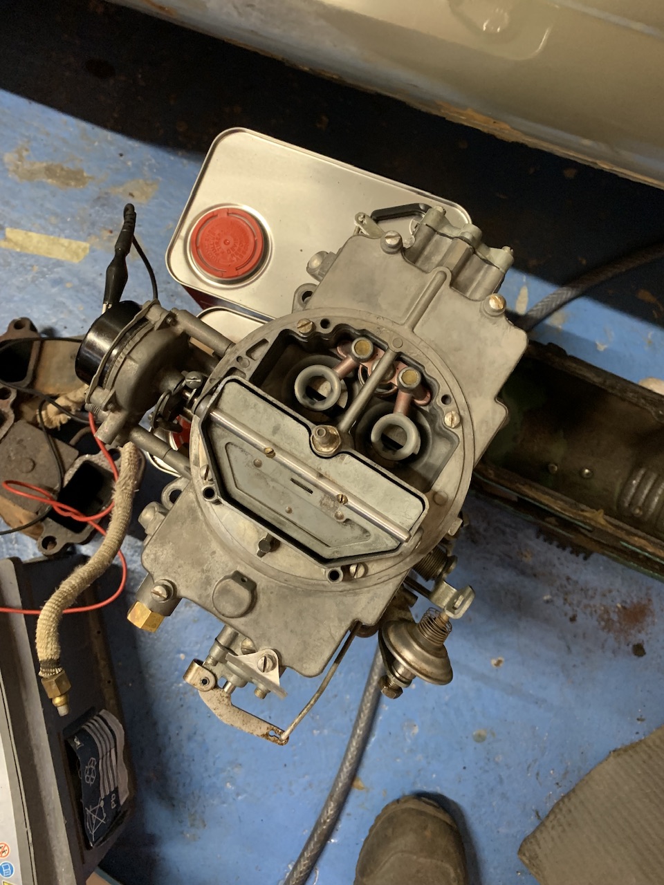

    I think I’ve screwed up here. I’ve ordered the correct spacer for an Autolite, but it has a hollow base. IMG_6362.jpeg
    This is going to give a vacuum leak where the AFB holes are in the intake. IMG_6361.jpeg
    I can’t come up with an easy way to make an Autolite work with this intake. ****womble!
  29. A thin piece of aluminum cut in the shape of the gasket between two gaskets will cure the leak. Done that a few times....
