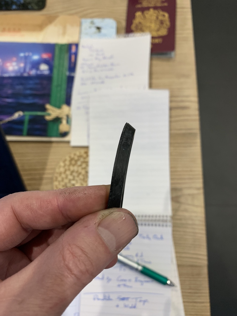

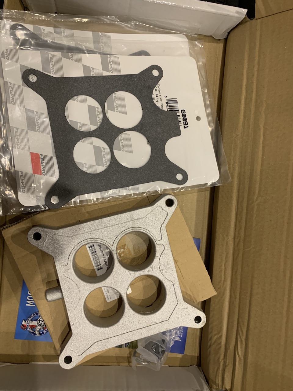

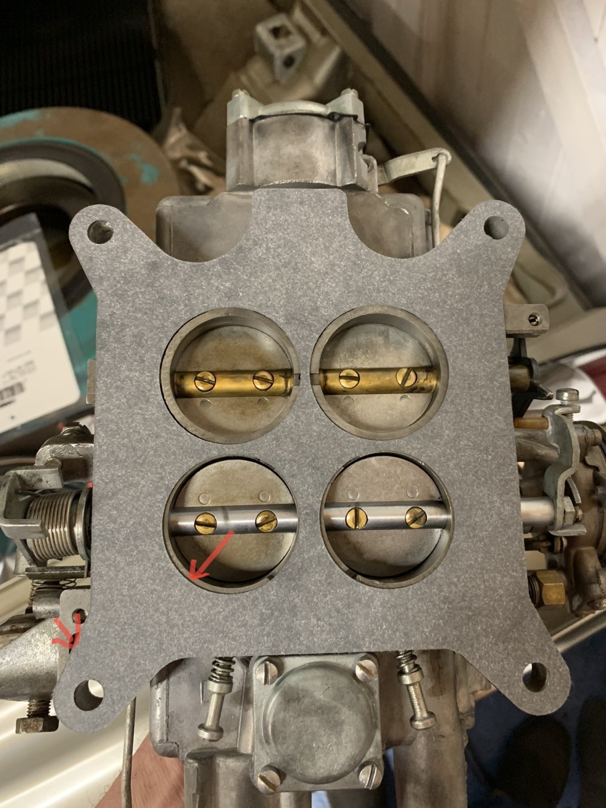

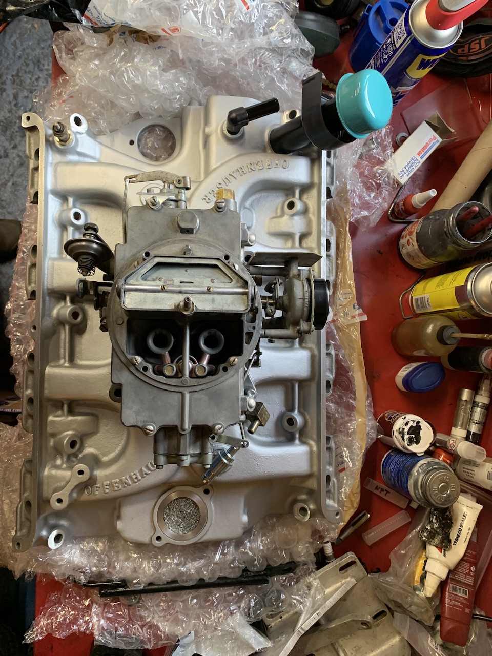

    I’m loosing the will to live with this carb.
    How hard can it be to get a gasket that fits. Ordered one for a Mustang that had a 4100 as stock and this is what I get.
    Does anyone know of a gasket that works with a 4100 Autolite carb?
  5. That's the way the OEM parts look... Those will work just fine.

    IMG_6398.jpeg The radius on the top of the bores is such that it won’t actually seal on the carb bores.
    There will be a leak here.

    And this gasket is for a spreadbore 4300

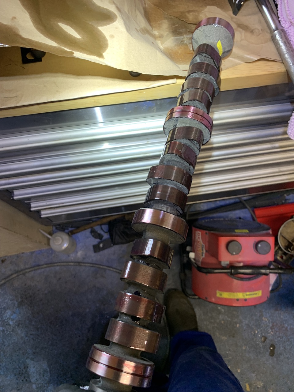

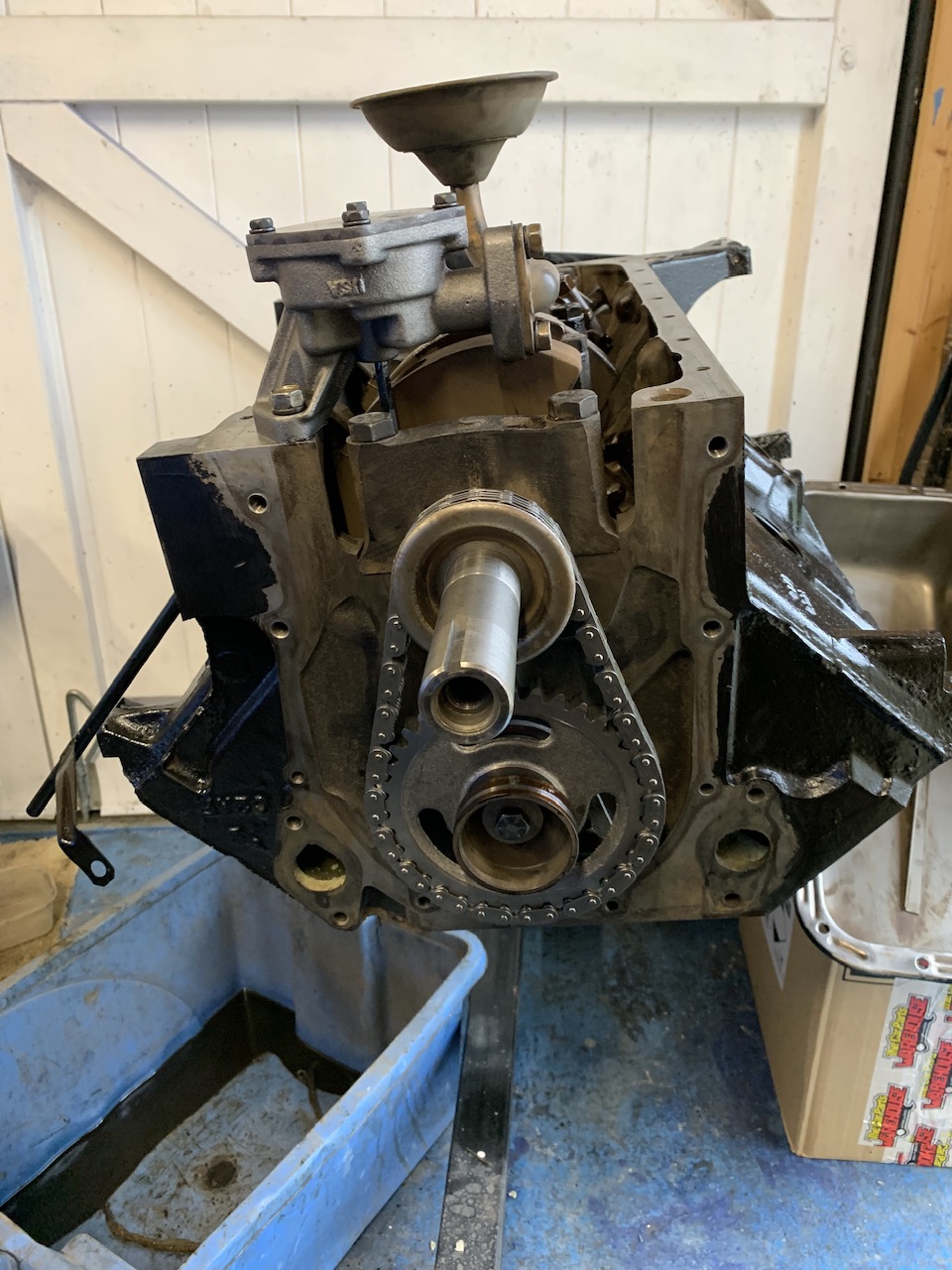

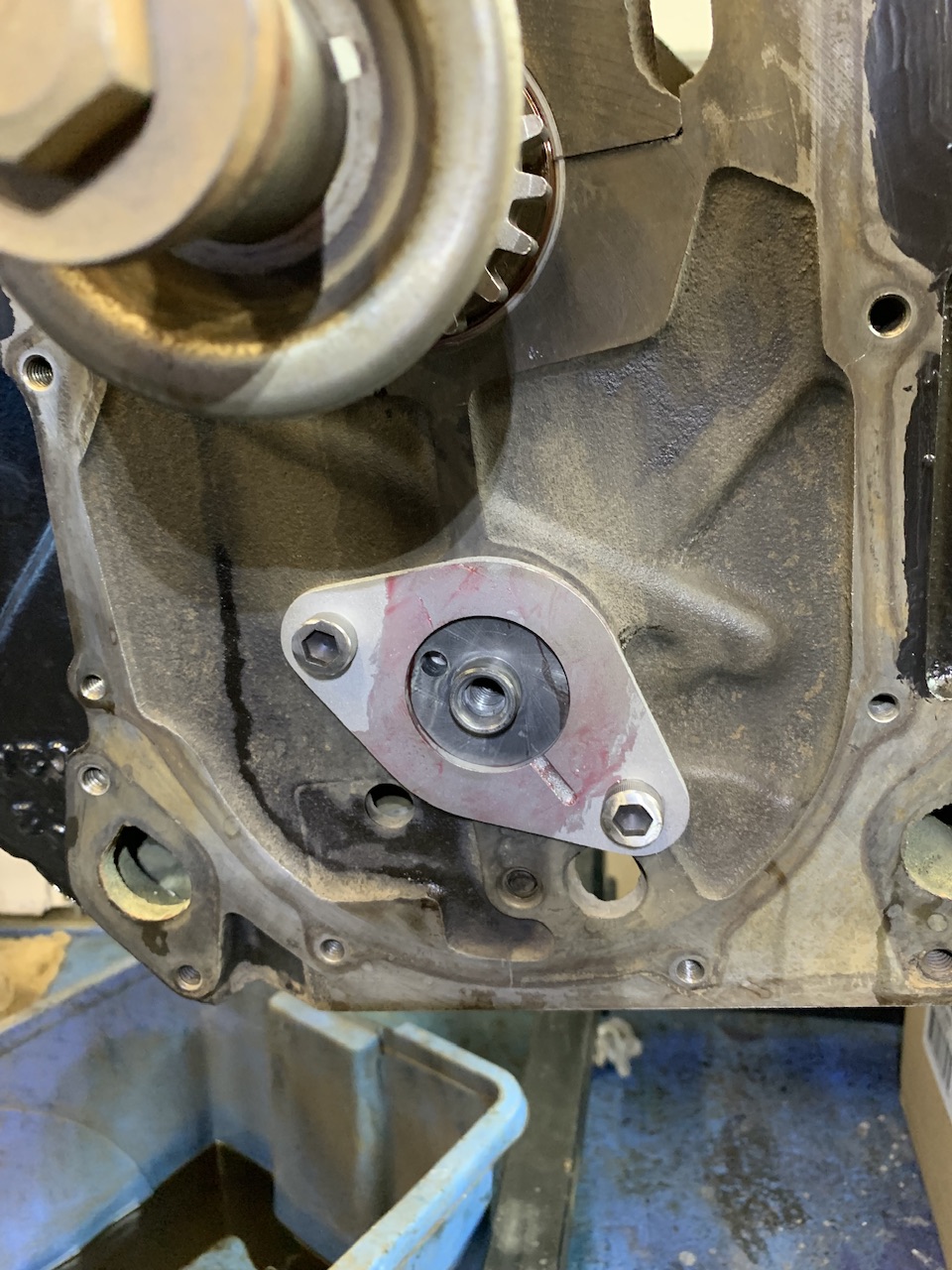

    Cam lubed
    And installed with my Alaskan thrust plate from Dennis
    Oil pump and chain on and timed
    Timing cover and sump on, that run in the paint is going to annoy me, a lot!

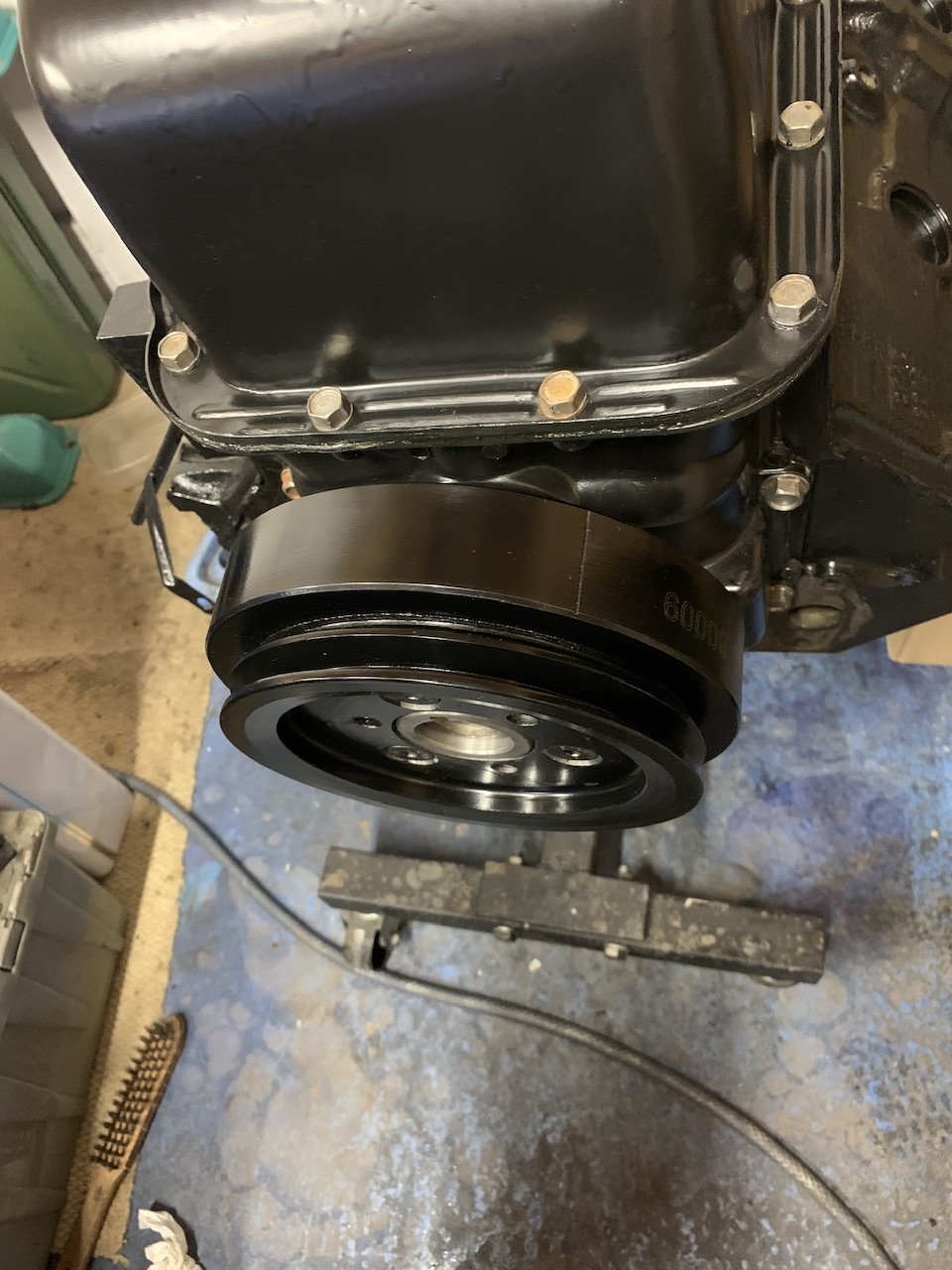

    Back to the two steps forward one step back thing.
    The new crank damper just slips on the crank
    I can’t see that being a good thing. It’s surely just going to eat the snout of the crank over time.

    If I'm not mistaken they are pretty much a slip fit, they just seem a little tight when they've been on for years. Im sure someone with more FE experience will chime in

    I spoke to the manufacturer, they’re supposed to be an interference fit. Going to see if I can find some one with a bore gauge small enough to measure it and then feed back to them.

    Damper bore seems to be 1-2 thou oversize based on the manufacturer’s specs. I’ve emailed Summit to see if they’ll do anything.

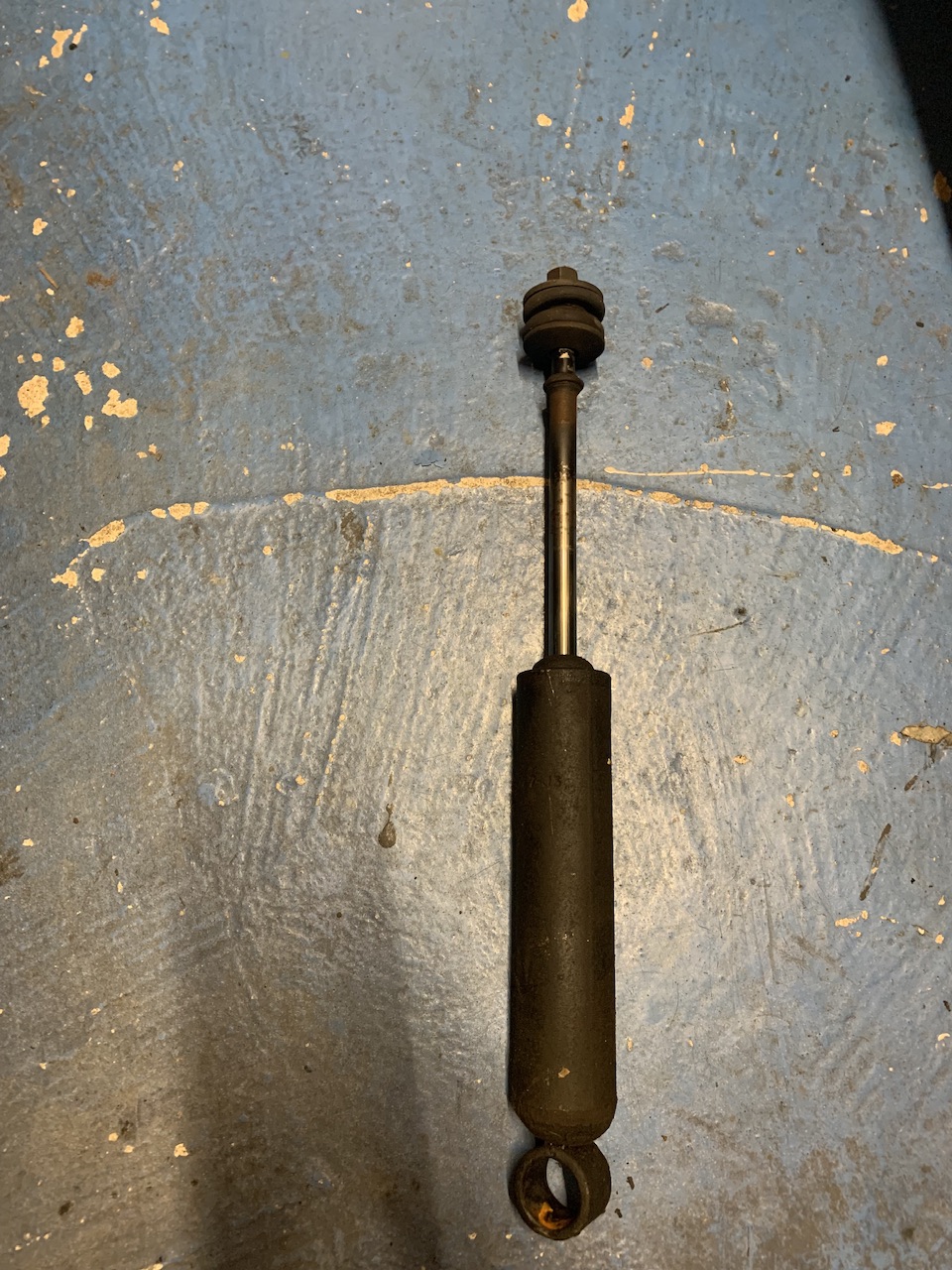

    Moved on to the shocks, got one front off. Looks like an original, there’s absolutely no compression damping left in it all. Would’ve been interesting on the brakes! The top sheered off the other one so gave up on that for the evening.

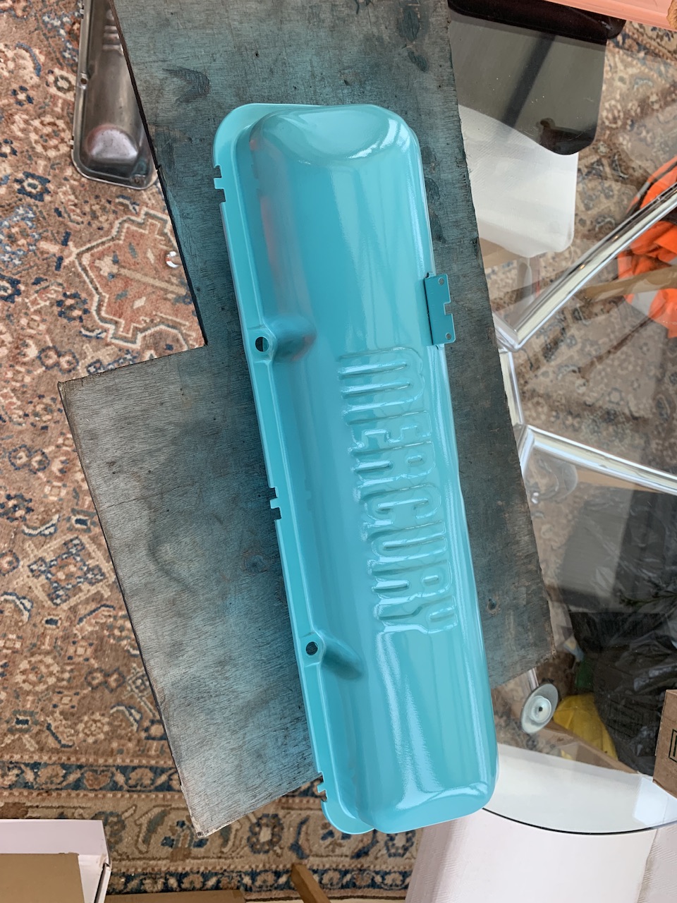

    Cleaned the exhaust manifolds up and gave them a lick of paint.

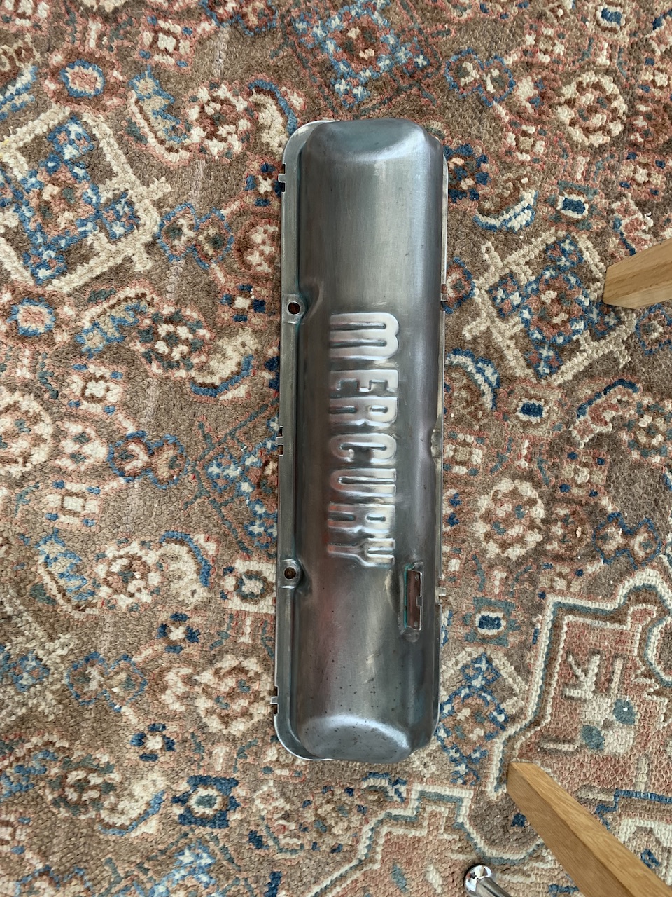

    Stripped the rocker covers
    and painted too

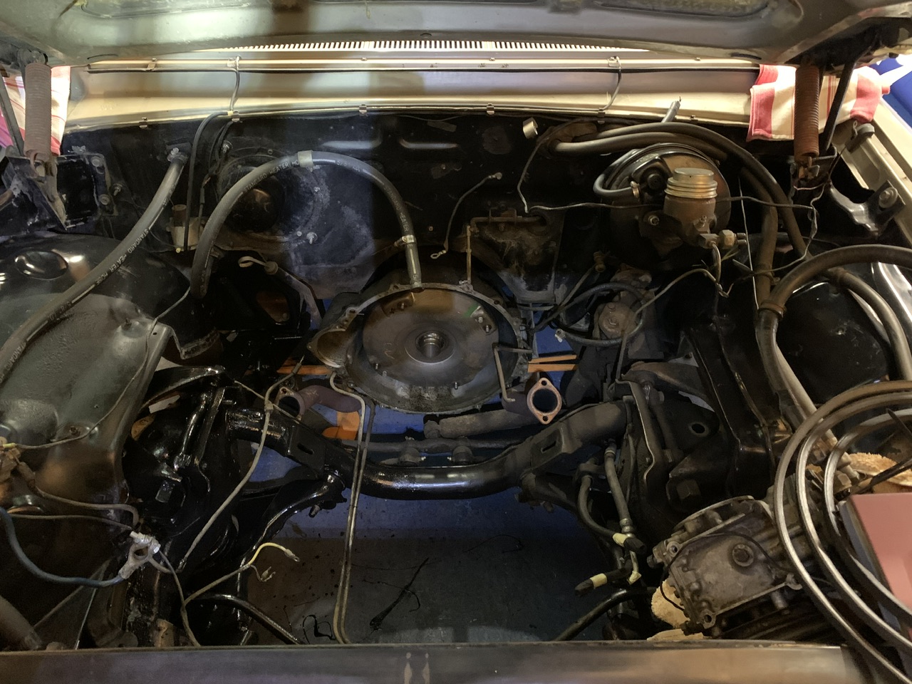

    Gave the engine bay a clean and painted the front of the chassis whilst the engine is out.

    Summit have told me the crank damper is ok to use which I think is*********, loose is loose. I've measured the crank OD at 1.3750" (which is within the factory spec) the new damper from Summit measures at 1.3765". So going to see if I can find another one in the UK.

    Shipping is expensive for that weight. Also learned that the 427 style damper won’t fit my car without moving the dynamo. So the old one is going back on for the moment.

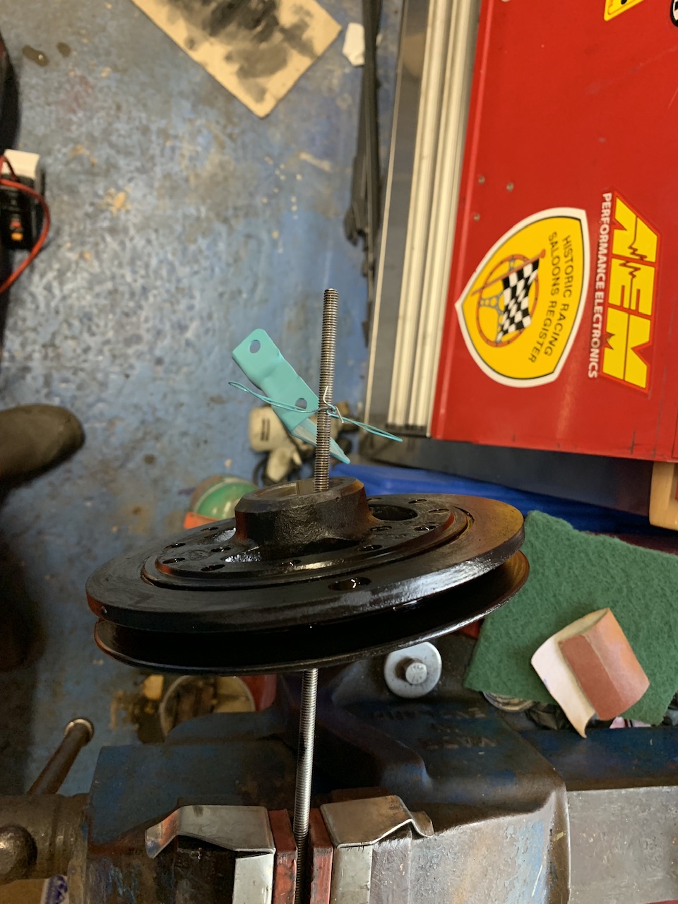

    Cleaned and painted the original damper, I’ll reference the inner to the outer when the paint is dry just to keep an eye on things.

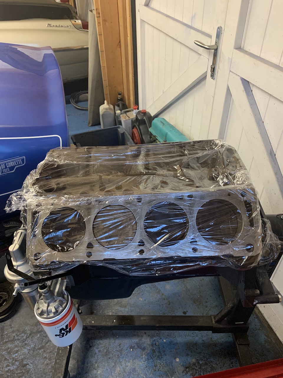

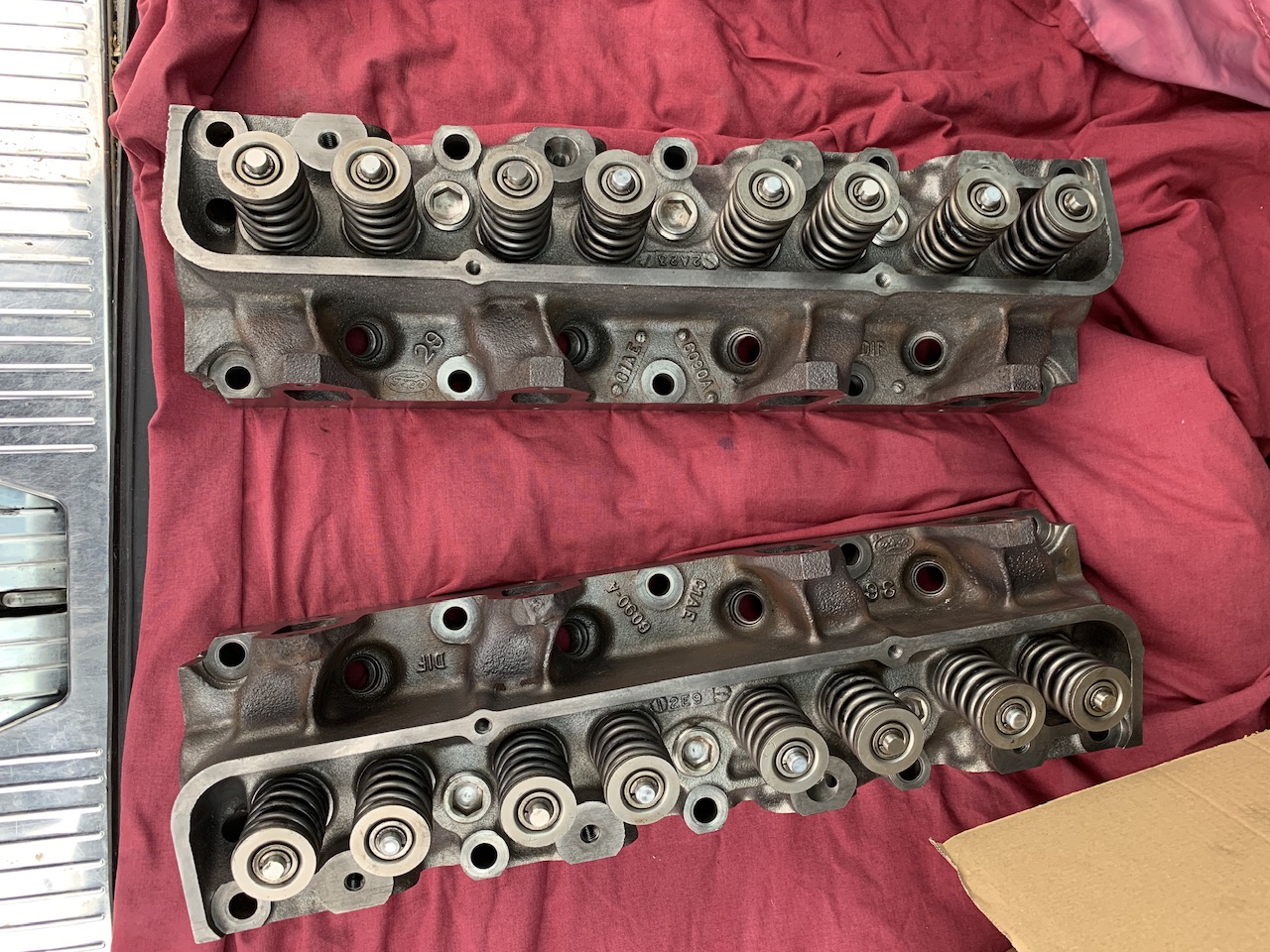

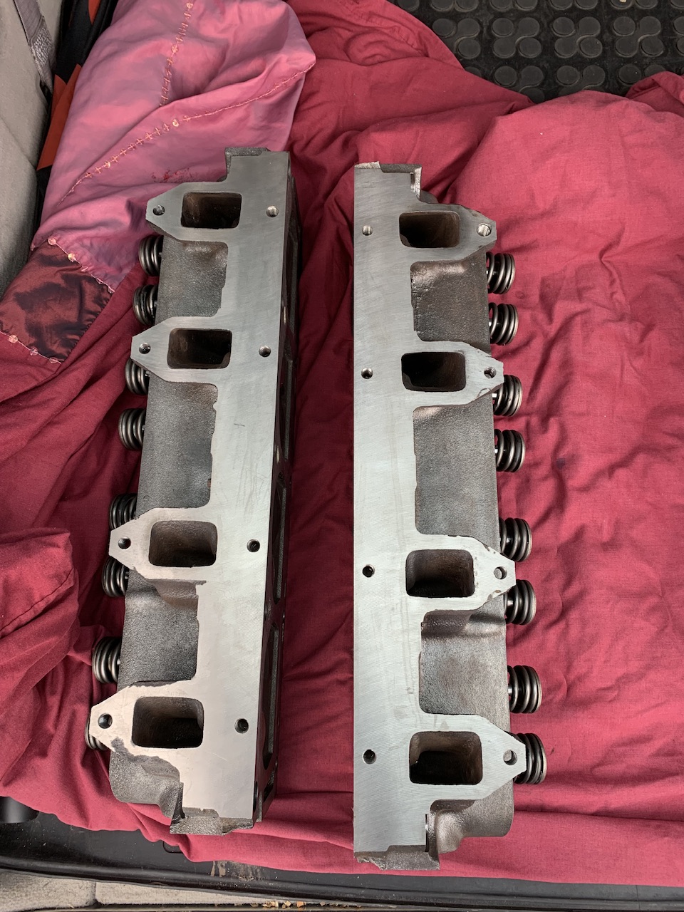

    Got the cylinder heads back, new valves, guides put in and exhaust manifold face skimmed. IMG_6570.jpeg IMG_6573.jpeg

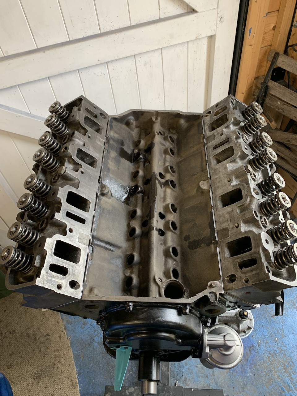

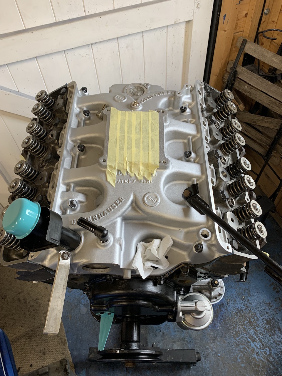

    Heads on
    Tappets and tray in
    Intake on
    I’ll put some paint on and finish off tomorrow

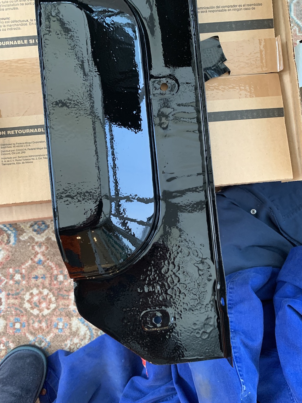

    First thing I’ve painted on this so far that went*****ty

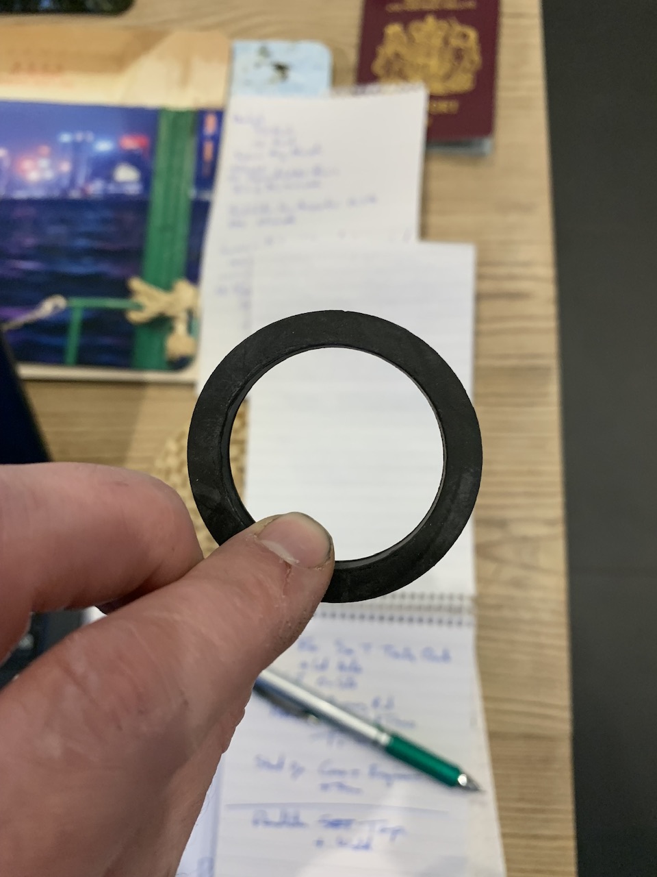

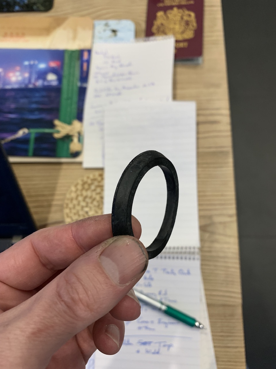

    Just checking is this the correct distributor seal?
  30. Jeff Norwell
    Joined: Aug 20, 2003
    Posts: 15,271
    Jeff Norwell
    MODERATOR
    Yes.. that is the Dist. core ring.
