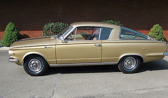

    Subscribed,I have a soft spot for the '65 Barracuda's,I met my wife sitting in a gold one the day after Christmas in 1966.
    She was riding shotgun with her cousin in here dads car.
    This is not the car but looks identical,her uncle totaled it on New Years Eve.:rolleyes:HRP

    Wait....did HRP just post a Formula S car with blue streaks that he got spanked by his future wife ?....god luv him !
