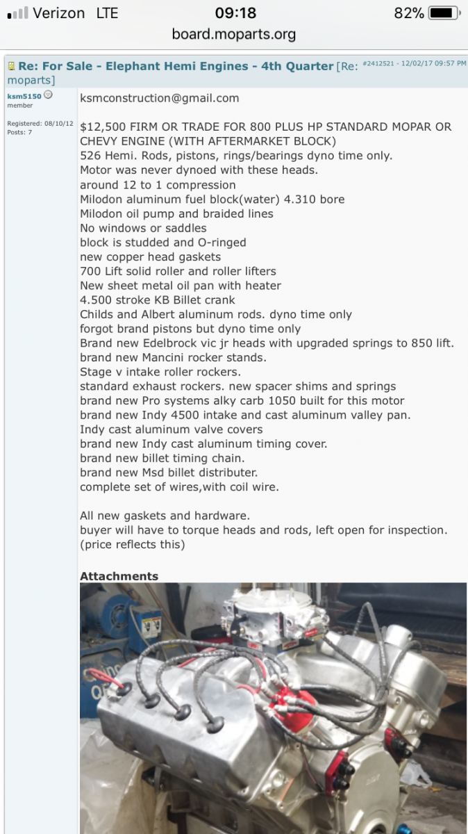

    Squirrel, this Hemi was posted for sale on Moparts.com this morning. Might be worth looking in to..??

    Thanks for the info.
    I expect I'm going to have to piece together an engine....this one has about half the parts I want in mine....
