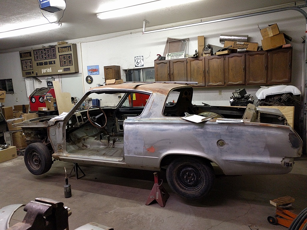

    Gutting it sure does change its demeanor. My mind's eye wants to turn it into a pick-up Lol.
  2. squirrel
    Joined: Sep 23, 2004
    Posts: 59,925
    squirrel
    we already had that discussion on another part of the internet! Not happening...
    When the trunk lid and back window go on again, it'll look right.

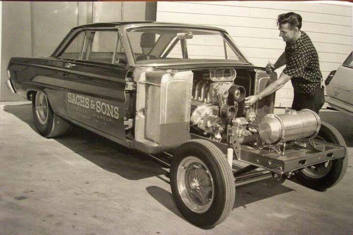

    I don't know why, but it just now dawned on me that one of my favorite race cars solved a few of your problems this way:
    :D
  6. squirrel
    Posts: 59,925
    squirrel
    That's one way to do it! I want the blower in front of the windshield. Just barely.

    "heavy" is all relative. The car is pretty darn light, until you add a blown hemi and a Dana 60 rear end...
    I've been looking at the body structure. I intend to cut out the entire floor and firewall, and replace it with a rectangular tube ch***is, necessary crossmembers, and aluminum panels. I expect I will leave most of the door jambs, and the rocker panels.
    There is a LOT of bracing inside the edges of the roof, and the rear window surround. The fun question is, how much can I cut out? I know I need to leave the edge of the bracing, but I think I can cut away most of the tube shape (there is an upper and lower piece around the perimeter of the roof). I can add some bracing from the cage to the roof, although I don't know if that's a good idea or not.
    I am pretty sure I will cut out most of the inner quarter panel, and probably the lower half of the inner brace between the trunk and the rear window. I also plan to trim away most of the area around the trunk hole, which currently is used to support the weatherstrip.
    Every pound is worth about a thousandth of a second...
    IMG_20171206_202340.jpg IMG_20171206_202403.jpg IMG_20171206_202431.jpg IMG_20171206_202506.jpg
