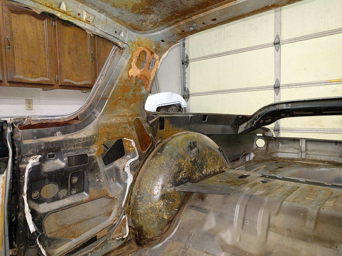

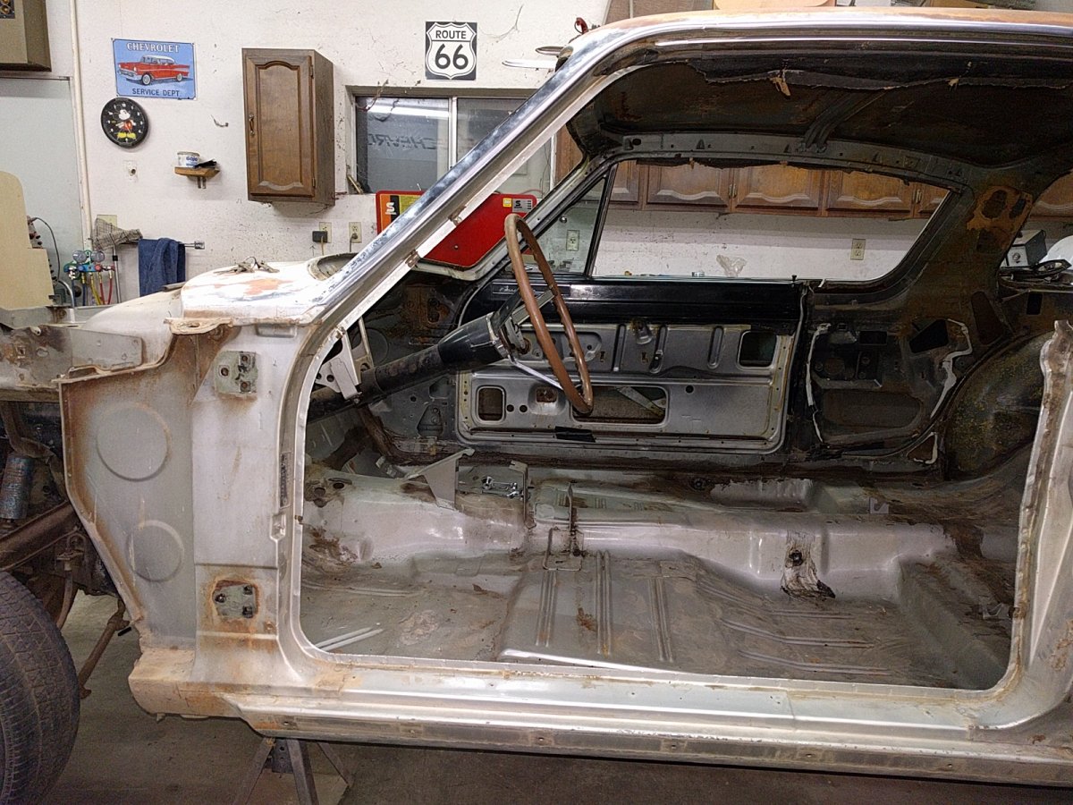

    You could reinforce the roof and quarters with conduit, shaped to fit.
  10. squirrel
    Joined: Sep 23, 2004
    Posts: 60,039
    squirrel
    I thought about reinforcing the roof as needed, but probably with mild steel tube, not conduit. I don't like welding zinc.

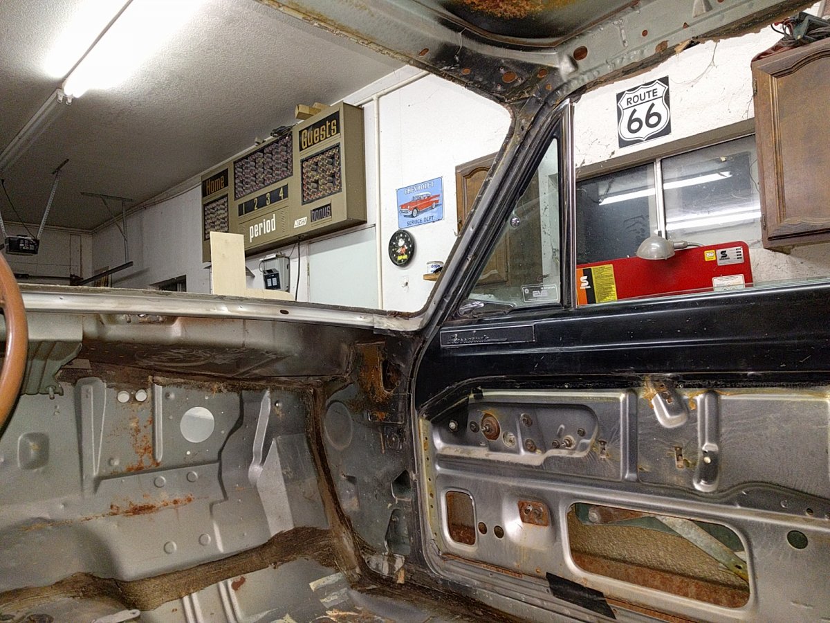

    Awhile ago, I saw a car under construction that had the roll cage tied into the B pillar right at the door latch. He actually used the door striker as the mounting point. I thought this was pretty clever and the doors opened and shut like a brand new Toyota. The car had no floor at the time and I don't remember how the rest was of the body was mounted. But, I put that in the 'Things to remember if you ever want to do something like this' file.
    mad mikey, brad2v, Chucky and 2 others like this.
