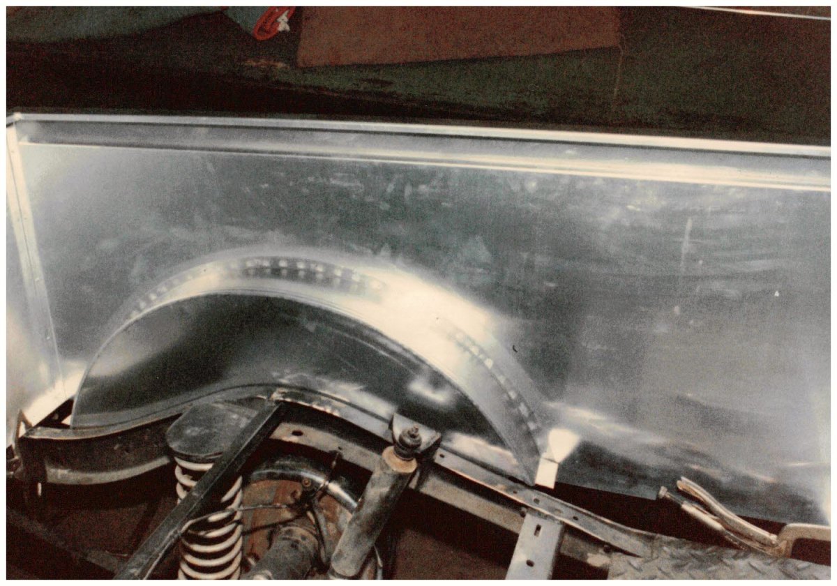

  19. I think on the right track now. I have done this system a few times and really like it. NASCAR still uses this basic system so there has to be something right about it. That is also the plan when I get back on this project.

    I use truck arms on my willys pickup with quarter leaf springs it hooks real good it will pull the front wheels up just a bit but the truck just moves out real good I have gotten a 1.5 60 foot time it is a four speed and. That is side stepping the clutch at 4 grand when I launch it If I were gonna do it all again I would probly use some coil overs instead of the quarter leafs as it took a good long while to get the correct leaf stack needed to be able to not only drag race it but to drive it on the street as well however I don't have a big inch monster horsepower hemi in it either just a measly ol blown sbc Jim you might ought to call and chat with racerx as he has real world experience with rear suspension in a afx situation with a blown nitro hemi and I know it had ran in the 8's

    This ch***is was built by Chuck Finders around 1965, the front suspension was re-worked by Steve Plueger in '67 . The simple coil spring and rectangle tube lift bars with coil springs, has always worked great. Built in the era you are working around, and still running. As a matter of fact, it ran 8.04 @ 168 a month or so ago. Good luck with your endeavor ! Bizio 3.jpg 2013-04-02 201323.jpg Bizio12.jpg
