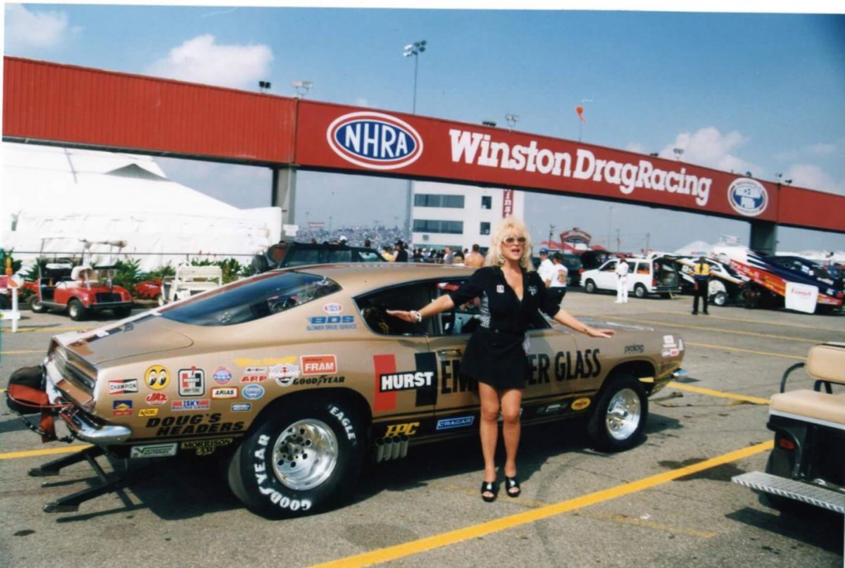

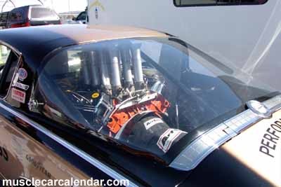

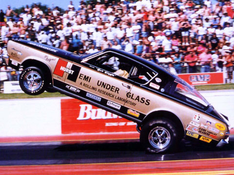

  13. BamaMav
    Joined: Jun 19, 2011
    Posts: 6,969
    BamaMav
    from Berry, AL
    How was the rear window handled on the Hurst Hemi under Gl*** car? Was it stock mounted, or did they have it lift up to access the engine?
  14. squirrel
    Joined: Sep 23, 2004
    Posts: 59,919
    squirrel
    don't know. It's really hard to tell, from the pictures. Looks like you could climb inside the car from under the back, though.

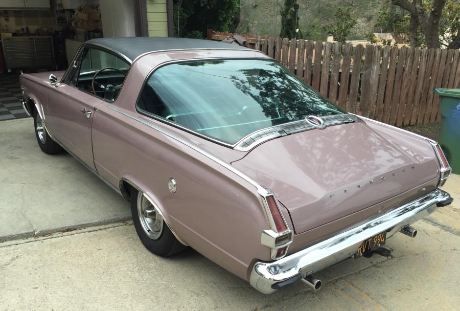

  21. das858
    Joined: Jul 28, 2010
    Posts: 1,242
    das858
    I've seen photos on the HAMB of the original Hemi under gl*** with the back gl*** out and the crew doing maintenance, it looked like the gl*** was held in with some tabs on the back edge of the roof and the front edge of the trunk. I can't find the photo I'm thinking of but I did find this. 1969-plymouth-barracuda-3.jpeg
