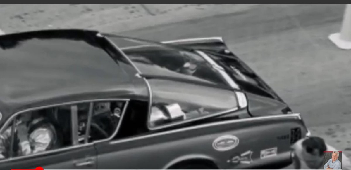

  2. Looks like it has safety straps (seat belts) holding the back gl***
    Later body style had hood pins thru the back gl***- that's after the wreck with Jay Leno
    And the clamp strip with screws

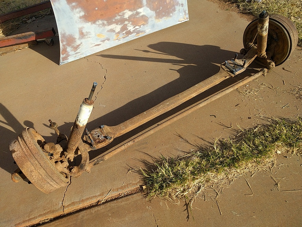

    I'm gonna have enough challenges with this car, don't worry!

    But...on the good news front, I scored a couple axles today. An A-100 front axle with steering and brakes, and a Dana 60 from the 1960s (no, it's not from a Dodge, nor a 3/4 truck...keep guessing!)
