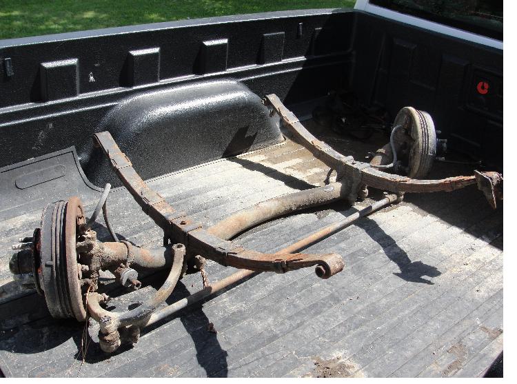

    I did some front axle measuring today...looks like the van axle is probably a couple inches too wide, as it is. A couple of the old cars had the tires right out there, but I think this thing would be out further. The drum to drum measurement is only an inch less than the fender lip to fender lip measurement. Oops.
    Might be able to narrow it some, might be able to drop and narrow it some. I don't know. Or use another axle.

    The offset of the front wheels would make a difference on the width of the axle you can use. The two pictures have the front wheels set way in compared to where they are bolted on at. Drilling holes in the axle are both traditional and effective at reducing the axle weight. There is not much axle beam left in the 1st picture!

    What about a mid 30s dodge/chrysler tube axle? I think from memory some 80s or 90s discs almost bolt on ..kit from https://scarebird.com/

    I have another prospect for the front axle, so I'm going to put that decision on hold for now....

    Narrowing a forged axle is not that hard. I had to cut almost 6 inches out of a f100 axle to fit my Morris Minor. I got the axle for free and it came with discs on it so me being low budget, I used it.

  18. I am doing some work on a old Falcon G***er that was built in the late 60s, it has a narrowed Econoline axle in it. I think this was a common practice at that time. This one was boxed on each side after being narrowed. I recall seeing others that were cut and **** welded which was more common.

    Jim the 64 dart afx I had I used the a-100 axle I narrowed it 5 1/2" out of the center I made a jig to bolt to the spring perches to set it up i veed it out real good heated it up with a torch then welded it together I smoothed up the out side but left it alone on the inside I used 15x4 cragar ss wheels with 165 tires when I done that it moved the springs right under the stock sub rails and the tires were in the proper spot width wise I had talked with dale snoke at snokes metal shed and that is what he had done on the rampage dart clone he done I would think that the barracuda should be real close to the same track width as the dart
