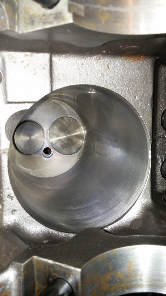

    Jim, when you start screwing that Hemi together, one thing to always check on a new Hemi combination is the valve to bore clearance. Before you put the crank in, put some soft valve springs on the heads, bolt the heads to the block, flip it over and check each one. THey are pretty close, so it doesen't take much to make it hit. Guys have found interfearance due to misalignment of the dowel pin holes, or valve guides. It's best to find it before you start the engine. :(

    Thanks for the tip. I did notice that my block is already relieved on the intake side to clear the valve.
