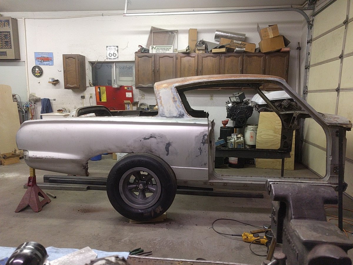

    Starting the mock up process. The frame length is just a wild guess. And the steering box is probably going to be moved around. I need to trim the rear wheel opening on this side, and set the wheel/tire in there. But I think the height is close.

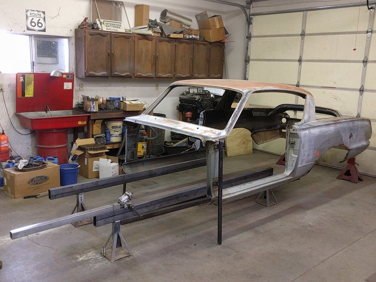

  14. squirrel
    Joined: Sep 23, 2004
    Posts: 59,957
    squirrel
    Here's a sneak peek of the other side...

  18. flatford39
    Joined: Dec 3, 2006
    Posts: 2,799
    flatford39
    Tell us what you used to cut that arc...old school snips or something else. Looks great. That is a decent body to start with.

  20. squirrel
    Posts: 59,957
    squirrel
    Oh, it'll drive just fine.
    I cut the body off the floor/ch***is with the torch. And I'm t******* the ragged edge with snips, then the angle grinder with a flap wheel.

    Posts: 439
    Bonehead II
    Jim...In the picture of the frame mock up Drivers side, Is that the steering box and pitman arm that came with the car ?. can that box be used as a push pull type for the front axle with no mods done to it......Thanks
    Mike
  27. squirrel
    Posts: 59,957
    squirrel
    That's a Corvair box I picked up and reversed. This car came with power steering, so I can't use it's original box.
