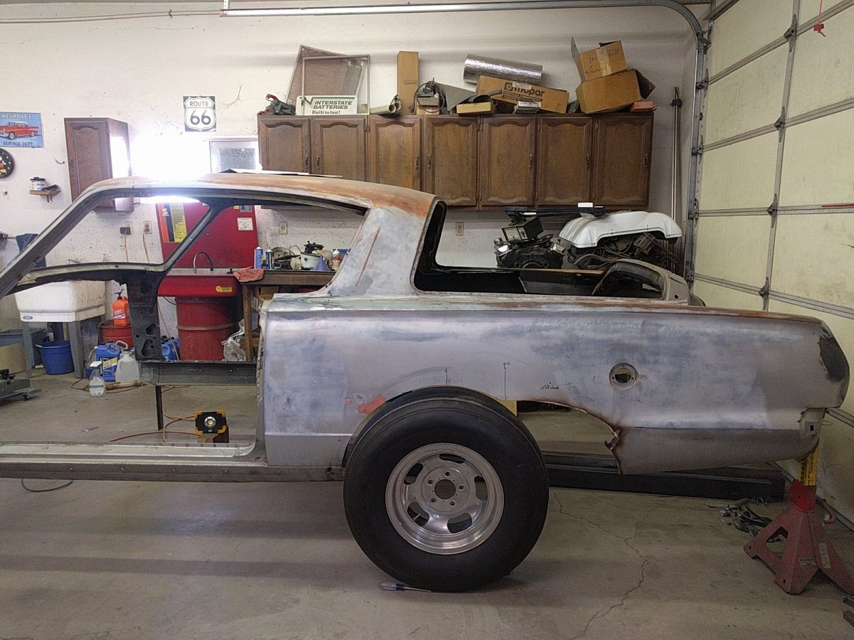

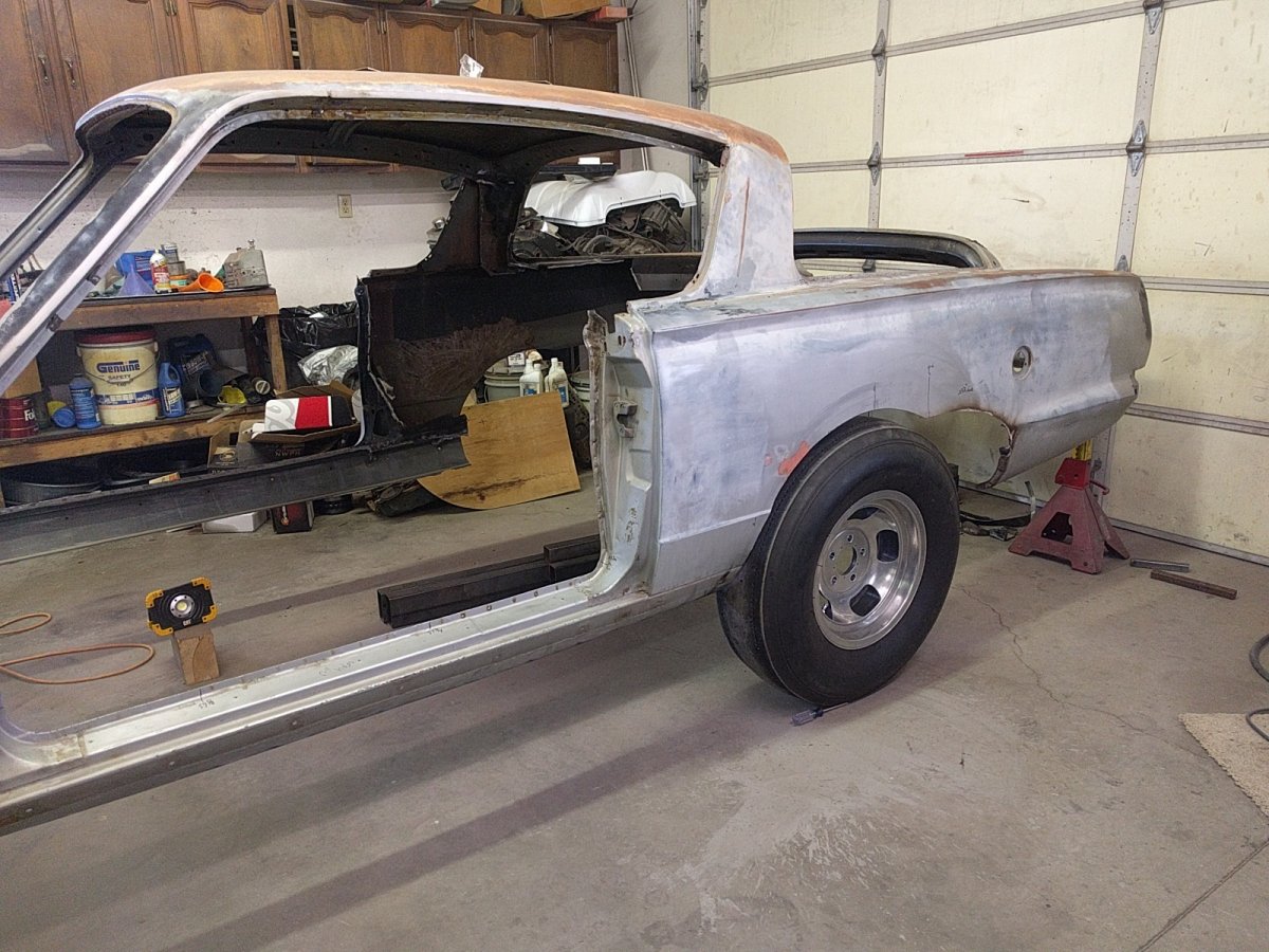

    I'm also playing with the tire cutout. I'm using the skinny slicks from my Chevy to get the diameter right, since I don't have the larger diameter slicks yet that will fit the wider wheels that are going on this car. I expect I'll probably need to do some more adjusting once I get the right tires, and get the frame and suspension in. I'll be using adjustable height springs, so I can set ride height later. I plan to run street tires that tuck into the fenders, so it will be able to handle bumps, etc without rubbing. When racing, the car will have less weight in it, and be on smooth surfaces, so I should be able to get away with perhaps just under 2" clearance between the fender lip and the tire. I plan to put a 1/2" diameter steel tube behind the wheel opening, to give it strength, and also to prevent tire damage if it does make contact. And yes, I'm going to fill in the cut out area behind the tire!
    here's a mock up

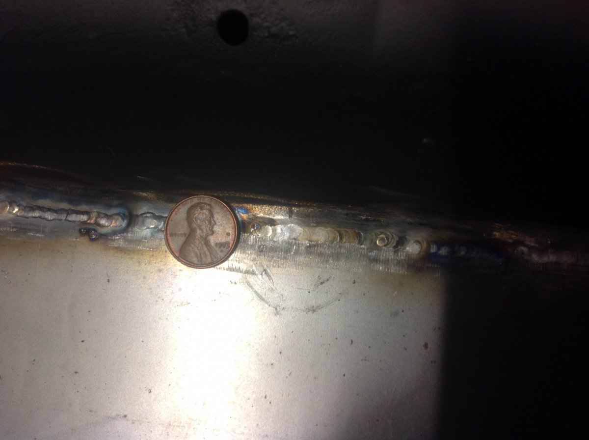

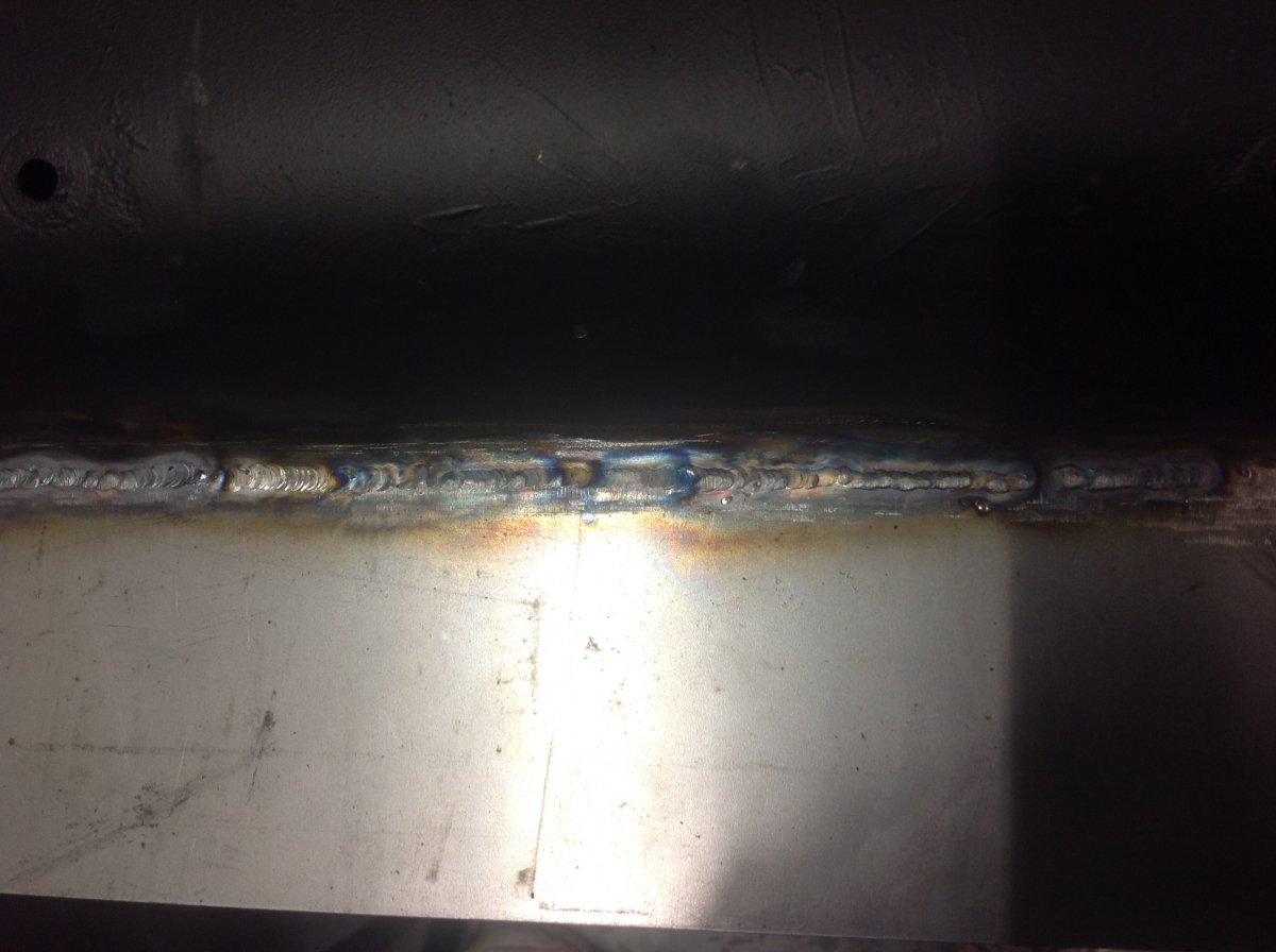

  18. What about stacking pennies ? Lol
    loudbang, catdad49 and flatford39 like this.

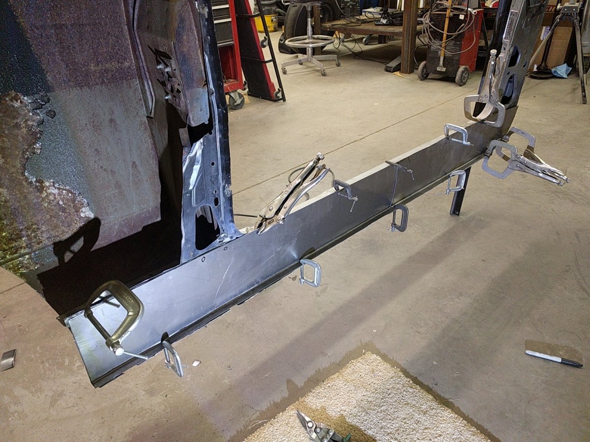

    Made a couple pieces of inner rocker panel. A bit more prep work, and I can spot weld them in place. I got a cheesy HF spot welder, set it up, tried it on some s**** metal, and it seems to work. It takes some practice to figure out when to let go of the ****on--seems to work best if I let the hot circle get to a certain size, rather than hold the ****on for a certain amount of time. I used it first to tack some small patches behind the trim holes in the outer rocker panel, then I MIGd them from the front side.
    Anyways...I think I can get the rocker to be mostly straight, measuring with my calibrated eyeball. It kind of rolls up at the ends, so I have to get it in to shape before clamping.
