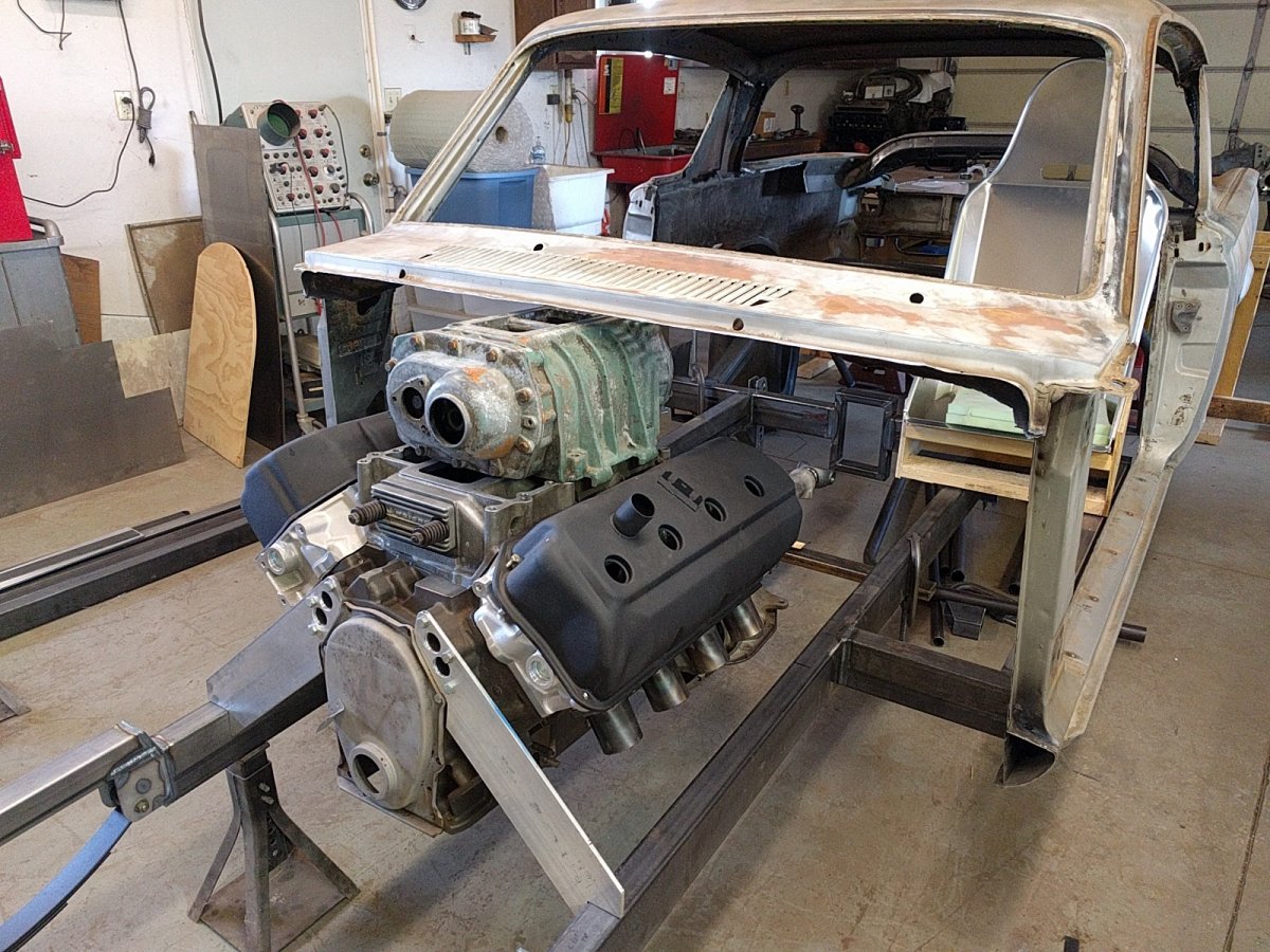

    Back to work...I made some elephant ears. Also got the intake manifold, an old Weiand. I have a 4-71 sitting around, so I set it on there to see how far back it goes. Of course we'll see how the 8-71 looks when it shows up, it'll be a bit longer.
    I've also been working on the rear end. And figuring out where the seat will be, where the cage will be, where the firewall will be, etc.

    Squirrel just a question, why would you mount the engine so far back as to make it difficult for blower clearance. It is not being built to run NHRA funny car so isn't it better to move it forward a bit.

    I'm going to use a mid plate, I just haven't trimmed it yet. The engine is going back as far as it can. I'm going to cut away the cowl, almost back to the windshield. As long as the rear carb clears the windshield frame, it should work. I still have to figure out exactly where it will be.
    Nothing about this car is supposed to make sense...the whole thing is a really dumb idea. Which is why it's so fun, and why it needs to be built.

  17. 20130623_154119.jpg I know a little about dumb things to do in a hemi powered altered wheelbase car. I certainly did my share of them. Usually the mid plate is .090 thick. The converter will need to be ordered with a extra .090 on the converter. Make sure it's made out of chromoly. I snapped multiple tail shafts on my 727 when I had a rubber mount. I stopped breaking them when I went to a solid trans mount. I know there are arguments for and against mounting a trans solid. This was my personal experience. It worked for me.

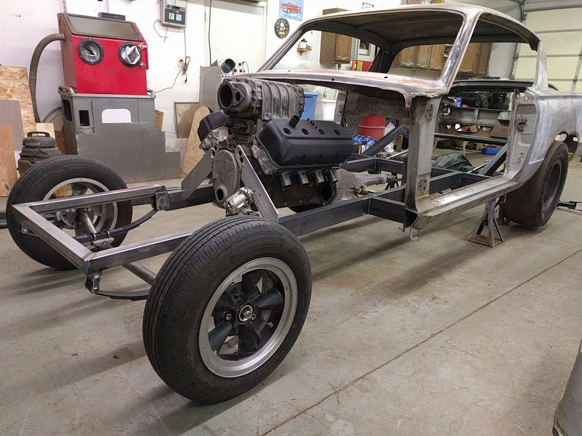

    I put some axles under it...but I still need to order the rear axle shafts, I'm using one old (long) one. And probably figure out some different front springs--these are cheapie trailer springs, that are probably too stiff, and have a funky arch.

  28. Jim I did the same thing with my springs. I got a pair from a local trailer store that were the right length. I removed pieces until I thought it was going to work. After a few passes I removed one more. When I had them just right I chromed what was left. The results netted some ets deep in the sevens.

    I've always wondered why most gassers used the 2 parallel springs instead of a transverse single spring and either radius rods or 4 links????????

    we want them to drive like a truck, not a buggy? :)
