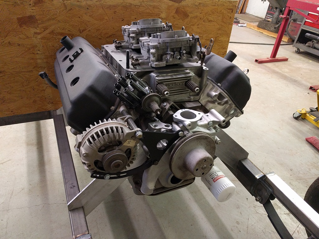

    We got back from our Airstream trip to Yellowstone, and I've mostly recovered. And getting back into working on the car. I've been getting some parts for the engine, and started on the quarter panels. Still waiting for some engine parts I ordered, and need to order a bunch more, too. It's going to be iffy whether it gets done by September, but I'll keep after it.

    Like the Firewall! Looks like it would support a fire real well;)

    Cut, grind, weld. Great thread.
