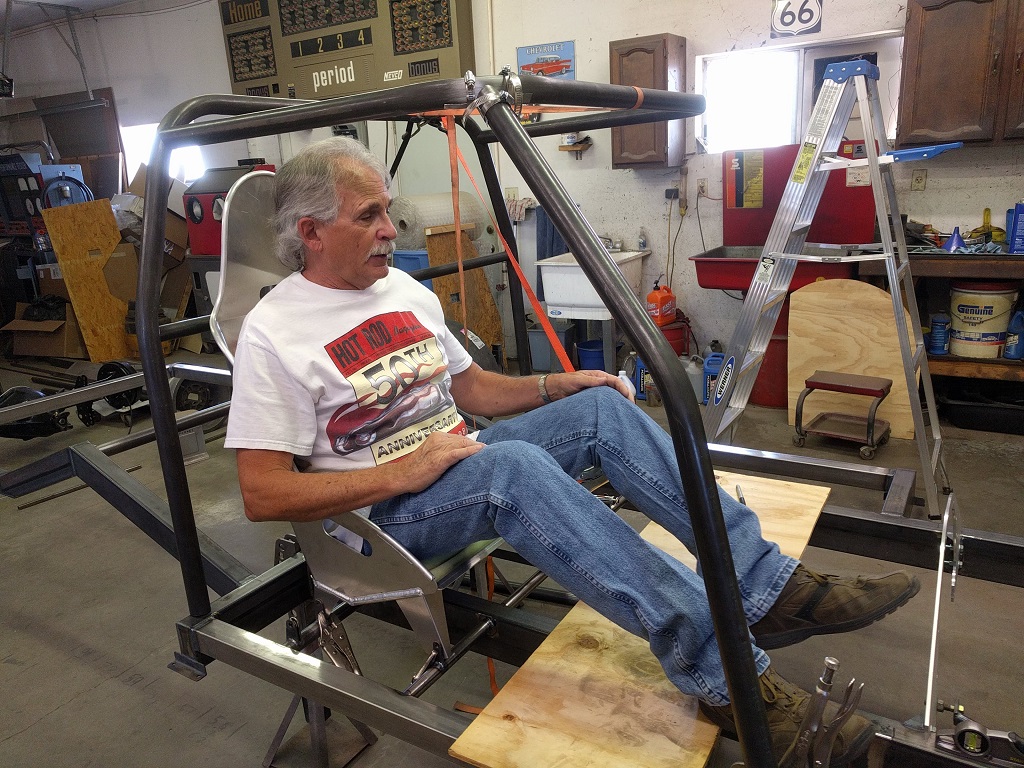

    I've been working on the cage, getting it all to fit. I did some measuring when the body was in place, so I know where things have to be. I'm using hose clamps and little strips of metal to hold the joints together, while I make the next piece fit. Eventually it will be together enough to tack it all, then weld it.

    Right hand drive?

    Is the photo flipped?

  12. justabeater37
    Joined: Jan 1, 2009
    Posts: 1,825
    justabeater37
    Or it's the p***enger seat...

  13. 51504bat
    Joined: May 22, 2010
    Posts: 5,616
    51504bat
    Moving to Australia?

    the two seats sit right next to each other, in the same position, so I was just using the p*** side seat to see where things are. Later this evening, I installed the brackets on the other seat and bolt it in, too. Then removed both of the seats.
    but while I had only the p*** seat in, Dan (my Drag Week copilot) stopped by, and got a feel for the car...

    Looks pretty roomy this way.

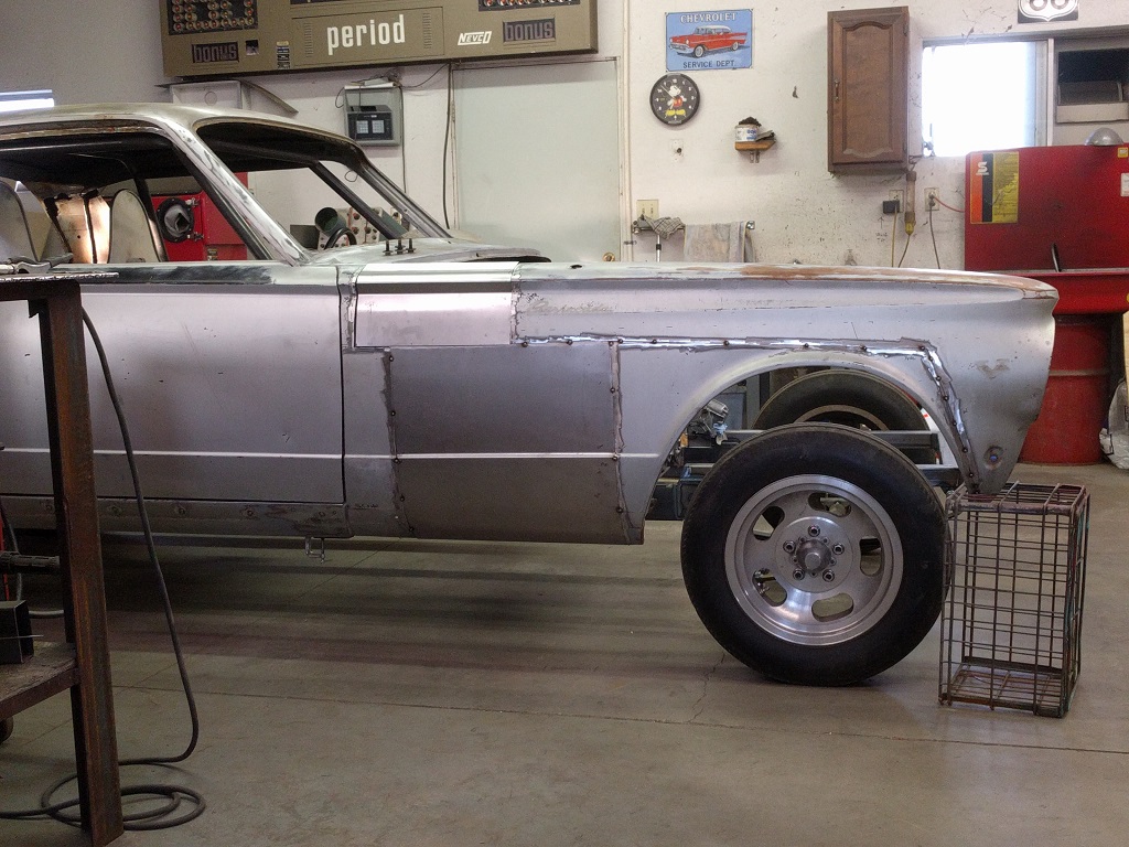

    anyways, been tinkering with the steering, I shortened the column and added a smaller wheel. I also played with the steering box mount, made some new parts, and tacked them in place. I ordered parts to connect it all together.
    And started on the p*** side fender. I decided the method I was using on the driver side fender wasn't going to work too well, so I did this side a little different, and I'll redo the driver side with the other fender I have. (the car came with an extra pair of fenders). A little slicing and dicing, and I might be able to make it fit a little better.

  26. Jim, Are you using the tig for the sheet metal too? How's that working, so far?

    squirrel

    got the fender tacked together, for the first look...it's close, but needs a little adjusting. I think I'll move the opening up into the fender about half an inch, and I also messed up and made the big filler panel an inch too long, so I'll shorten it. I want the wheel to be a bit forward in the opening, for that racy look. Also I need to play with the lines, the top has a hump in it, it needs to flow better. There are all kinds of strange curves in car bodies, that you don't really notice until you add straight pieces to them.
