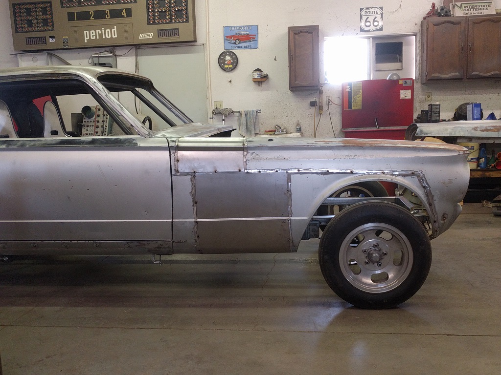

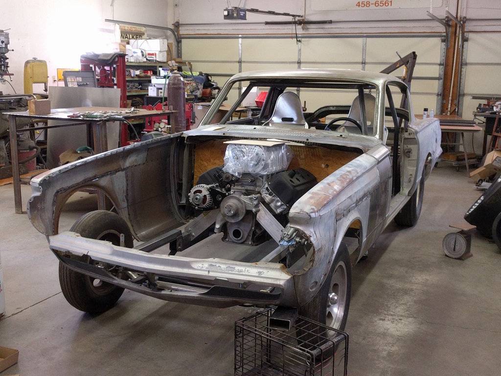

    I took it apart, trimmed some, and put it back together. I also added a tube along the top to hold everything together, and put the front valence on so I could get the front end of the fender where it is supposed to be. I think it's close enough, fenderstretch04.jpg fenderstretch05.jpg now.

    Squrriel, I like the wheel out of center on the new version. It looks unfactory.

  4. Looks great Jim, so glad I didn't comment on the lower body line earlier as it looks like you straightened it quite nicely.
    How long until we get to hear the elephant bark?

    I wonder about the hood, without seeing the vehicle some hoods have a taper from back to front. But, I guess if you can do this and it looks good, the hood will not be a issue.

    Yes. I intend to pull molds from these fenders, but I might not get that done right away, so I might run the steel fenders for a while.
    As for the taper of the hood..it will be interesting to see how that works out. I left the "extension" part of the fender, at the back, straight. But there is 3" total taper in the hood from front to back, 1.5" each side. The idea is that the original hood will still fit, and require 15" long straight extension pieces added behind it. I still don't know how that's going to work, but I have several ideas.

    Are you going to run it a little nose high ? I know you're shooting for first edition funny car and I would ***ume it will have A/FX influences.

    I'd like the nose to sit down just a bit....

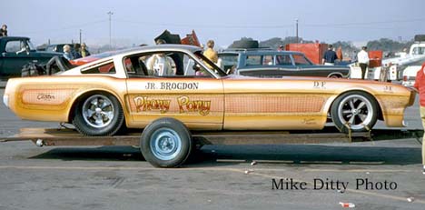

  18. By the time this style car came out (second gen funny car) the front ends were starting to come down. The tires were better (early 65) as racers moved away from the pie crust tires and into the wrinkle walls. The cars didn't need the front end up for weight transfer any more. They also started to lower them do to the aero dynamics as the cars started to approach the 200 mph mark. Better handling was achieved with less air under the car. This is also the time front and rear spoilers started to appear. I think jim is on the right track. It will look correct for the era.

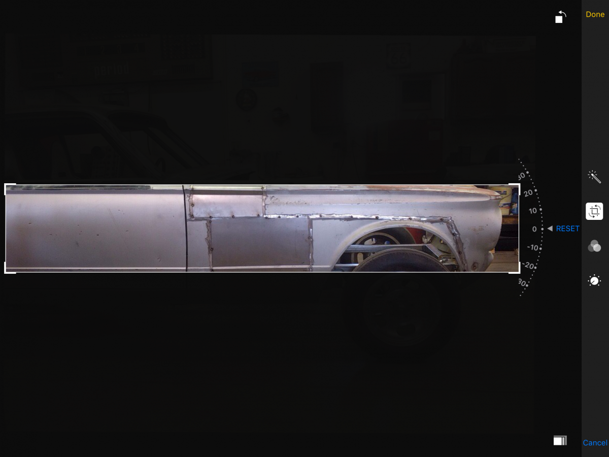

  19. I'd like it to sit nose down a bit
    I find looking at pictures helps, it's easier to focus on different things
    Especially when you start cropping.
    Don't hate me now - You didn't ask for it but here's my .02 on my observations
    If you want the fenders to look sorta right but stretched , that lower body line needs to come down.
    The upper line crests just about the door handle then continues down to the headlight at a pretty good slope and is no where near the door elevation at mid fender and certainly at the headlight.
    If your fender's upper line followed that without violating that line too much it would flow better. The extension has a dip, then the top of the fender at about the first third of the arch violates the line with a bump. Raising the extension and lowering the fender at the headlight would get your flow into mud range. It will never be perfect unless you'd make a new fender top from the cowl to headlight, but it doesn't have to be,

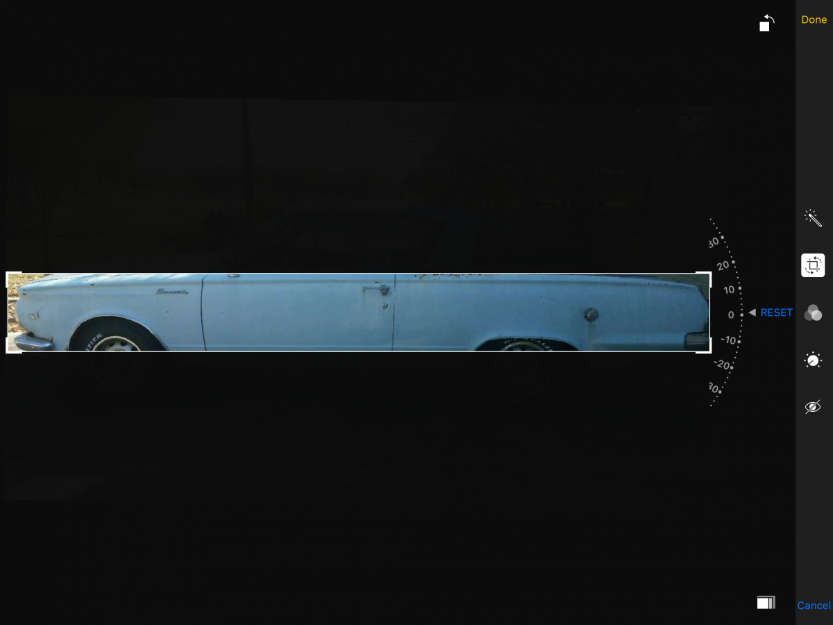

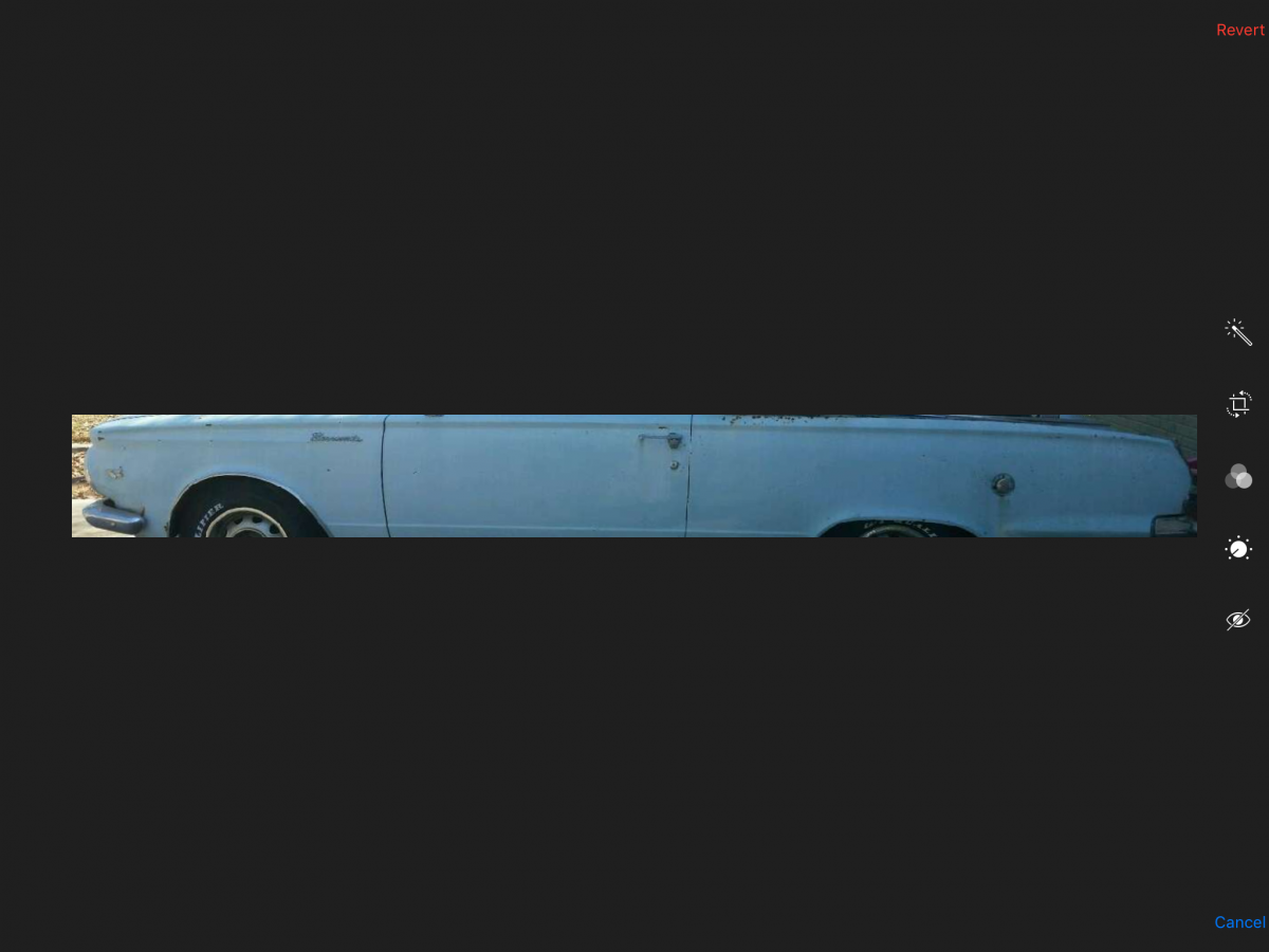

    If you'd print these out and cut them up, stretch the blue one out 15 " to scale and cut your pic to line the body lines up you'll see what the metal needs.
    Here's one trying to come straight off the door with minimal drop at the headlight ignoring the lower line. It still drops a quite a bit.
    Hnstray and loudbang like this.

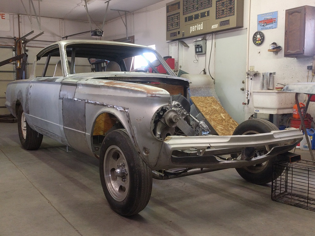

  20. squirrel
    Joined: Sep 23, 2004
    Posts: 59,918
    squirrel
    I plan to work on getting the lower line to be pretty much straight with some magical bodywork...and then adjust the front fender height to make it in line with the door. And let the upper line be where it ends up. I have been thinking pretty much exactly as you describe. Thanks for taking the time to make the pictures, it really highlights what's going on.
    The thing is, this is an old race car, built to go racing, not to satisfy the styling dept. I am OK with it looking "wrong" to some extent.
    It's a fine line, deciding how nice to make it...

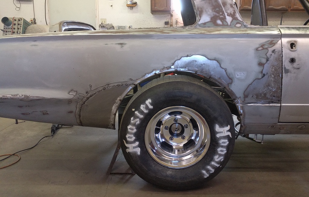

    Other fender is roughed out.

  21. 31Vicky beat me to the punch... Yep, the fender is running 'uphill' just a bit. And I also like that you appear to be filling the 'leftover' stock rear wheel opening. A slight flare around it would be perfect...
