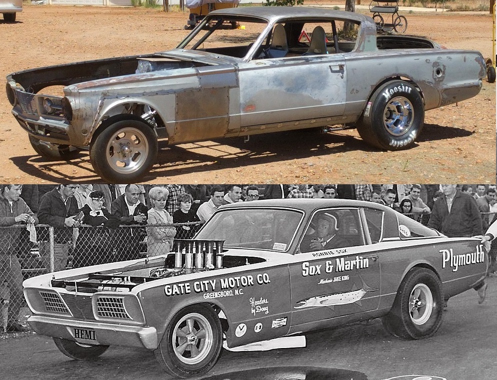

    ^^^^^ Know that's funny.
    loudbang and 31Vicky with a hemi like this.
  2. squirrel
    Joined: Sep 23, 2004
    Posts: 59,890
    squirrel
    yeah, there is some similarity!

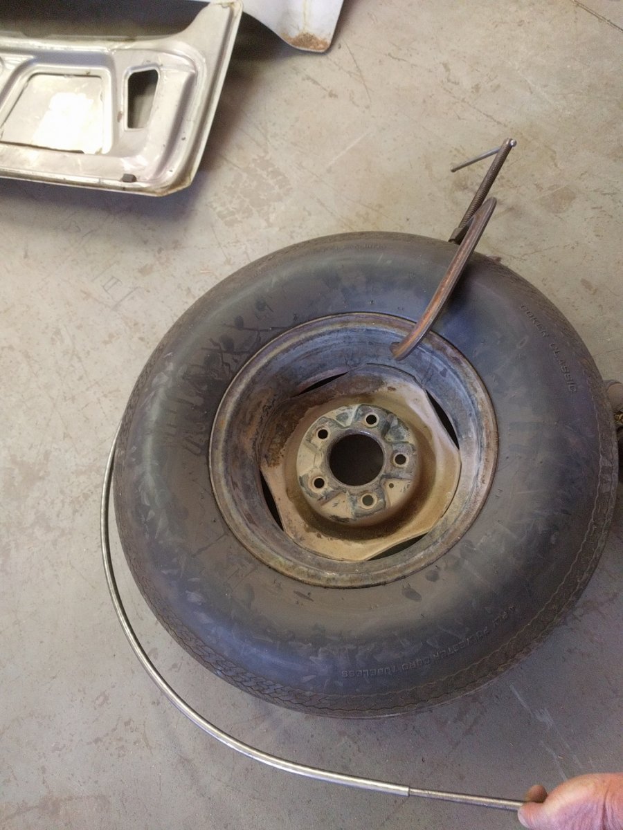

    think i saw someone on forabodiesonly asking about buying a stretched set in gl*** for a 66'? might be a market for these :cool:

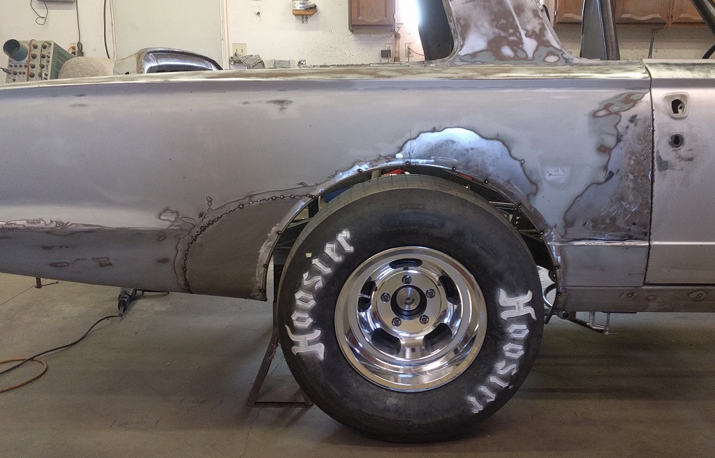

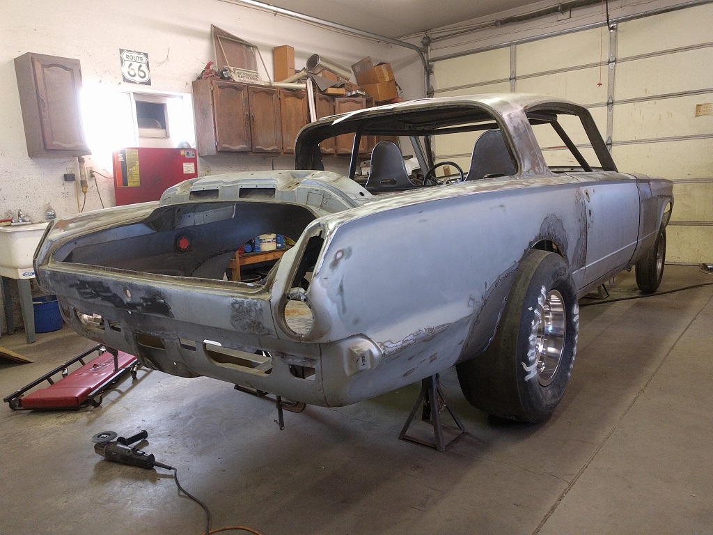

    pushed the car outside yesterday to look at the proportions, and take a couple pics. I think it'll look the part. Front should come down a little with more weight on it, and I'll probably play with the springs some.

    If you close your eyes and squint a little, you'd think the top pic is the bottom car, found in some barn somewhere last week, waiting to be restored to it's former glory!
    I'd say you nailed it Jim. You definitely have the vision down to the details.

    BamaMav I could not have said it better, when I went on Hamb this morning and saw the two cars I was amazed. I forgot about Ronnie Sox's Barracuda and wow that's going to be some wild street car that is sure to make magazine pages.

    What did you use for the fender lip?
  21. squirrel
    Posts: 59,890
    squirrel
    1/16" thick 1/2" diameter mild steel round tubing.
    I bend it to the correct curve using my new high tech mandrel bender :)

  22. rgdavid
    Joined: Feb 3, 2014
    Posts: 346
    rgdavid
    Its one of those new pneu-matic automatic portable benders,
    Roller Prototype perhaps ?
    Stogy and loudbang like this.

    The neat thing is that the tubing spring back is about the clearance you want between the tire and the fender lip.

    Jim, it looks like you are planning on Hoosiers for your slicks. Have you given much thought about what tire you would run on the rear on the street? Type, size, etc.
  26. squirrel
    Posts: 59,890
    squirrel
    see that tire that I bend the tubing around? That's the current plan, but subject to change. The Coker L78-15s off my Chevy II, but mounted on old Ford truck wheels. The tires tuck into the fender so I don't have to worry about them rubbing when I'm driving on the rough streets. I might decide to go with radials, we'll see how wimpy I get.

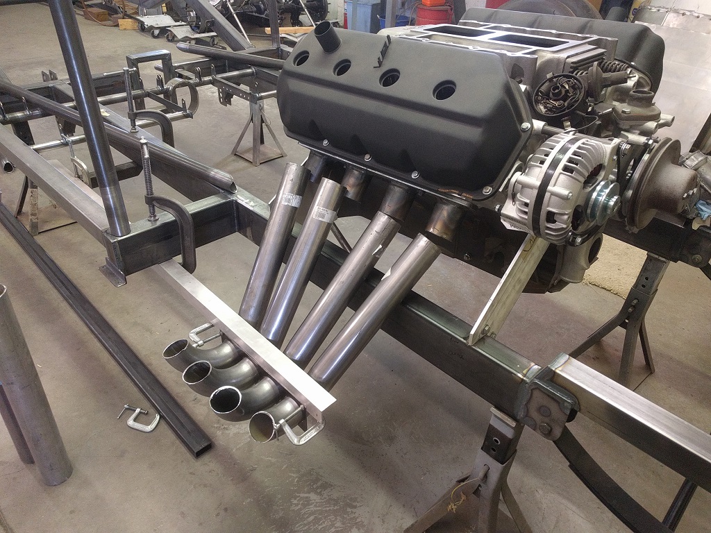

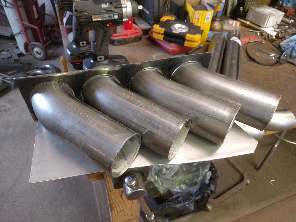

    Playing with the headers....I want zoomies...sort of... The early AWB cars mostly had fenderwell headers, but a few guys had individual pipes, usually long ones, angled back. I think I'll update this idea a bit, to more modern style zoomies but with the tips angled back, and flat.
    One interesting thing is that I need to be able to drive it on the street, and also go racing. In street mode, I want it to be quiet. I got a little taste of a blower motor with zoomies on the street last year, driving with Brian for a day. It's too much for me. So I plan to make a flange at the bottom, and be able to bolt on either the zoomie tips, or a collector. The collector probably won't be very efficient, but since it's just for street driving, it doesn't matter. Basically a log with a 2.5 or 3" pipe sticking straight out the back, connected to a muffler and tailpipe, that I will remove for racing.
    These pics are the first look at what is happening here. The pipes laying on the engine, would be cut at the flange, so the end sticks straight out sideways. I just haven't trimmed them yet.
