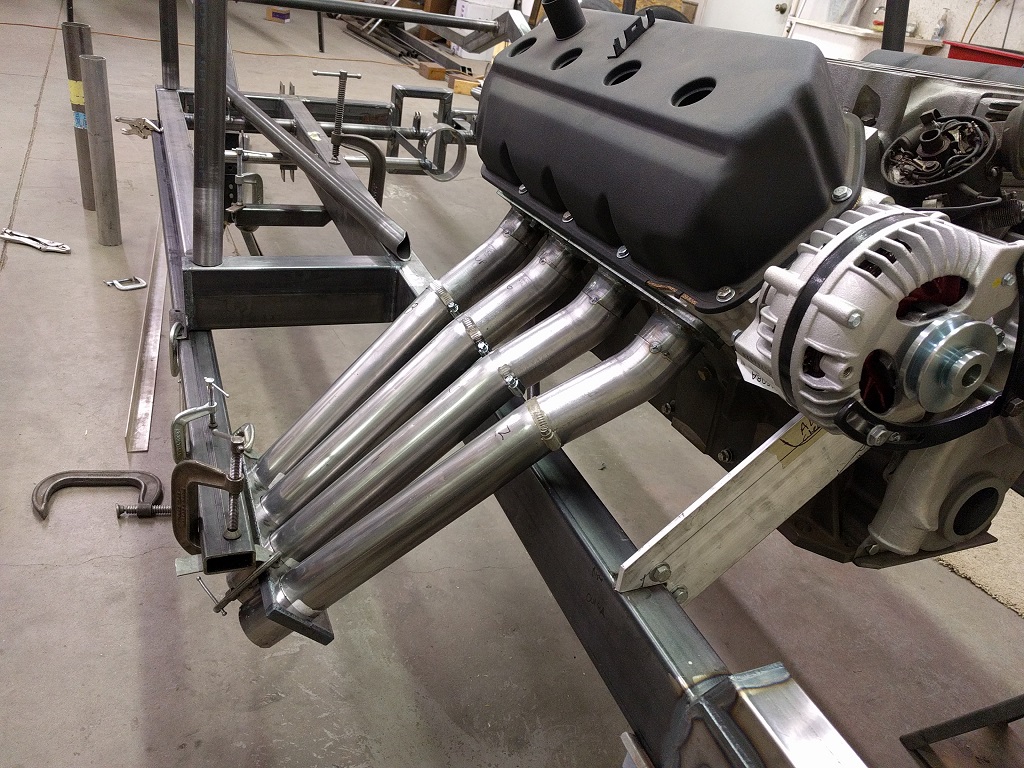

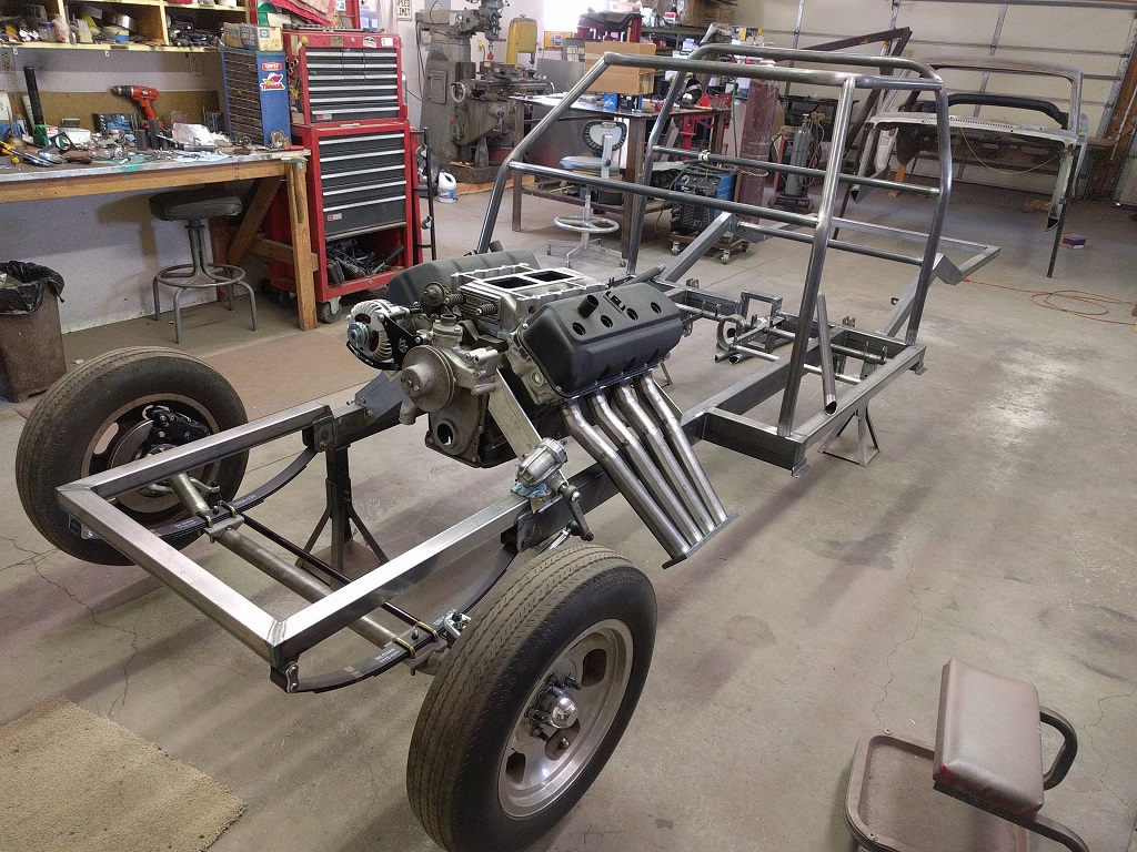

    Been tinkering with the exhaust more, I got one side pretty much figured out. I have part of the other side done, too.

    Got the headers both tacked together, they still need welding. And I need to make the funky collector, and the zoomie tips, but I'll probably put that off for a while.
    I started on the firewall, where the body needs to fit the new firewall which will be attached to the ch***is. I'm going to make a flange around the front body opening, with sheet steel, for this. I started by putting a piece on either side, then I clamped a piece of angle across, which I can use to visualize where the edge of the new metal will end up. We'll see what happens.
