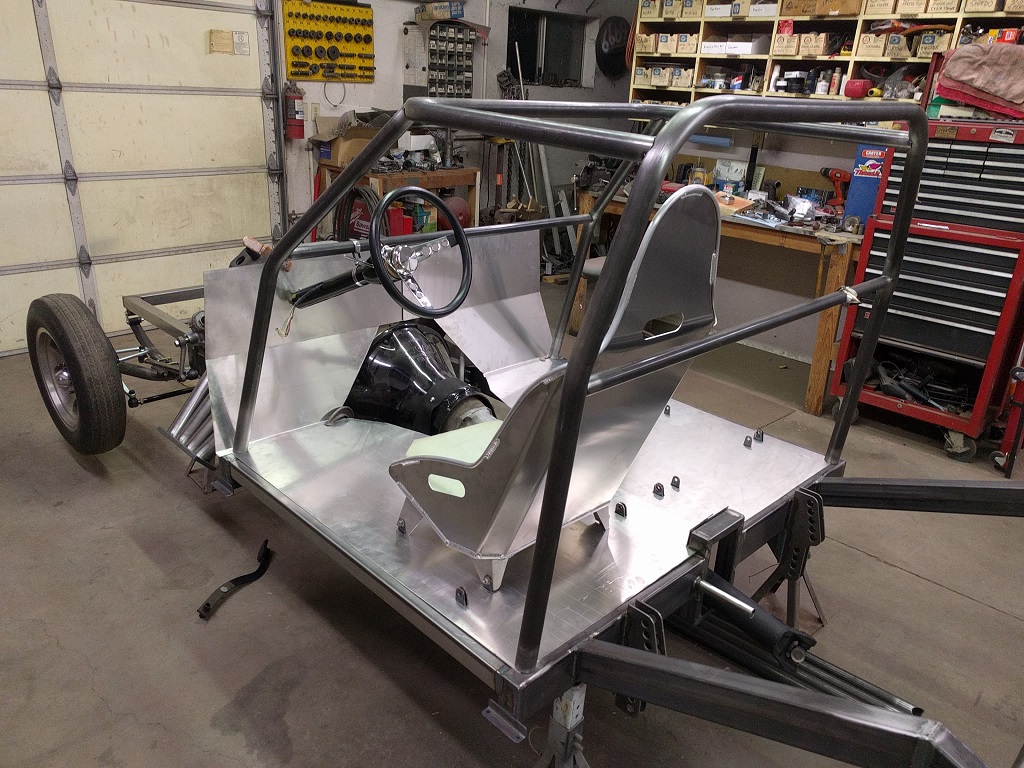

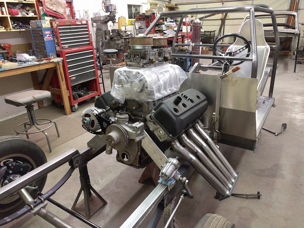

    My son is visiting, we got some more work done on the car. A long day.
    I cut the floor and firewall pieces, and we mostly made them fit. Still need to build the transmission tunnel. The cage is just tacked together, it is not attached to the frame yet.

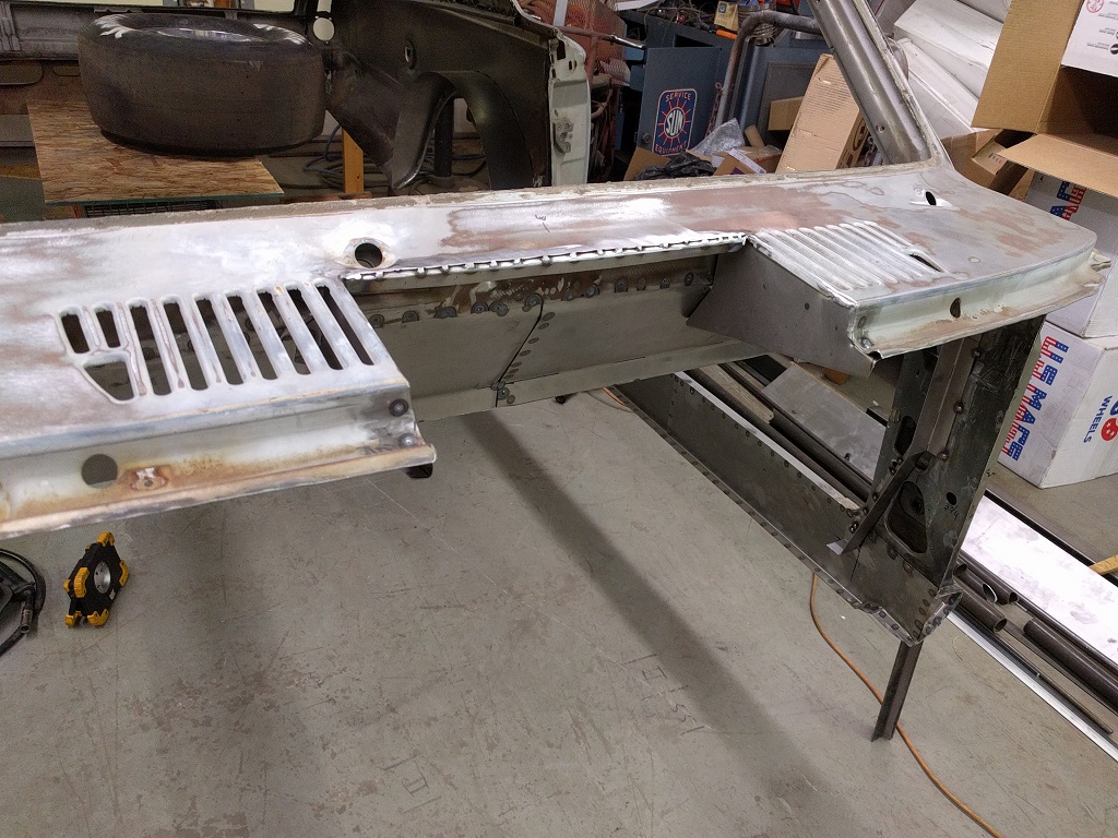

    I worked on the body quite a bit, made the opening for the firewall so it will attach to the aluminum part that is mounted to the ch***is. I also cut and reinforced the cowl, where the rear carb pokes through. We made the outboard part of the wheel tubs, spot welded to the quarter panels. And I did some t******* around the rear window, and added some tube reinforcement along the top edge of the quarter panels. Mostly done now with the major metal work on the body shell, so I can start the finish body work on it.
    also tested that the slicks do indeed fit through the trunk opening.
    We also worked on the brake pedal design, and throttle linkage ideas, and some other details. There's an incredible amount of planning that needs to be done to build a car mostly from scratch.

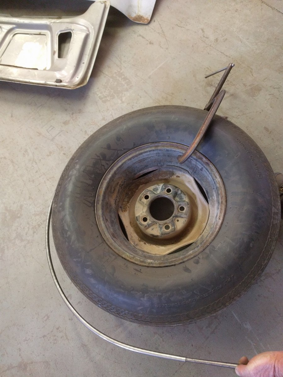

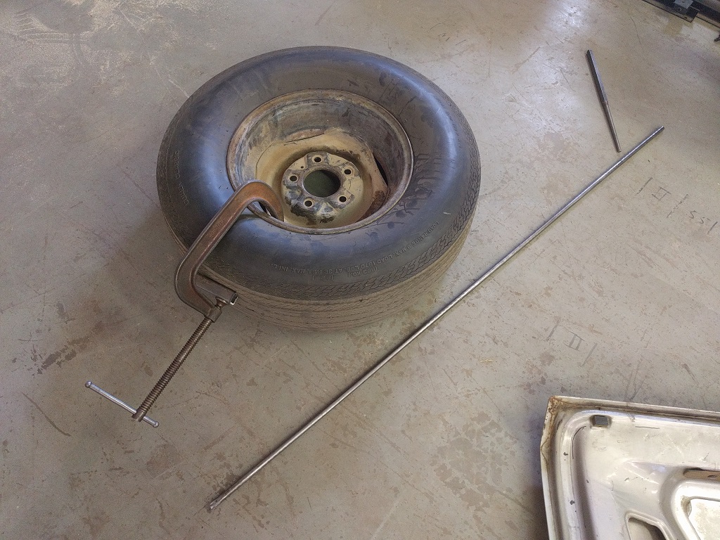

  20. Doctorterry
    Joined: Sep 12, 2015
    Posts: 686
    Doctorterry
    Hey, did you come up with method to decide what size wheel/tire to use to roll your tubing? Or did you use the guess and check method? I like the looks of it, I might wanna do it myself.
  21. squirrel
    Joined: Sep 23, 2004
    Posts: 59,929
    squirrel
    I used the guess method, it worked pretty well. I did something similar on the other car, so i have a little experience now.
