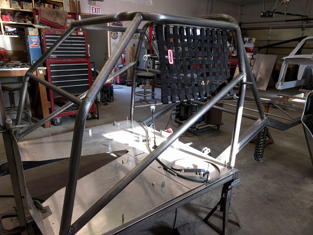

    We'll see how it goes. I've been working on installing some of the safety stuff, I test fit the 5 pt harness, and installed the window net hardware.
