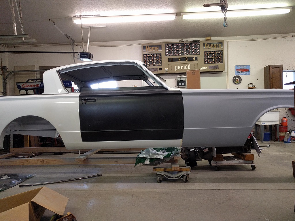

    I just had to see how the fender looks now that I did some bodywork on it...looks like it's supposed to.

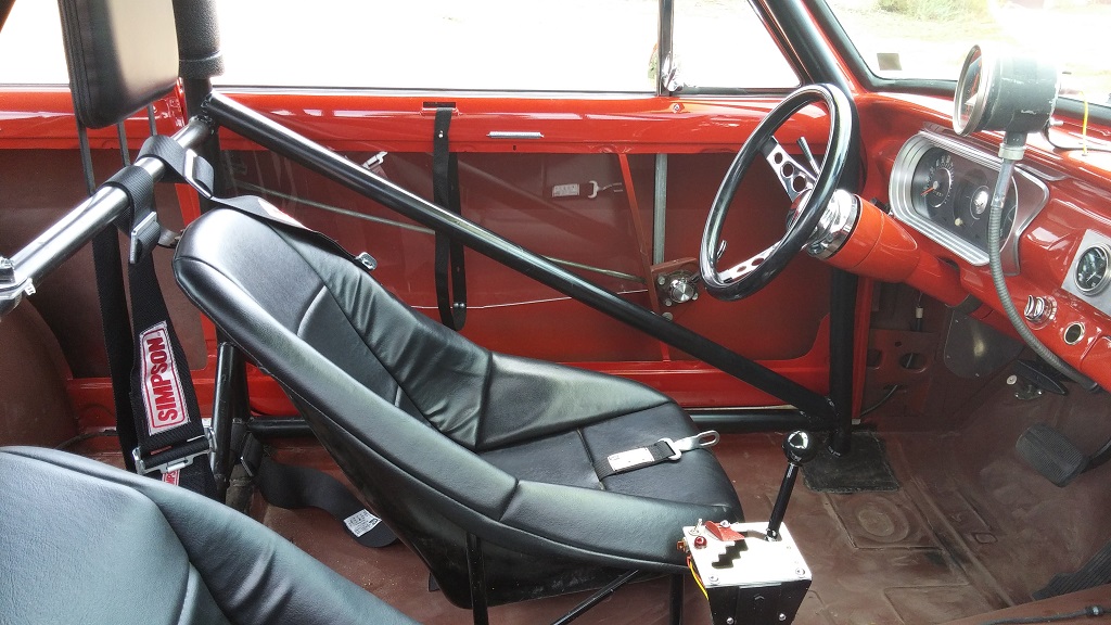

    I figured I needed a break, so I built the gauge cluster. I needed to weld tabs to the cage to mount it, and I kind of need to get all that type of stuff done before too long, because one day I'll have to paint it and put the body on for the last time, etc.
    I decided that looking at gauges through the steering wheel just isn't going to work, so they go in the middle, kind of high. The top of the cluster will be about even with the base of the windshield, by my line of sight when seated. There will be a cover plate that goes to just under the windshield, and I'll put the tach on top of the cluster, once I see where it needs to be. There will be another panel below the gauges, that will hold switches, etc. I wanted to make it separate so it would be easier to work on stuff.

    There's something cool about seeing a turn signal stalk on the steering column of a car like this. Really loving everything about this build Jim.
  12. Squirrel; Food for thought. I have found that once Belted in, reaching switches in the Dash could be hard to get to. My last 2 builds I finally switched over to the Top crossover bar on the Cage. Worked much better for me. Also I've noticed I never shift by the Tach. 4 speed cars by Ear and the Auto by signal. That probably don't apply to you in Vintage cl***. I can't remember what you using for a Gear Box without going back and finding it. My guess would be a 4 speed. I can't tell if there's a pedal under that left foot in the above photo.

    it's a Torqueflite, manual shifted, no clutch pedal. I'll see about the controls on the dash, I didn't have any trouble reaching it when I was sitting in there last night, figuring things out.

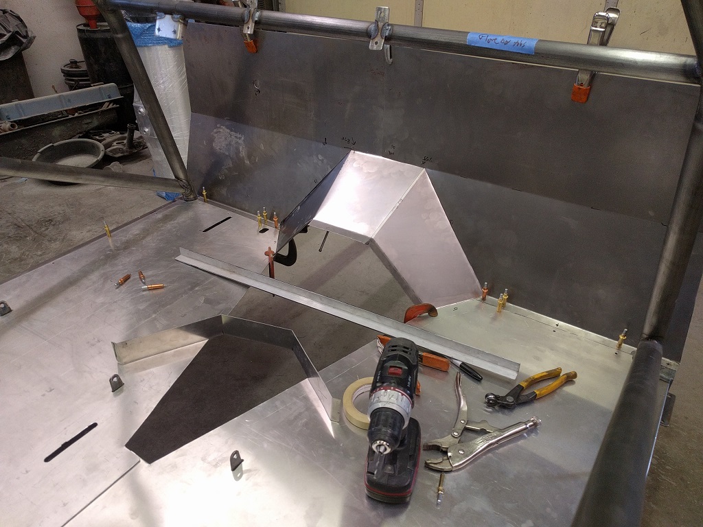

    Moving on to the firewall....I worked on the front of the transmission tunnel, today. I decided to make the firewall, and this part, from steel, I originally had it aluminum, but some thinking and more reading of the rule book changed my mind. Something about fast cars with power adders requiring either a steel firewall, or expensive pants and gloves.
    Anyways, it was fun making this part, and it sure stiffened up the firewall!
