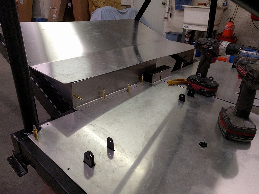

    Been kind of busy on the car, not much progress seems to have been made, though. The frame is black, the floor is getting worked on. I have been figuring out things like where exactly to put the battery, how I'm going to do the cooler lines, what plumbing I need for the fuel system, etc. And I got into the transmission...I needed to figure out what other parts I needed to order, so I cleaned up and sorted all the parts from the two donor transmissions, and I think I have it all figured out.
    The floor, at the beginning of the trunk. I need a few more Clecos.
