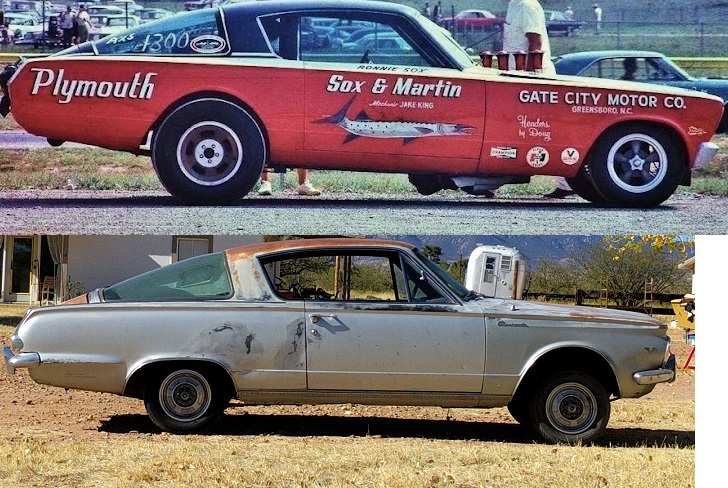

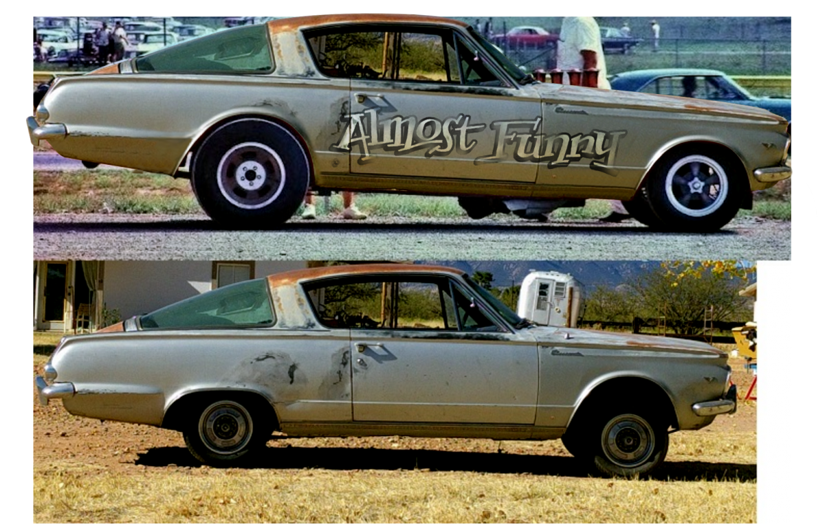

    The Chevy II is a nice car, the way it is. It sort of captures one moment in the funny car evolution. But the Barracuda will be very different, and will sort of capture a different moment.
    Anyways...first thing is to come up with a plan. There is so much to think about, it boggles the mind.
    The look of the car has to be right, and looking at a bunch of pictures of old cars, a few stick out as having the right look. And of course, when they were being built, they were built that way to function as desired, more than to look right.
    To figure out what the magic numbers are, I did a little bit of fooling around with Paint, using the resize function to make an old picture match the scale of a new picture of my actual car. Then I played with the printing size, so that I could print a copy that would have a known dimension read correctly when I measure it with an engineering scale. Then I can use the scale to measure the dimensions on the real race car.
    It looks to me like the wheelbase is stretched out to 117", from stock 106". The rear wheels moved forward 8", the fronts about 6" relative to the fender. And the back part of the fender was stretched about 15". It doesn't quite add up, but it's close. (The Sox and Martin car is a 66, which has different bodywork at the ends than my 65)

    OK, I took off the dual antennas for you guys. Jeez.
    @squirrel

    Love the photo shop rendition and the duplicate antenna base on the front fender when it was stretched in the photo shop process. All in all should be one heck of a build. I'm in for the ride.
