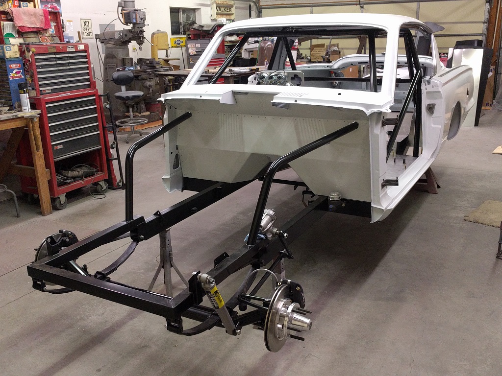

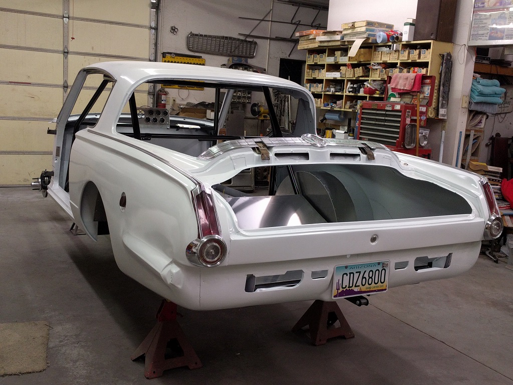

    I've been working on the "tin"....finishing up the second wheel well, made the transmission tunnel, then I'll do the rest of the trunk floor. I'll see about getting some fresh pictures up soon.
    chryslerfan55, Sancho, Stogy and 2 others like this.
  15. squirrel
    Joined: Sep 23, 2004
    Posts: 59,908
    squirrel
    a few pics. Still working on tin, but it's getting there...

    Chrome and plates already!! You will be down the road in a week or two! Ralphie

    The plate number looks fit to the car too. Just a coincidence....like everything else on this build....
    Sent from my XT1254 using The H.A.M.B. mobile app
