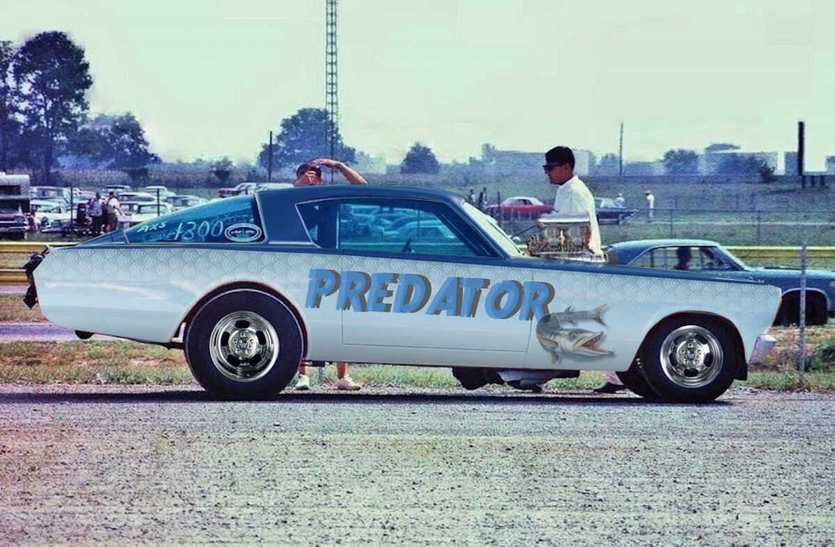

  8. Runnin shine
    Joined: Apr 12, 2013
    Posts: 3,383
    Runnin shine
    After years of working in a body shop using cardboard and hearing all the cons of it, try telling the boss who thought it was frugal recycling, I finally broke down and got an aluminum thingy from HF. Although I love that it always easy to use and doesn’t buckle under spreading pressure. I must say I hate cleaning it every time.[emoji35]
    Although Jim may have seen this @madfish took the one the moose did and tweaked it.
  9. Johnny Gee
    Joined: Dec 3, 2009
    Posts: 14,340
    Johnny Gee
    from Downey, Ca
    OK mystery solved on my end. The wording here indicates moose is a person and not an animal. A capital goes a long way in understanding. Yes, I'm complicated. :)
  10. Runnin shine
    Posts: 3,383
    Runnin shine
    Not complicated just one more example about how I need to better self edit.
    The Moose is world renown for his H.A.M.B. photoshop work.
    I of course have no business on this site if I don’t know what a Elephant motor is[emoji6]
    PS I suppose he used a shark as it was something he had quick and easy.
