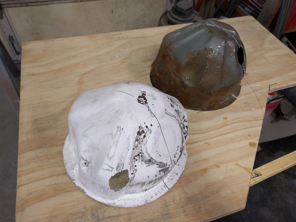

    Thanks for the tips! I have some 1 oz mat, which I considered using, it probably would have made it easier.
    Anyways...as I figured might happen, the release didn't work right in a few places, because I did way too little surface prep on the plug, and also the draft of the part is pretty much non-existent, so I ended up cutting the plug part way across to get the part out of it. I have a few of these to play with, so it's not a big deal. The part I made is useable, with just a little bit of work, but I think I'll try making a two piece mold, with a flange through the middle of it, to see how that works. I plan to do some tricks with the flanges on the fenders I have to make, so this would be good practice.
    I only had one area where the mat didn't lay into an inside curve and the gelcoat separated when I pulled it apart.
    Fun stuff. The 'gl*** part weighs half as much as the steel part, but I made it a bit thicker than I thought it should be. I think 20 mils gelcoat, and two layers of 1 oz mat might be what I'm aiming for.
    As for the successes....I did a good job of estimating the amount of materials to mix up. I think I got the "wetness" of the layup pretty good, it was fully wetted, but with texture showing, no smooth glossy areas that would indicate too much resin. And now I have a better feel for what it takes to get the mat prepared ahead of time, I was kind of going blind on that.

    Anyways...I decided to make the second headlight bucket the same way I made the first, and it worked ok. I made it a bit lighter, not so much 'gl***. I guess I need to just go ahead and try to make a fibergl*** mold of a fender, and see what happens.

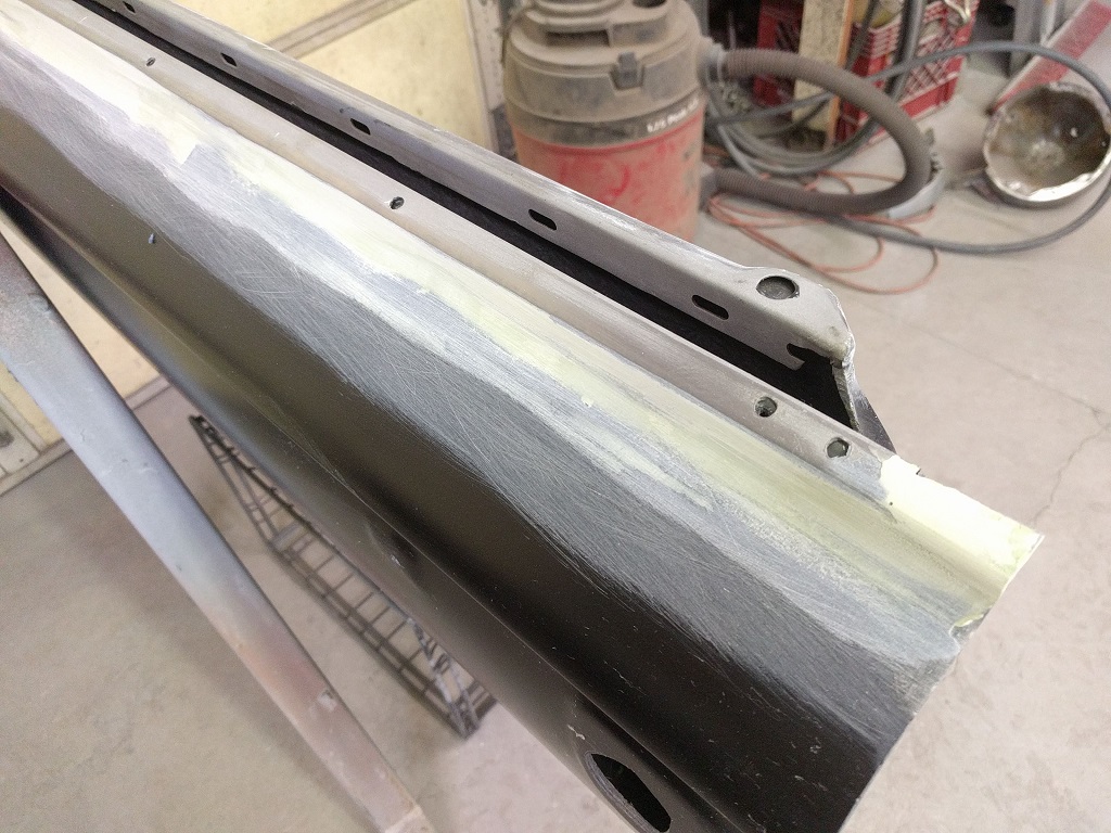

    Been working on the doors some more, trying to get them all finished up. I have most of the weatherstrip now, but not all, the roof rails were back ordered, and i goofed on the first pair of quarter divider rubbers I ordered, so I had to order the right (hopefully) ones. I cut the windows for one side, used my old band saw, and a laminate blade in the jig saw for the pieces that wouldn't fit the band saw (mainly, cutting a 20x30 in piece in half). I trimmed the edges with the power plane, then sanded them a little with the DA with 180 grit, they have that frosty finish on the edge, which is fine.
    I'll have to do some work to get the door gl*** to behave, and I can't really finish the quarter window until I get the rest of the weather strip.

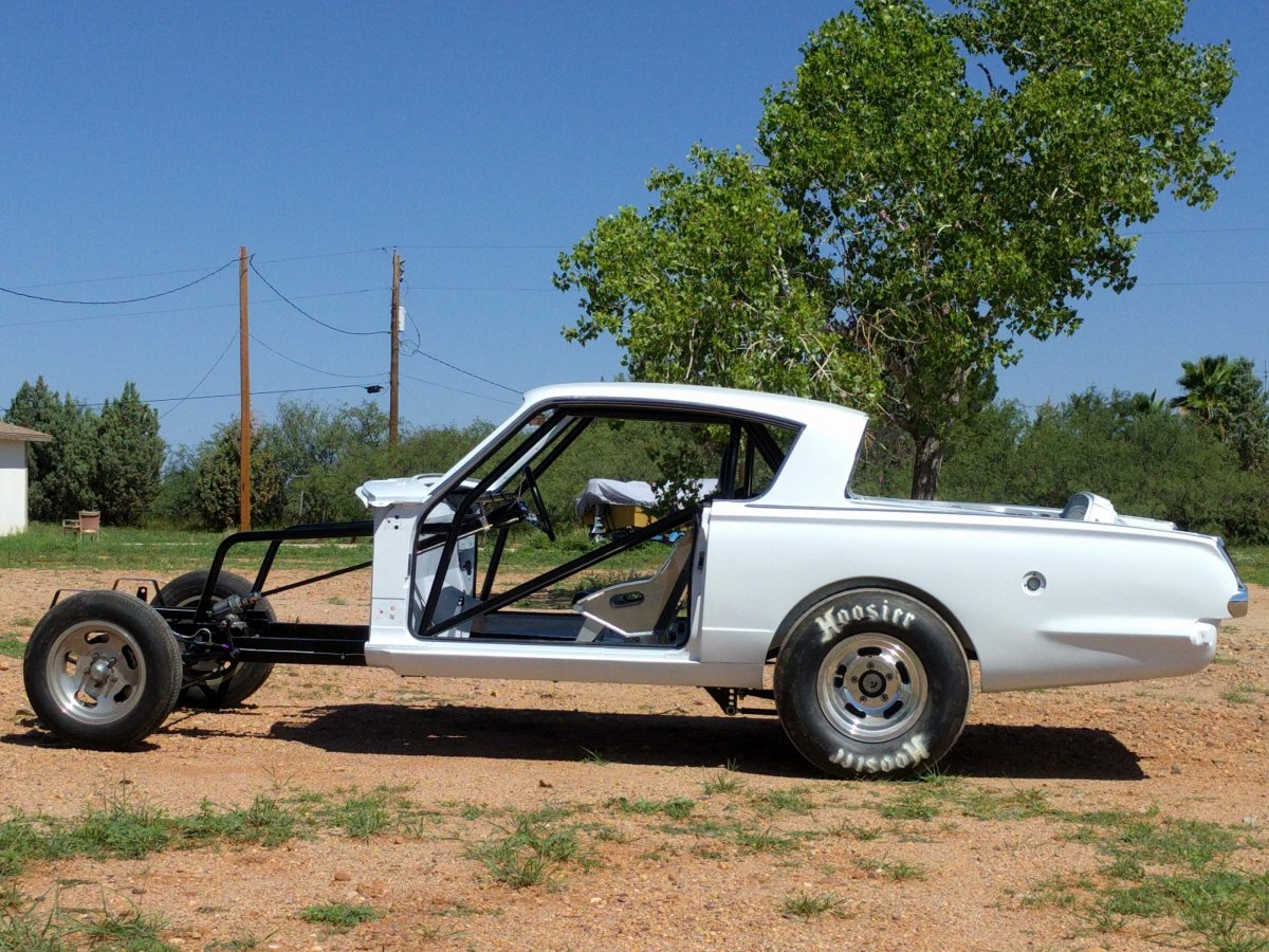

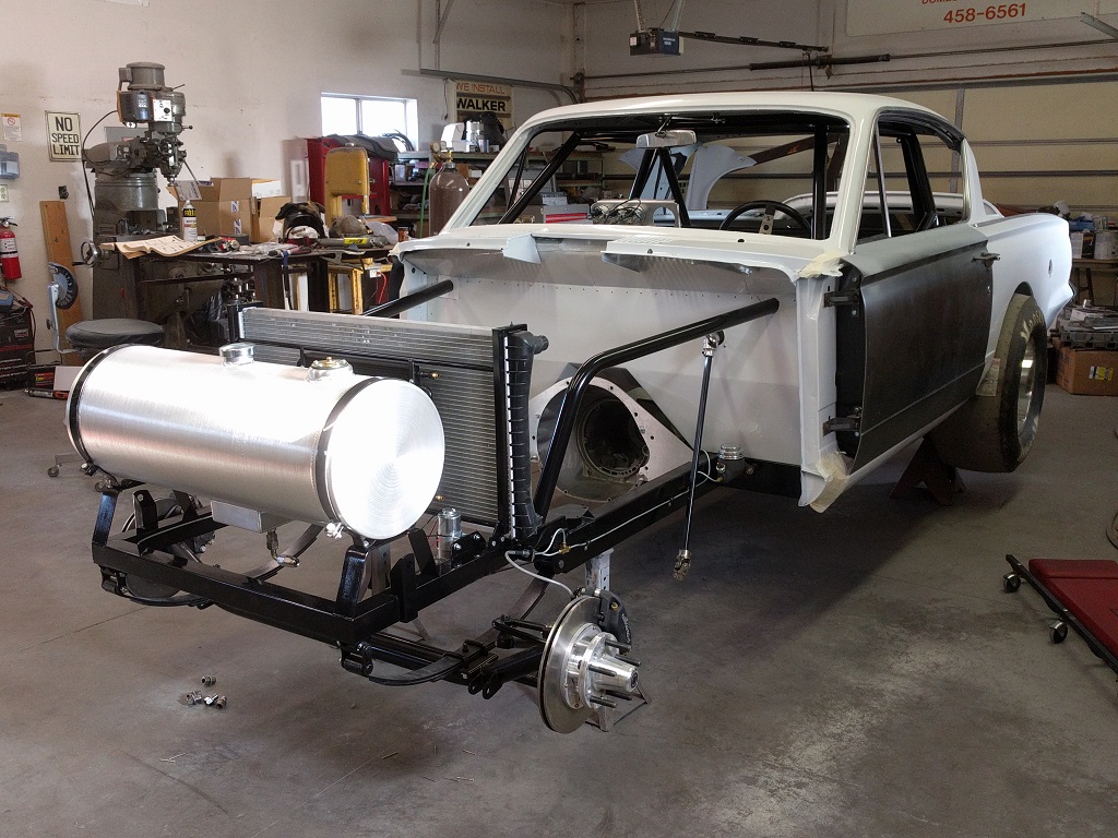

    anyways...I've been tinkering and getting a few things done. Not much for pictures, sorry. Gas tank and radiator and transmission cooler mounts done, battery box secured, front floor riveted in (except the transmission tunnel). Fit the rear bumper, got the door "gl***" sort of fitting and working on one side, door locks in and working. Painted the front of the frame, after welding on a few more brackets, then plumbed the brakes. I also spent some time staring at the shifter, and figuring out how to make it come through the floor gracefully, so I can seal it from weather, sort of. I had to slightly modify the mounting bracket to move it up and over just a skosh. I also made the linkage for the shifter and the throttle valve, using hex bar stock and Heim ends (I bought a couple left hand thread taps just for this).
    And tomorrow I plan to haul it up to Tucson and see about getting the cage cert. Wish me luck.
