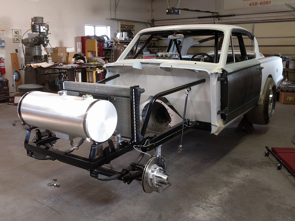

    I don’t want to be the negative guy, but the fuel in the front? that is the first thing that gets hit in a accident.

  10. Every dragster; funny car; altered and countless other cars mine included have the tanks up front. As long as there are some bars protecting it there is no problem. The tanks up front also act as ballast to keep the front end down.

    Also, I'm not done adding supports for the front fenders/grille. This will include some protection for the tank.
    Don't build a car like this, it's dangerous, things could go wrong.

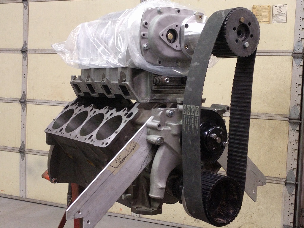

    The crankshaft showed up yesterday. Unfortunately, it's the wrong one in the right box. So I may be stuck.

    it's a 4.150, mopar journals (well...that's what it's supposed to have, anyways). They are going to try to get me another one here by the end of next week, if they can ship it out this week. We'll see how it goes.

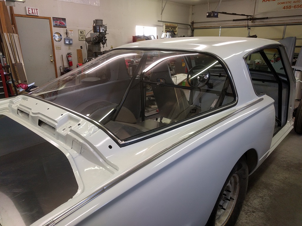

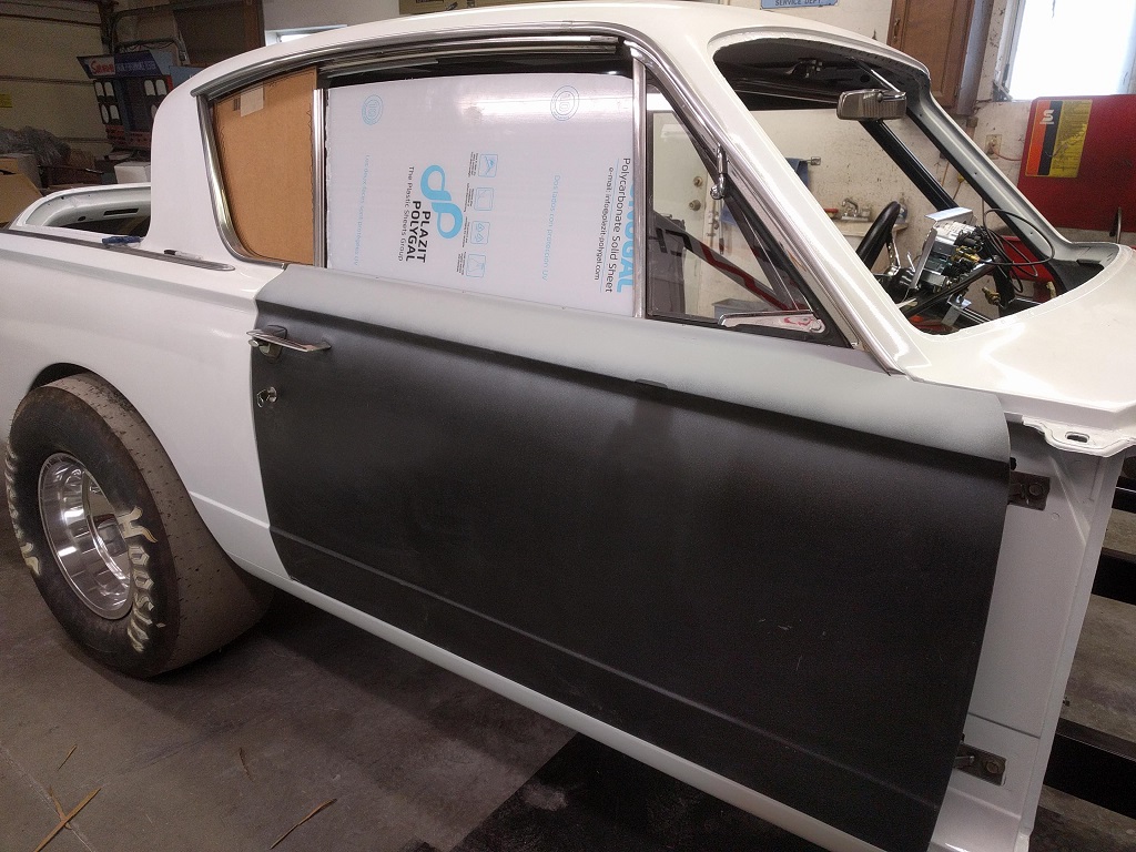

    Anyways...I did a little blower mocking up to see if I have enough parts to make the drive work, I think I only need one spacer, I have an idler bracket on order. We also installed the windshield and back "gl***" yesterday, and I'm about ready to put some paint on the doors and trunk lid. I'm still plugging away at it.

  29. The gl*** looks great. What was the problem with the crank? Did you buy a stroker?

    they just somehow put a crank with 2.2 rod journals, in a box labelled for a crank with 2.375" journals.
    so the rods are a bit too loose on it.
