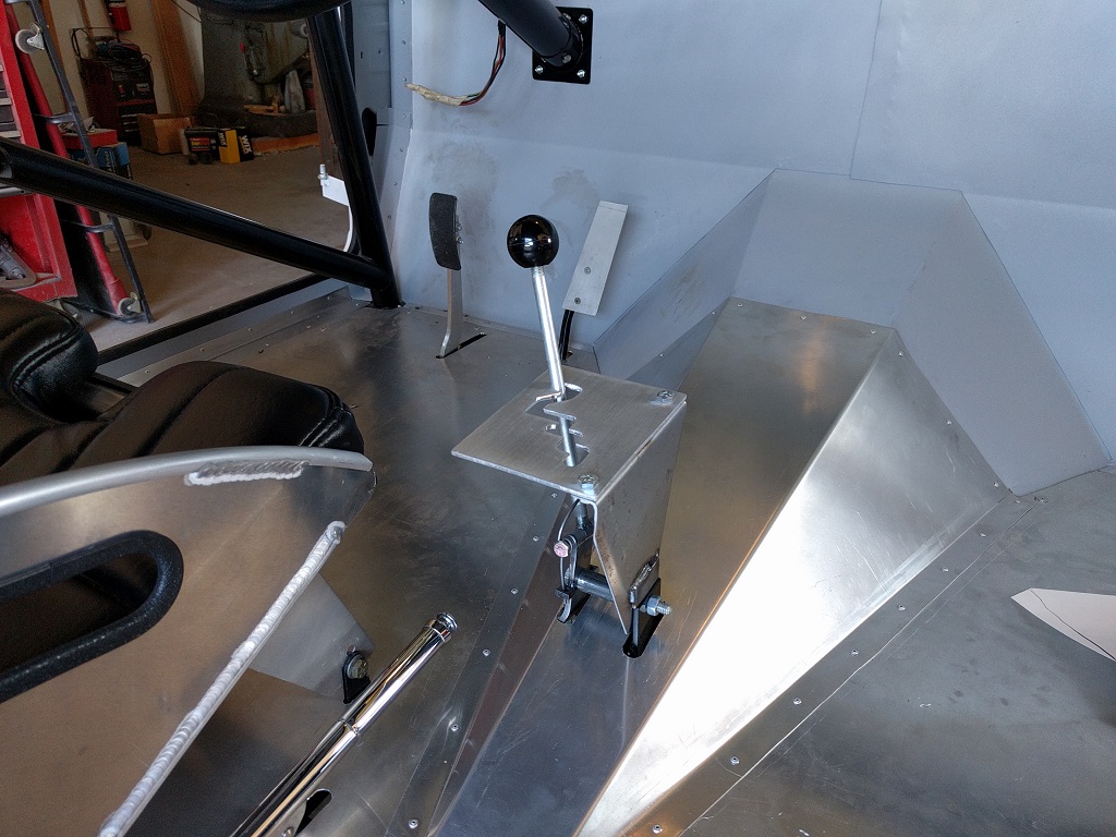

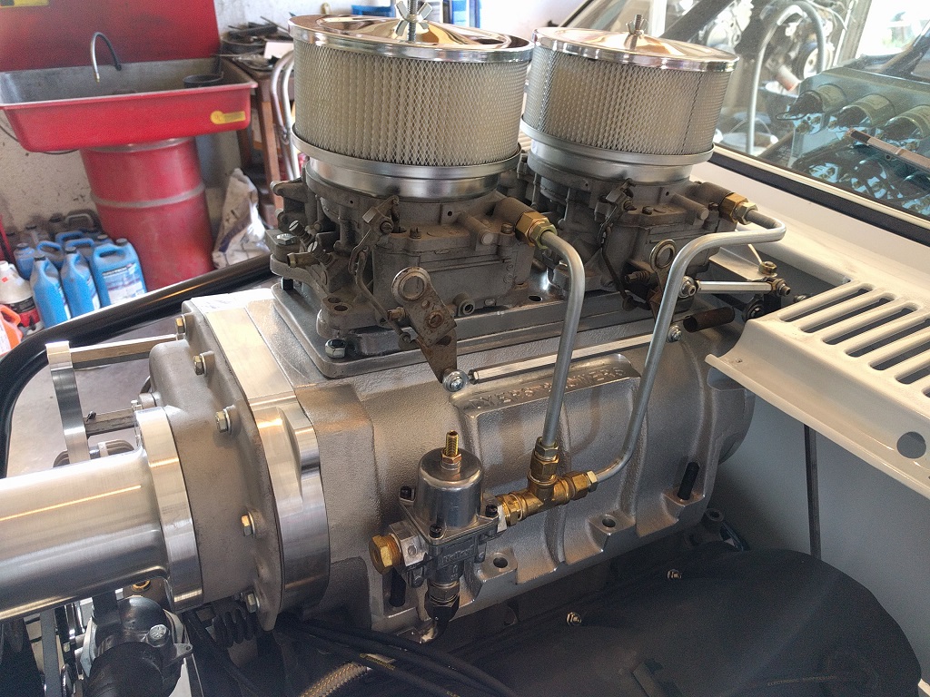

    Got the throttle linkage and carb end of the fuel lines mostly done. I still need to mount the regulator, and do the return springs. And the floor tunnel is in place, with the shifter sticking through it. I have to make the reverse lockout, it will sit on top of the gate plate.
