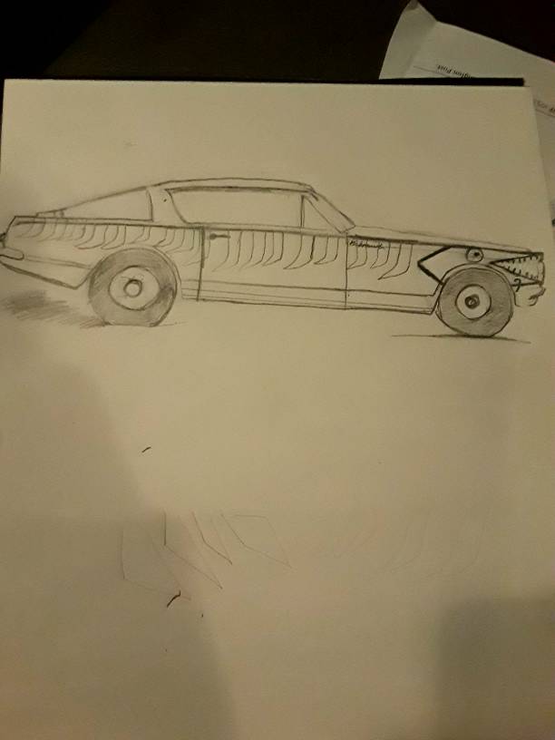

    Hey Squirrel, your always one of the ones helping me out with my off the way questions, I appreciate your patience with me so I drew you this today. Just a concept. I'm following your thread and learning.[​IMG]
    Sent from my SM-J727T1 using The H.A.M.B. mobile app
    enloe, Tim_with_a_T and loudbang like this.
  19. squirrel
    Joined: Sep 23, 2004
    Posts: 60,033
    squirrel
    :) That will scare the guy in the other lane, I'd always win!

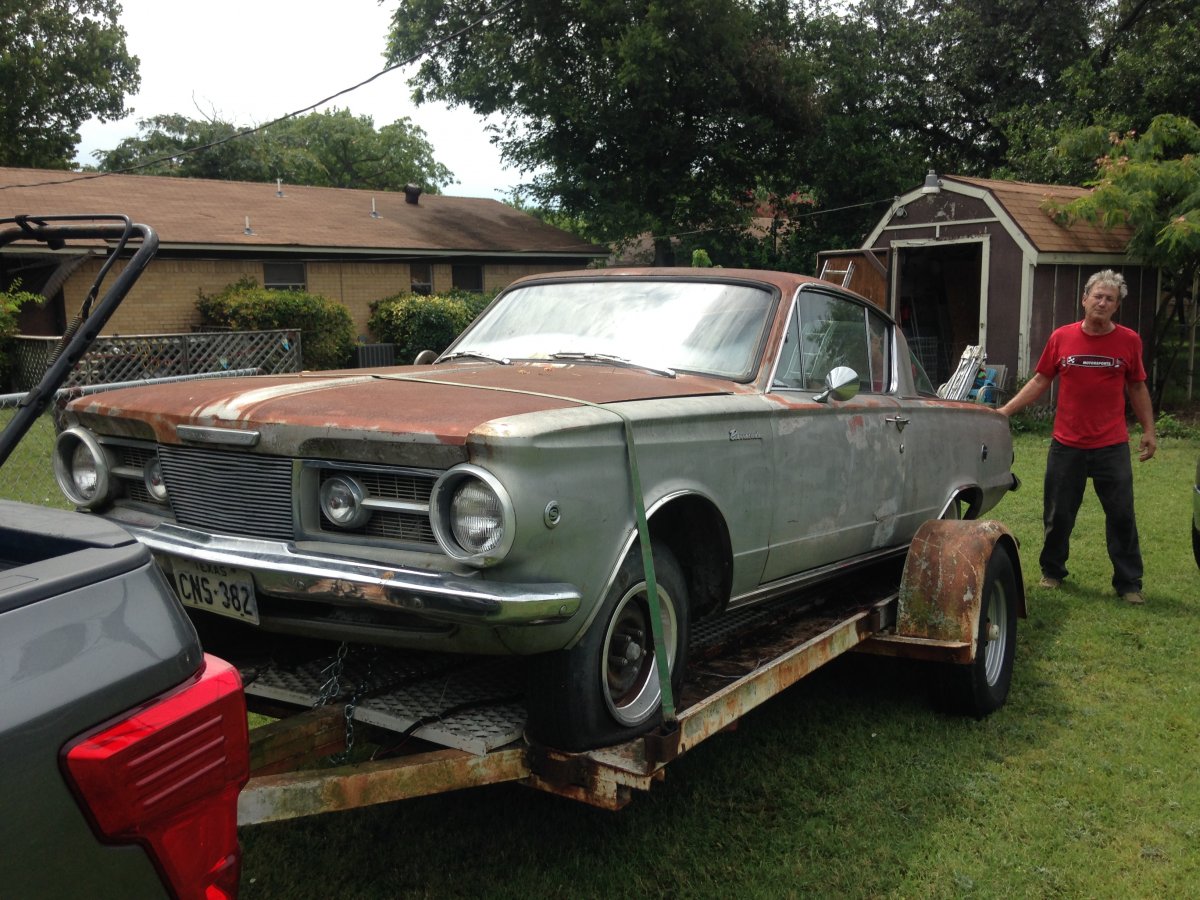

    Jim....I'm in...keep me in mind for the left overs....getting a 1965 Formula S 4sp back on the road after 37 yrs or more off the road...near 20 years on a trailer....silver too....and on that trailer ! IMG_4436.JPG
  23. ClayMart
    Joined: Oct 26, 2007
    Posts: 7,809
    ClayMart
    ...And a "Formula S" to boot! :cool: With a Commando 273 as well...? :D

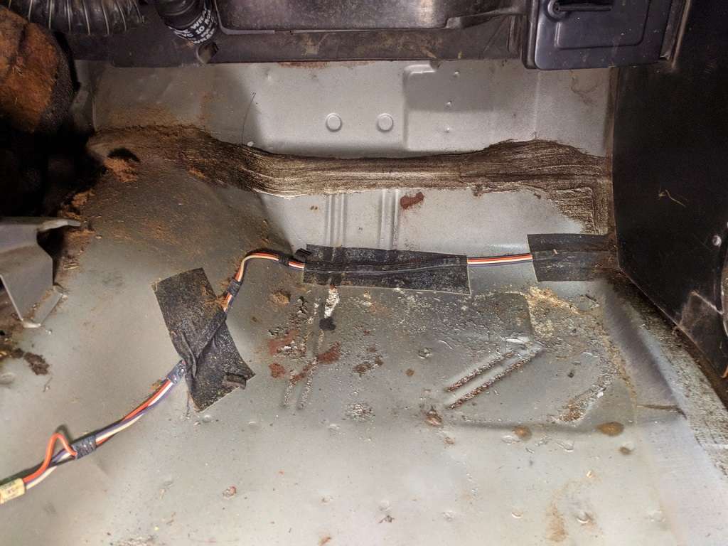

    I expect the car will sit level, or close to it...won't have the way advanced rake that the Sox & Martin car had.
    I got quite a bit of the interior out of the car. I guess it's Murphy's law that the car you are going to completely cut the floor out of, has perfect floors... :( Hopefully someone can use this metal to fix another car.
  27. That is clean! I've told customers for years, buy the Best car you can going in so there is less labor to pay for and nothing to hunt for. Get's the job done quicker.
    The Wizzard
  28. squirrel
    Posts: 60,033
    squirrel
    That's what I was thinking...I hope to not spend much time fixing sheet metal. Although I'll spend a bit of time making fibergl*** replacements.
