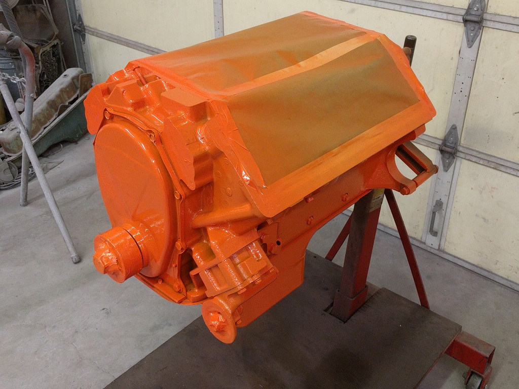

    been puttering around with the car...the short block is together and painted, heads might be done tomorrow. Started on the wiring stuff, but haven't got very far. Still a lot to do, but there's still a week to work on it.

    I would be losing my mind if I had a week and my shortblock was still on a stand.
    Nerves of stainless steel!

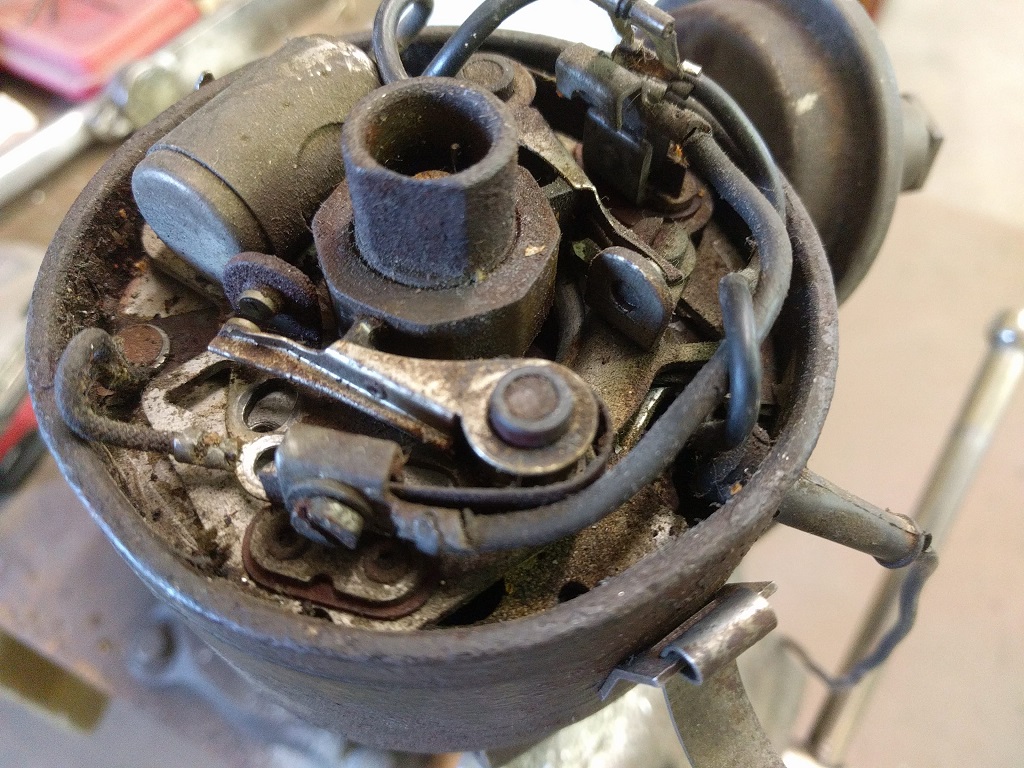

    I'm playing with the distributor today, got it apart and cleaned up and mostly back together. Tach drive dual point Prestolite, has a ball bearing in the top. I am going to run an electronic tach for now, until I put more time into the cable situation, etc.
    hopefully the new points fit.

    Jim, I had a Prestolite dual point in a 1970 340. It kept changing time on me and I found out by holding the rotor and twisting it that some part of the shaft that was pressed together would allow it to slip and change timing. (Best description I can come up with after 46 years ago memory)

    this one seems to be tight, but I'll keep an eye on it. thanks
