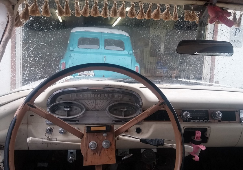

    forbes2016edsel-adventure.PNG forbes plan2.PNG Jim, I held off until late in the build to ask about a critical item to p*** inspection, the all important horn ****on.
    in 2016 , the edsel adventure, it was a piece of 2x4 and a doorbell mounted it the center of the steering wheel.
    In plan 2 it is on the column left side, you said due to column issues you had.
    My 57 column ****ed too and had to be replaced.
    So how did you engineer it this time?
    I still laugh every time I think of the edsel horn ****on
    -Bill

    this one uses the horn ****on on the steering wheel, and it actually works. For now, at least. The Mopars had a much better contact system than GM or Ford.

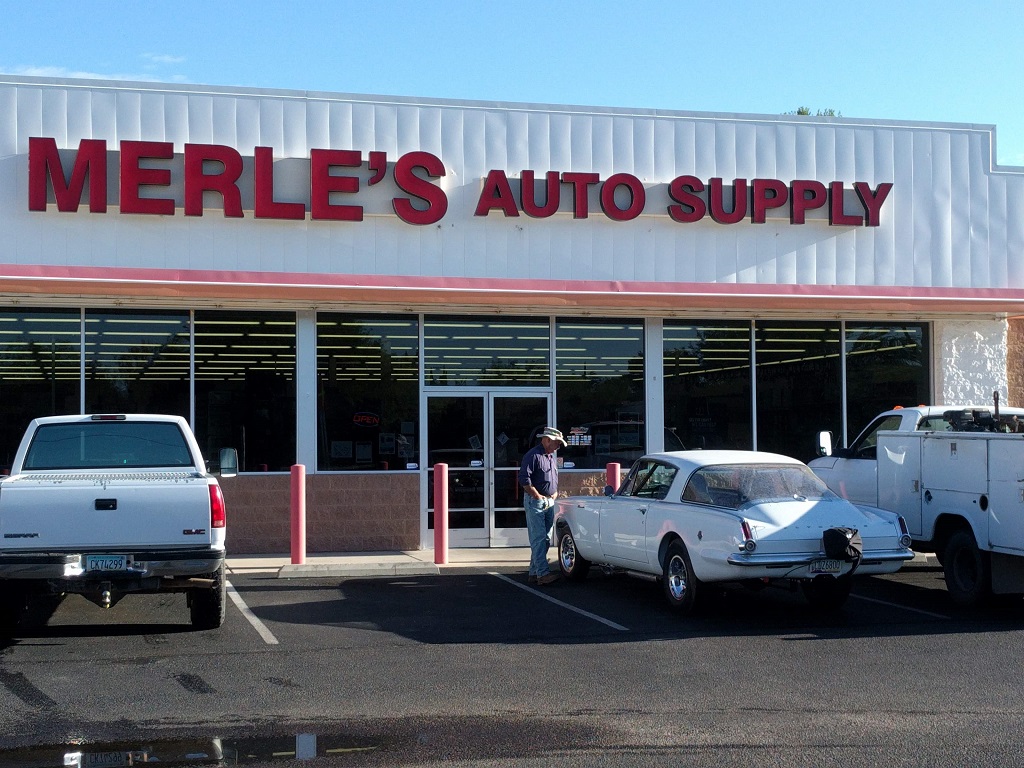

    You're lucky that some hooligan didn't "unpack" your chute for you in the parking lot at Merle's.

    That parking lot observer is saying "that thing got a hemi"!

    It looks almost docile sitting there at Merle's. We all know better, but you have to admire how understated your builds tend to be. You just put stuff where it needs to be... no flash required.
