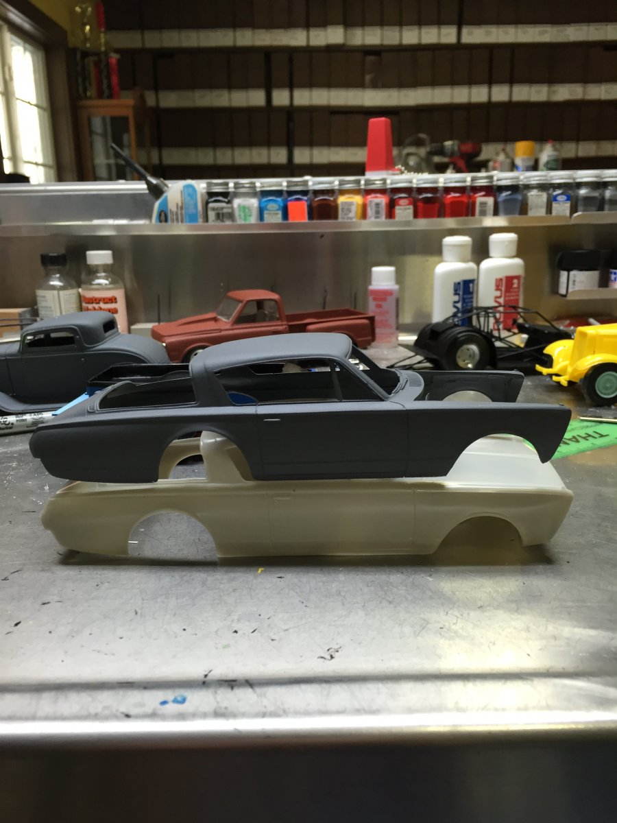

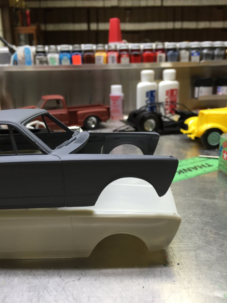

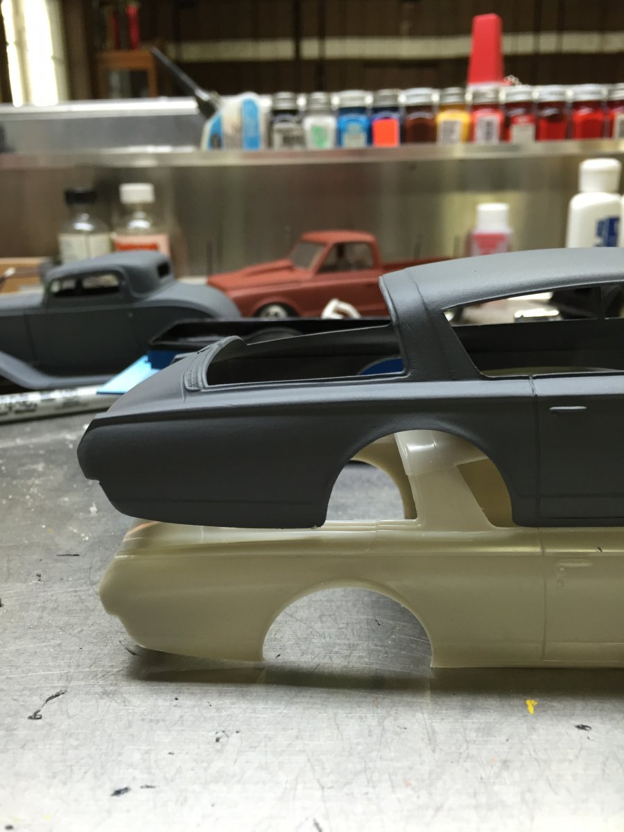

    I apparently like the idea, built this a year or so ago!
    SPark

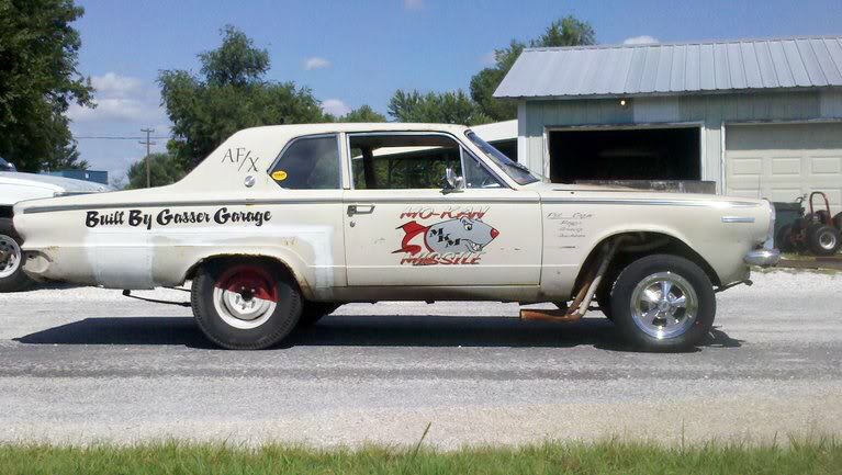

    Jim I like what you have planned when I built my 64 dart afx that you blew off the street in Joplin with your 55 lol I moved the rear axle forward 12" and the front 6 and it was just the right look I I'm sure you will figure out the best amount to move it but just thought you might want to know here is a side pic of
    Chrome don't get ya home

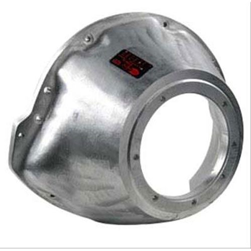

    I'm still up in the air about the transmission. A Torqueflite would be really neat, I need to talk to a few guys about them. A clutch/Lenco would also be really neat, it is possible to make it work....but it's a bit modern for the car, I think. A TH400 is the easy way out, I'd like to figure out something else, but it's good to have as the back up plan.
    I was looking at the back gl*** tonight, and it might be able to curve without having to thermoform it. The radius is pretty big, and I held a piece of 1/8" Lexan over it, it does not take much force to make it follow the curve. But I'll keep you in mind.
    The big Mopars with the rear end scooted over a foot forward do look wicked, but they also tend to drag the bumper all the way down the track...not quite what I have in mind :)
  27. DDDenny
    Posts: 22,564
    Clutch Turbo 400's are hot again, a little more period compatible then Lencos.
    http://www.lyonsperformance.com/clutch-hydro-p-465.html
