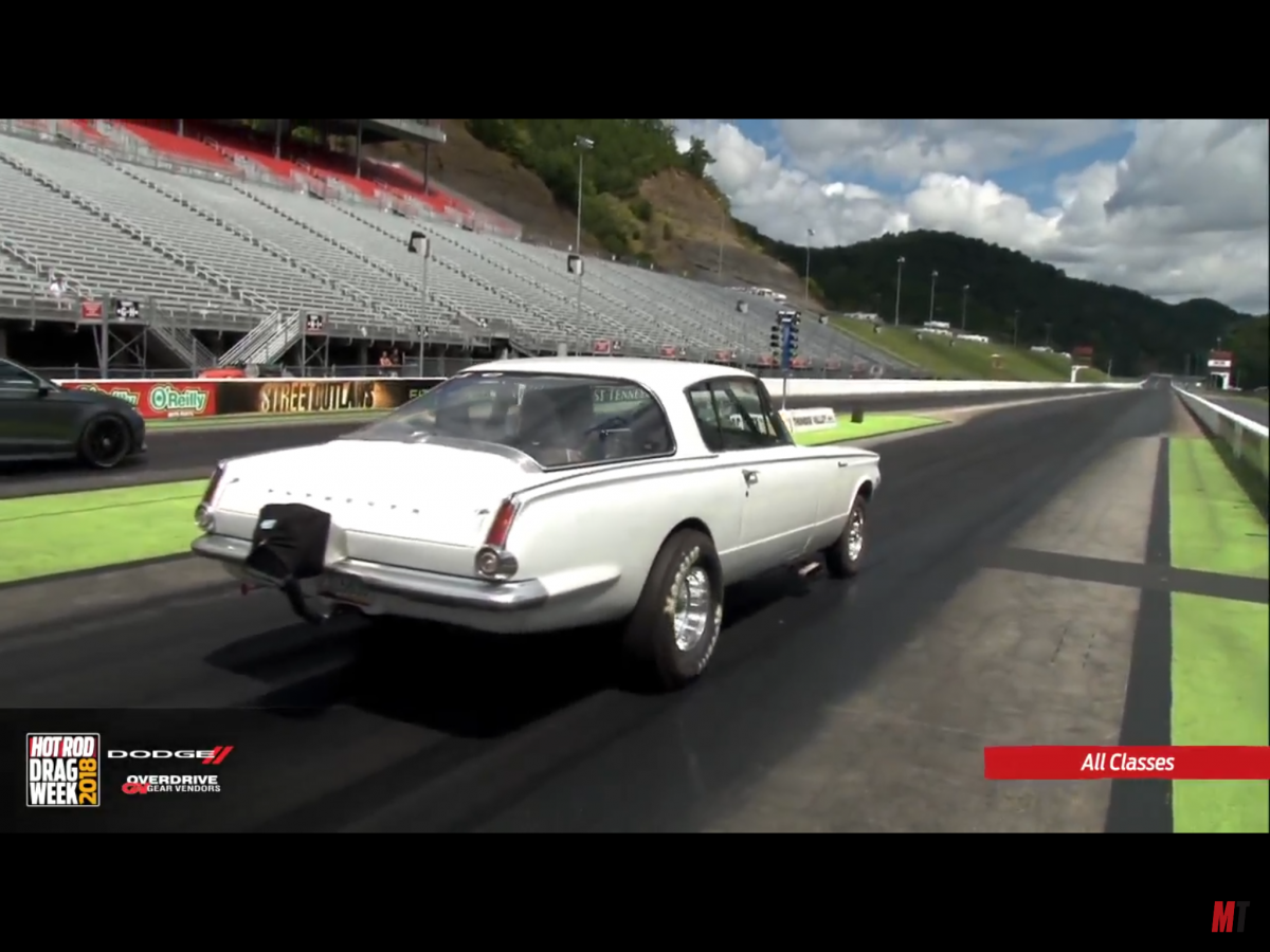

    Hi finally got a chance to look at the hamb. Busy day. We got the car ready to run after they closed the lanes for cl*** cars. Then there was a long clean up. I decided to try to get the tach working. I also adjusted the points and we left the air cleaners in instead of the scoop. I got some parts and made a tach filter. It worked! So now I can see how fast it's turning. I ran pretty late. The weather was nice so I figured it would be OK to run late. The car ran good until about half track, it felt like it ran out of fuel or spark. I shifted around 5000, there's more in it. On the way to Atlanta now, dinner in Ashville.

    Something simple, make sure there is no moisture in the distributor cap. I've had that bite me before after being in heavy downpours and felt like an idiot when I found my problem. Since it leaves good then comes on half way down, I doubt that's it. Sounds more like fuel.

    • Jim you said you left those puny little air filters on it, I gotta wonder if you were starving for air, not gas.

    I'm trying to grasp the lean fuel diagnosis but the puff of black smoke when you let off.

    The puff of smoke is letting off, With a blower they do that, Close the ****erflies, You still have a blower full of fuel... Hence the smoke, I had a blown stick car...

    Thinking about things, I'll probably just put the slicks on and make a real easy p*** in the morning. We're kind of burned out on working on the car, and I don't really want to run it hard when there is something seriously wrong that makes it pop and miss so bad half track. I'm not going to place in my cl***, no matter how fast it goes, so there's no real reason to try to break it now.
    I guess it's something to be able to finish this thing with a car like this... :)
    The best part is how many folks come over to look at the car, and say how bad*** it is. I think they're right, it's a neat looking car. I'll get it running eventually...right now I"m thinking that it really needs mechanical injection on the blower, and an old mag, and it'll wake up.
