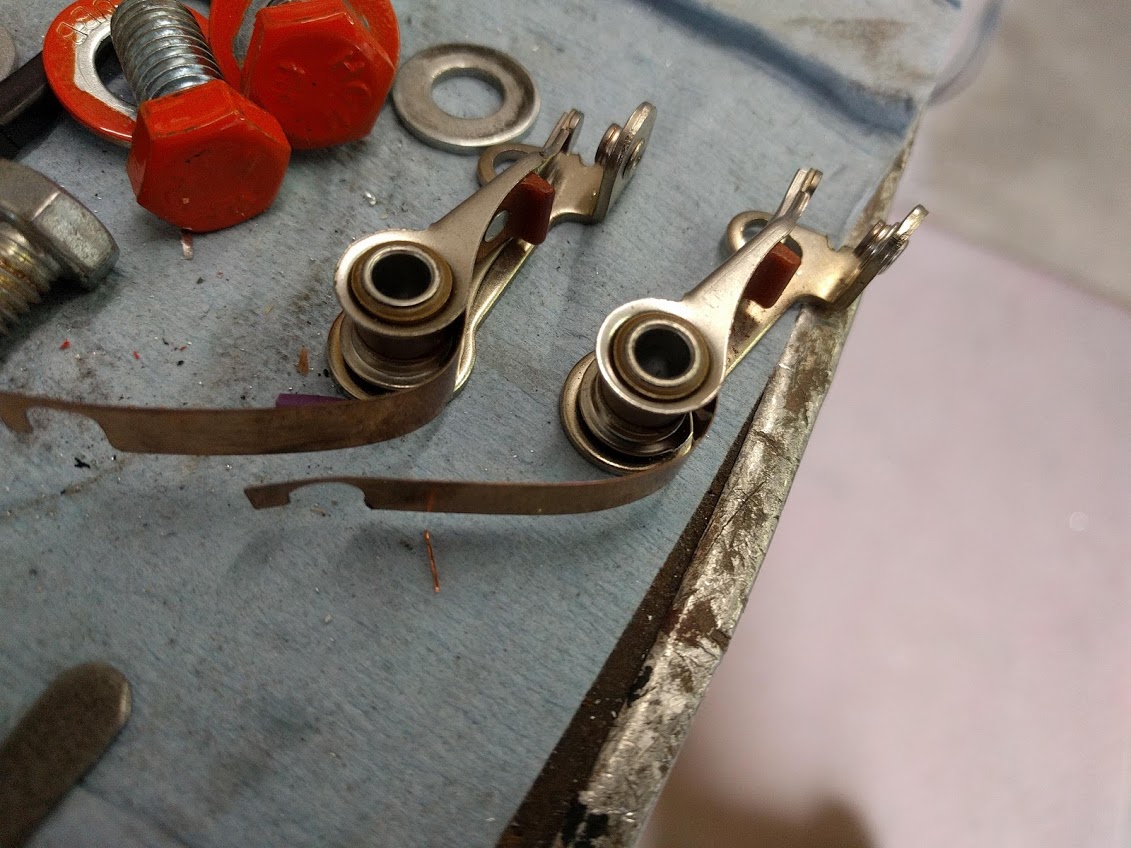

    Old school trick from waaay back...
    Cut off a short chunk of vacuum hose and tuck it behind the points to increase spring tension.
    Only used to check for point bounce (test or strip), not full time (street).
    You didn't mention if you have another set of points, so this WILL wear out the rubbing block if used for long.

    This happened to me! I was chasing my tail until I found a very old set of Accels... Installed them, and problem solved!
