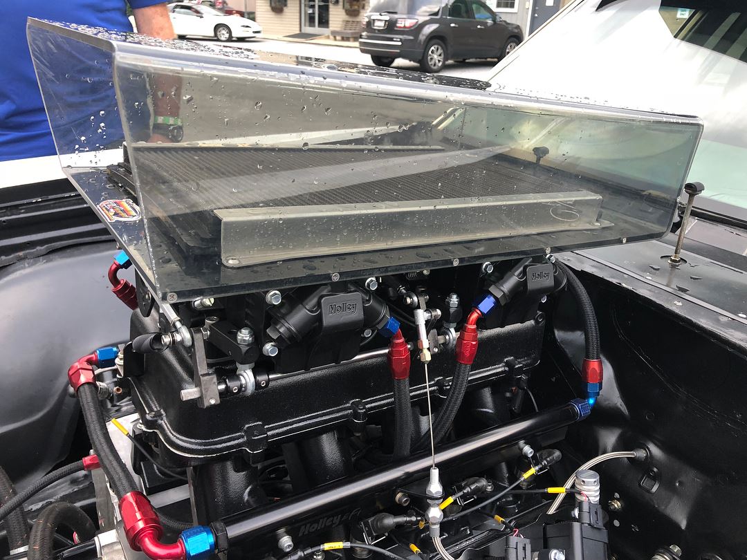

  23. glrbird
    Joined: Dec 20, 2010
    Posts: 601
    glrbird

  25. Brand Apart
    Joined: Jan 22, 2011
    Posts: 815
    Brand Apart
    from Roswell GA
    That is clever as you said but won't look right on Almost Funny
