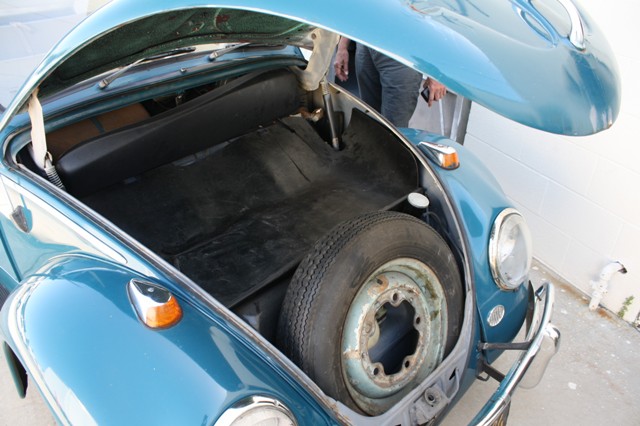

    Are you sure you got room to store the injection unit inside the car with everything else ?
    Maybe you could put it on the roof for direct air injection on your head while driving...ha ha ha

    Once the hood and new fenders are done storage shouldn't be an issue.
