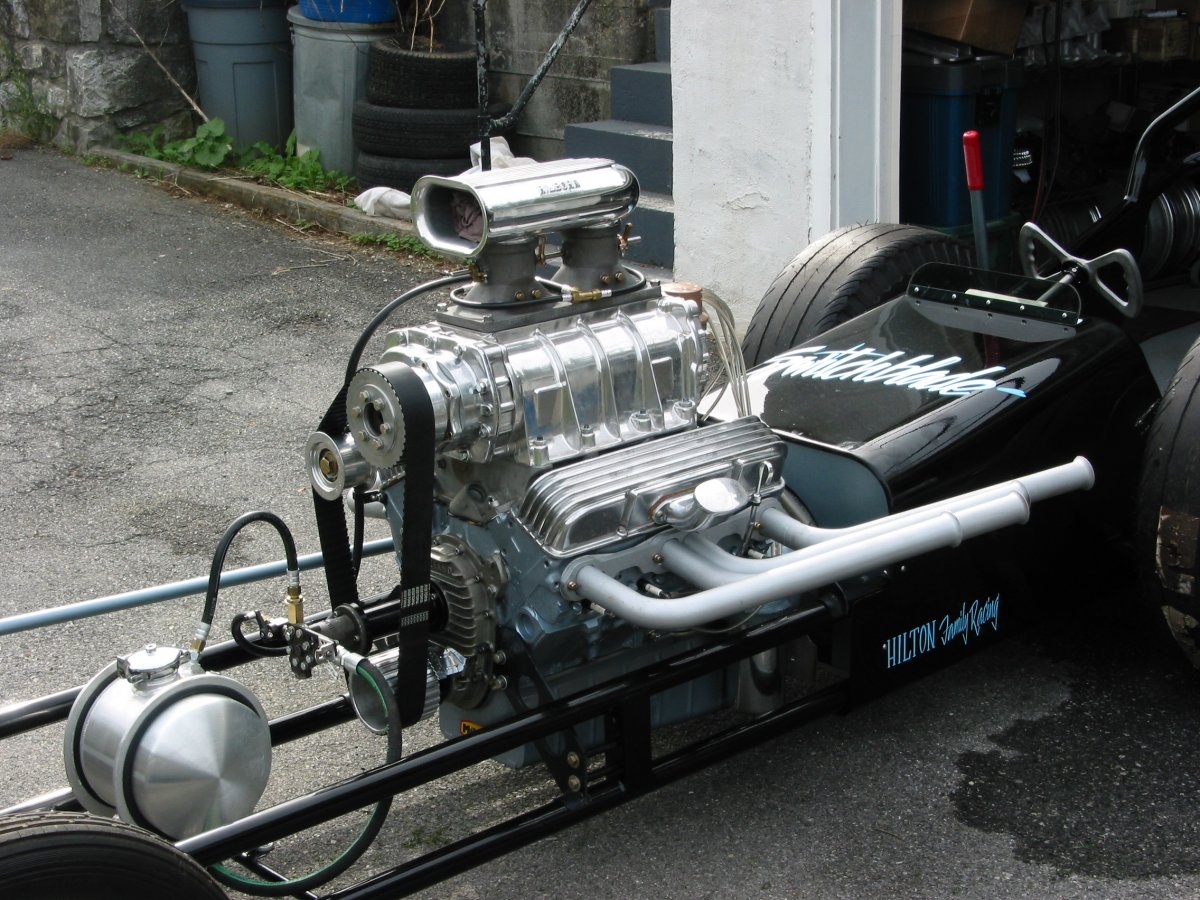

    Here is the two port setup on our dragster... Four Bolts on the blower and a single fuel line to barrel valve.
    May not have the "look"..

    ^^^^^ Jim, clarify port for me. I understood early in this post you didn't want it. In your defense, I took it to be at the base of the intake runner just before the head/heads. That's why I posted that style injection on the FED.

    Cool. 61cad's set up sure would be a lot easier.

    that's pretty much what I have in mind, but using a hat instead of a vertical port setup.

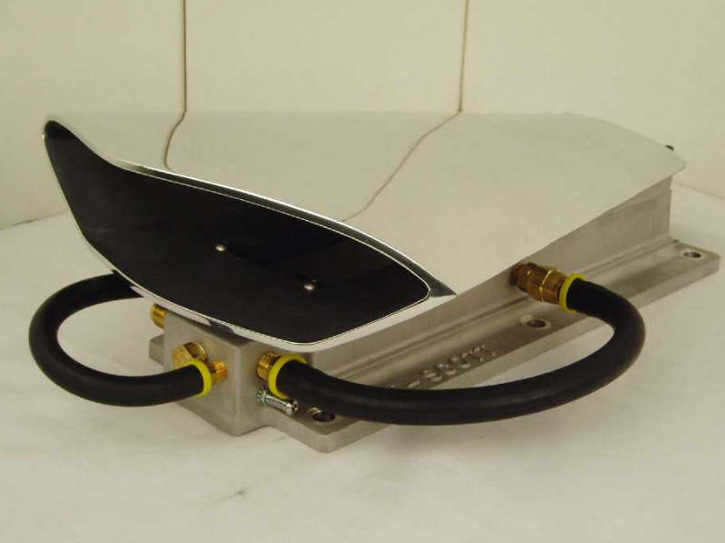

    Scott Slot has a very low profile...
