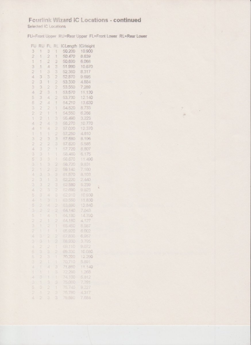

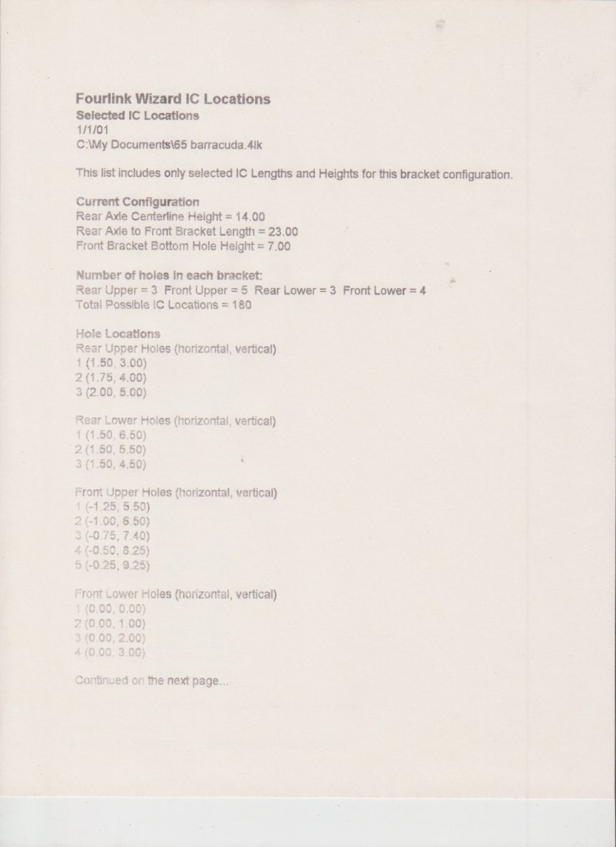

    playing with the 4 link program, of course since it's 20 years old I had to fire up a Windows 98 computer and get a dot matrix printer running. Even the NOS ribbon is tired...but it's legible enough.
    AHotRod, saltflats, racer-x and 5 others like this.
