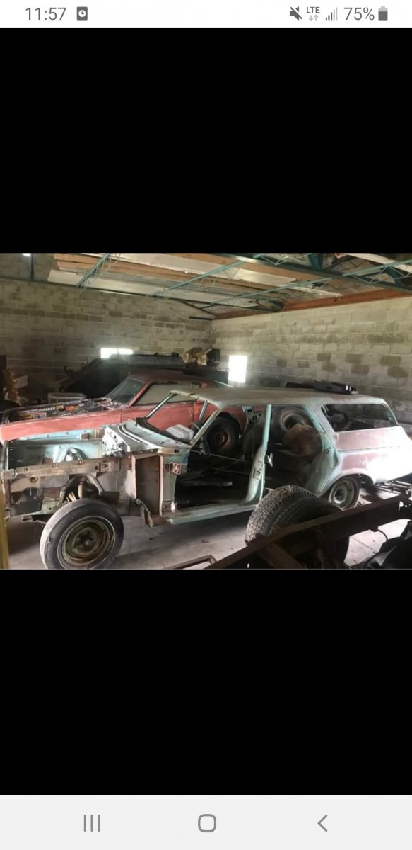

  12. jobbless
    Joined: Oct 11, 2004
    Posts: 303
    jobbless
    Check out what's sitting next to that wagon... not sure if anyone knew about it or not but just spotted the Crazy Cuda..
  13. squirrel
    Joined: Sep 23, 2004
    Posts: 59,928
    squirrel
    where is that?
    kidcampbell71 likes this.
