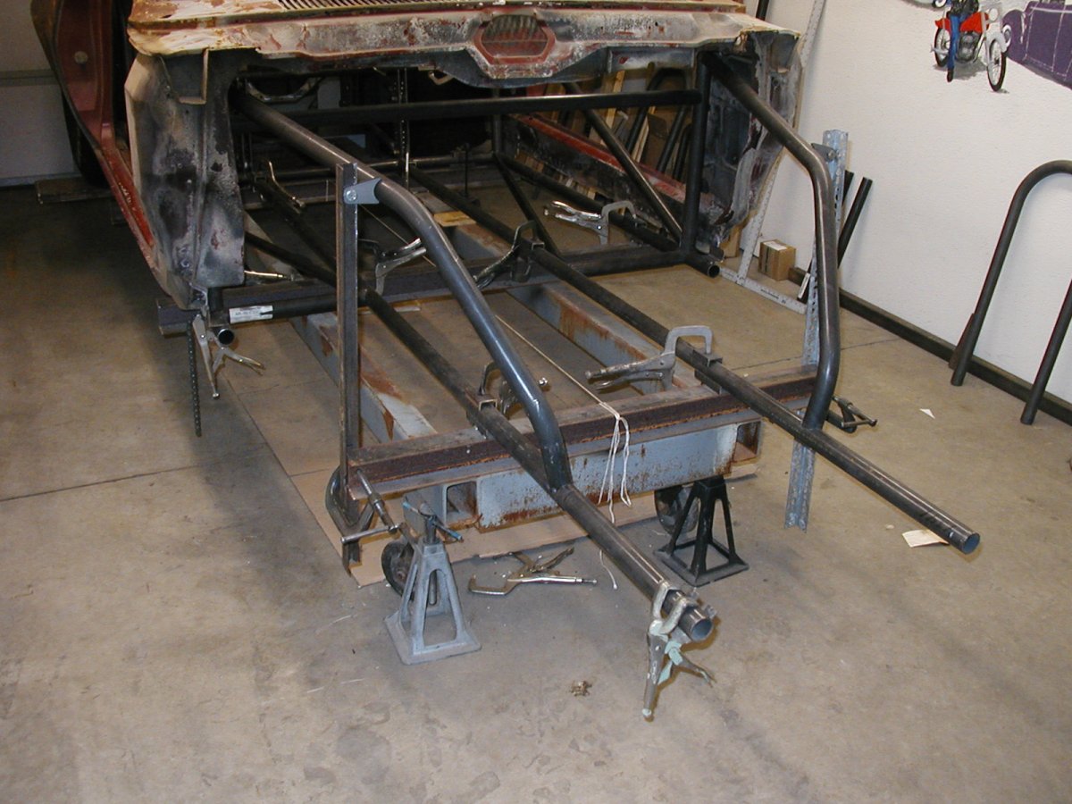

    Combining both quotes to say this. By keeping the whole car together you'll have your actual shape to make your fender mold's by filling the (steel) fender to (steel) door gap/s with something as easy as tape then run your mold over both to get your long fenders going. The hood, well just make two gl*** hoods and add the back half one to the back of the whole hood. Of co**** there will be some additional cuts and tweaks and more gl***ing to be done but as a whole you'll have things well underway.
  10. That's exactly what I did on the AMX. I sold the cast off for 2K without motor or trans. Here's how I made the first cuts with the plazma. Some final t******* left me something to mount Alum panels to.
    Tube chassis 003.jpg Tube chassis 001.jpg The Wizzard
